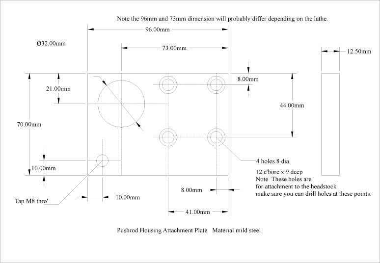

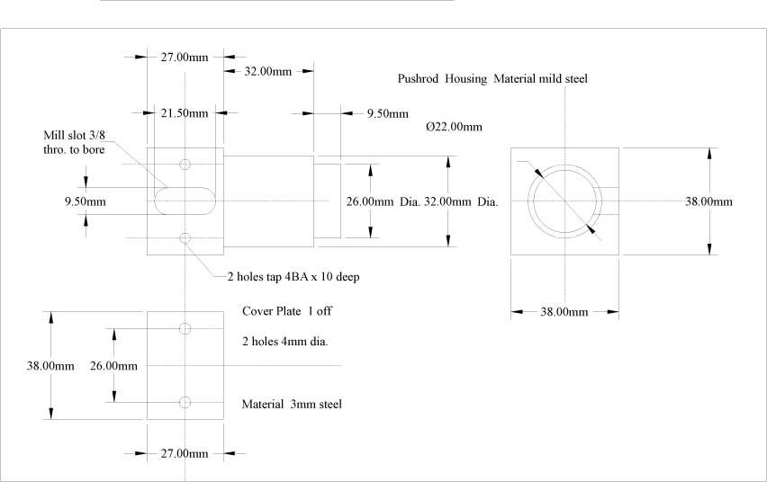

      I have a Harrison M250 and will def. be making this clutch.
      HOWEVER, is it me or are there some drawings missing??
      Page 519 the pushrod housing is supposed to be Fig 8 – but it is the pivot mounting block and there are no dimensions for for the attachment plate.
      Am I missing something??
      Bill

        Diane Carney
          @dianecarney30678
          Bill
          I have sent you an email.
          Diane

            Diane Carney
              @dianecarney30678
              Two missing drawings are here. They will also be printed in M.E. a.s.a.p.
