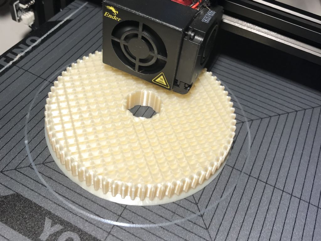

      I chose a NEMA 24 4NM servo motor and driver kit from stepper online, Omron encoder and 3D printed all of the pulleys.

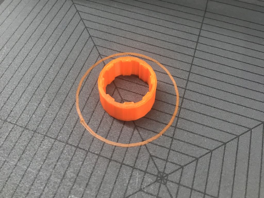

      The pulleys took a bit of trial and error to get right but I think they'll be strong enough. I used a pulley generator on Thingiverse and inserted the Colchester spline centre using Tinkercad. All pulleys printed at 40% infill.
      Colchester spline test
      72T lead screw pulley

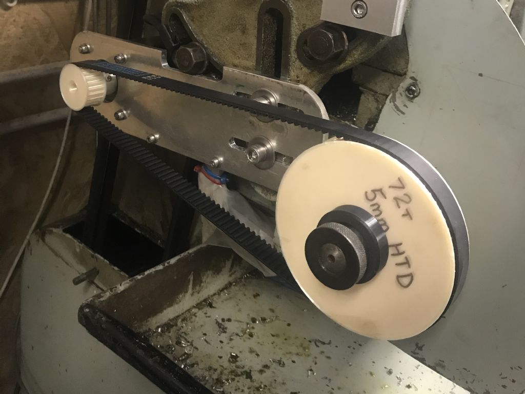

      I chose to drive the encoder 1:1 with 60T GT2 10mm wide pulleys. I am driving the leadscrew with a 3:1 24T – 72T HTD 5mm pitch 15mm wide pulley.

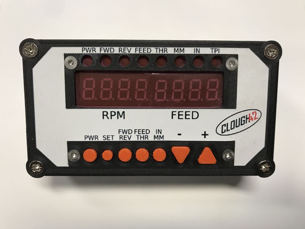

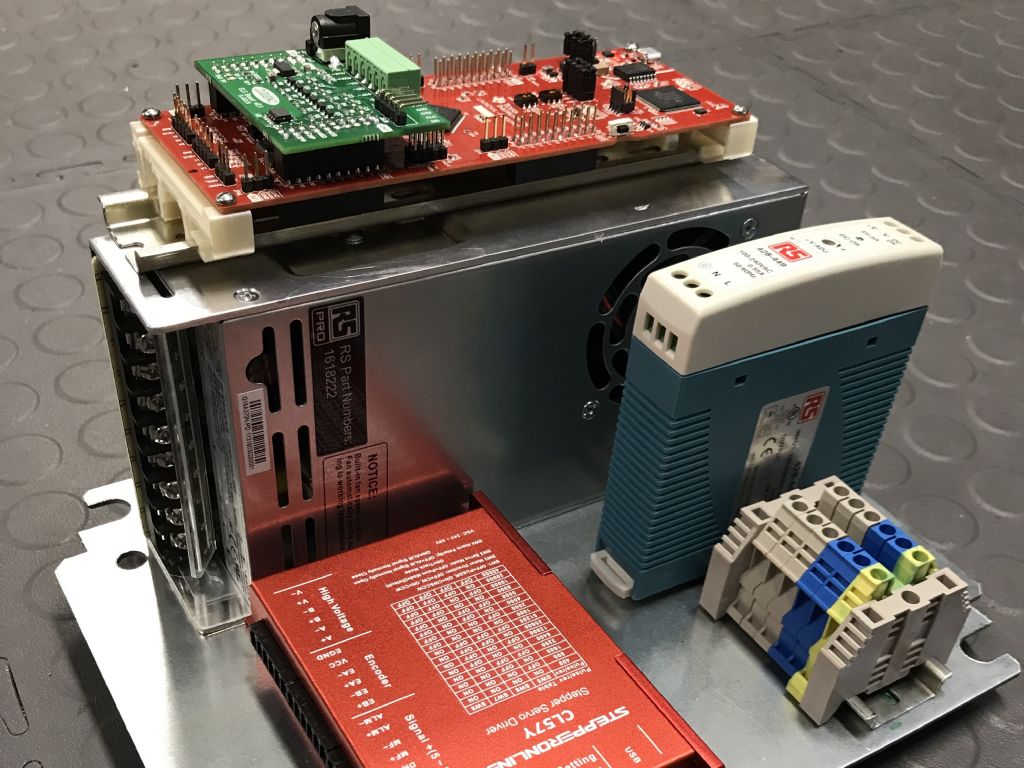

      Clough42 uses a die cast box from Bud industries for the control box. I couldn't find one in the UK (and didn't think to get one from from Mouser US when I placed the order for the LaunchXL) but found that a Hammond one available in the UK has exactly the same dimensions although the corner radiuses are slightly different. I can live with that. I 3D printed the lid and printed the control button information on a laser label.
      Control Box

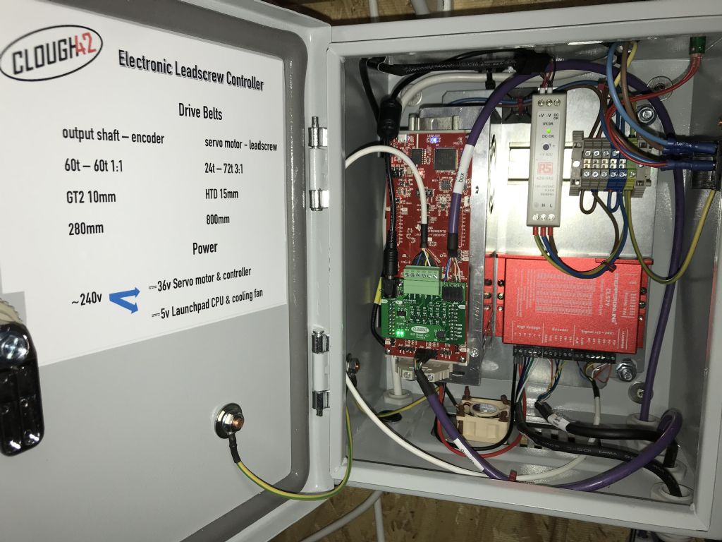

      After much deliberation I went with a 36v switching PSU for the servo motor and got a din mount 5v PSU for the LaunchXL and enclosure fan. Component layout below:
      Power enclosure layout

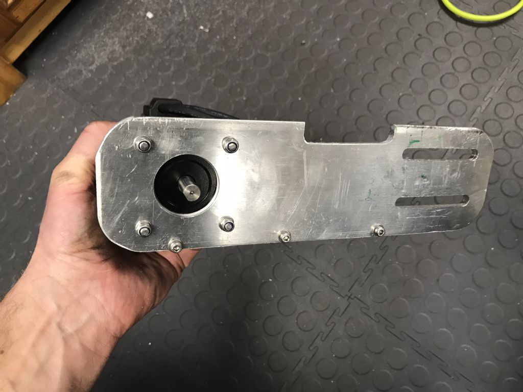

      It took ages to decide on where to place the motor but in the end I placed it between the main drive belts. This meant there was absolutely no modification of the lathe needed. It fits nicely with loads of adjustment available.
      Servo mounting plate
      Leadscrew drive

      Finished power box below. I thought the box was going to be overkill size wise but I'm glad I left some breathing space!
      Power box

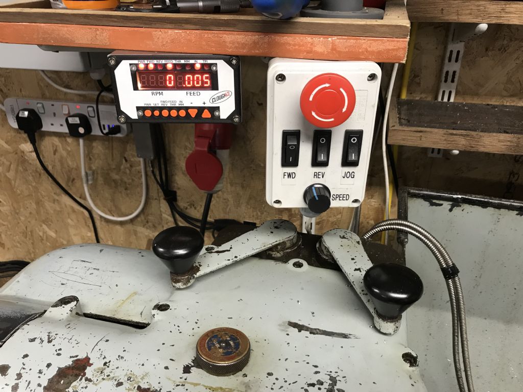

      Control box sits nicely next to the vid control
      Control box
