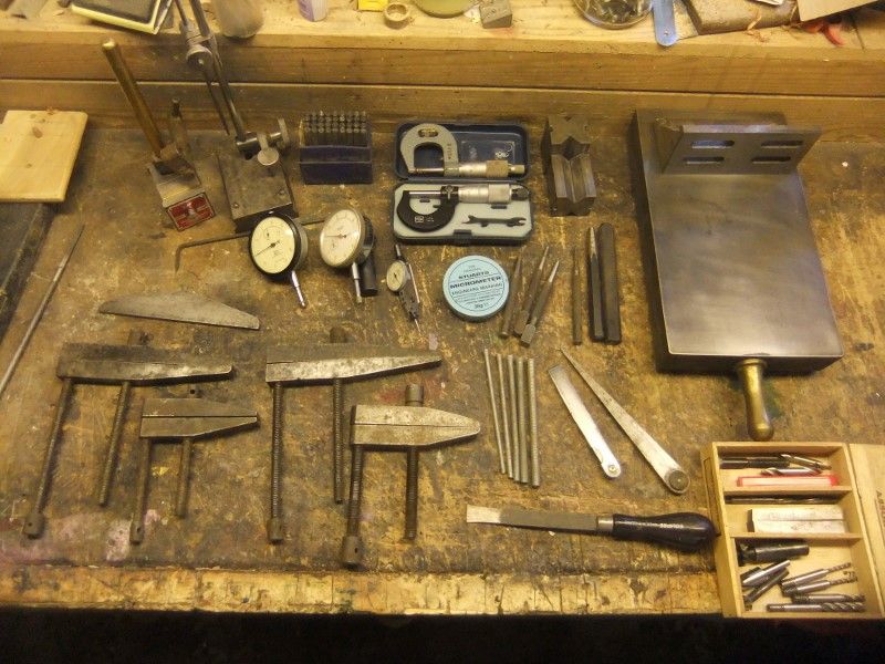

                    Like yourself I have yet to buy my equipment but in the mean time I have spent ( in between woodturning and woodwork ) Using any pieces of metal and practice using files. I also have had a go at drilling with my drill press and reaming. I also have some silver solder which is of unknown grade that I have been getting the feel of joining pieces of metal including brass.
                    I know it would be nice to have a go at something and see an end result but I would like to be able to at least mess up odd bits than on a nice casting from a kit.
                    I am also collecting various odd tools as well
                    I have made a straight edge which is both straight and level as well as being at right angles but then I have a small surface plate and a proper right angle mounting plate ( sorry not sure what the correct name is).

                          Tooling, for which you are not sure of the correct name, can often be matched/identified on tool supplier’s lists. The ‘quick index’ on the Arceurotrade website would be a particularly good resource to find the common names of many unknown bits and pieces.
                          Angle plate describes that one. Most angle plates have right angles unless specialised – and even then they will likely be described as ‘adjustable’.

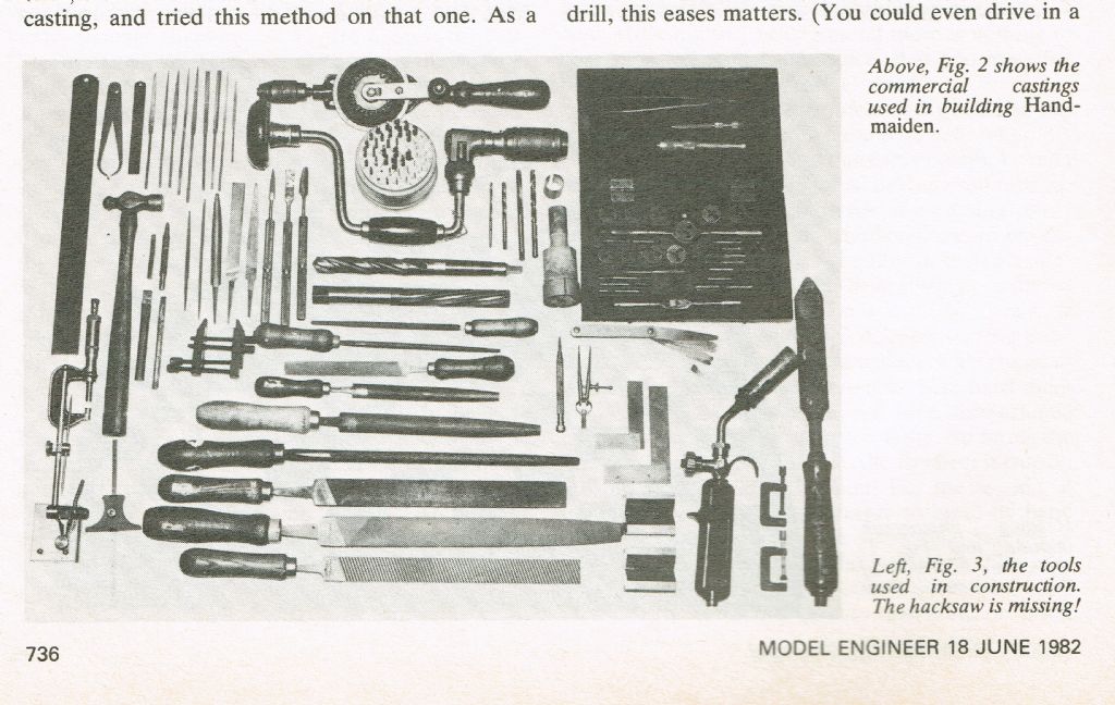

                            As I said earlier Tom Walshaw (Tubal Cain) made a slightly modified Stuart 10H with just hand tools.
                            This photo shows the tools used, there was also a hacksaw involved but it was left out of the photo.
                            The brace and bit was used to drill out the cored hole in the cylinder which was then reamed and all other featured set out from this bore.

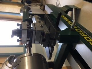

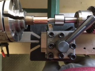

                              Thanks everyone for your advice and help. I have adapted my woodturning lathe to turn some boiler bushes for a small pot boiler I intend to make. Research has come from Tubal Cain and Stan Bray books. I had a small plate in my drawer and put it on the tool post frame. I then bought a small cross slide with tool post and attached this to the plate. I have managed to turn two small phozphor bronze bushes for the boiler shell. It’s slow work but with fine cuts I am pleased with the results. I am now wondering how far I can go with this system. See photos.

                                geoff walker 1
                                  @geoffwalker1
                                  Looks good to me Gary.
                                  I like your approach, nothing wrong with adapting current equipment to meet an immediate need.
                                  The problem is that it is very time consuming.
                                  Sooner or later you may feel the need "to get on with things" and will need then need to expand your workshop equipment.
                                  Geoff
