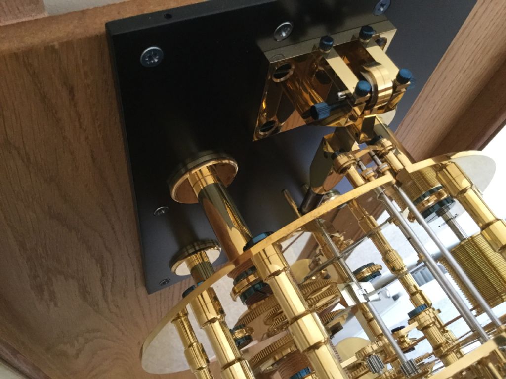

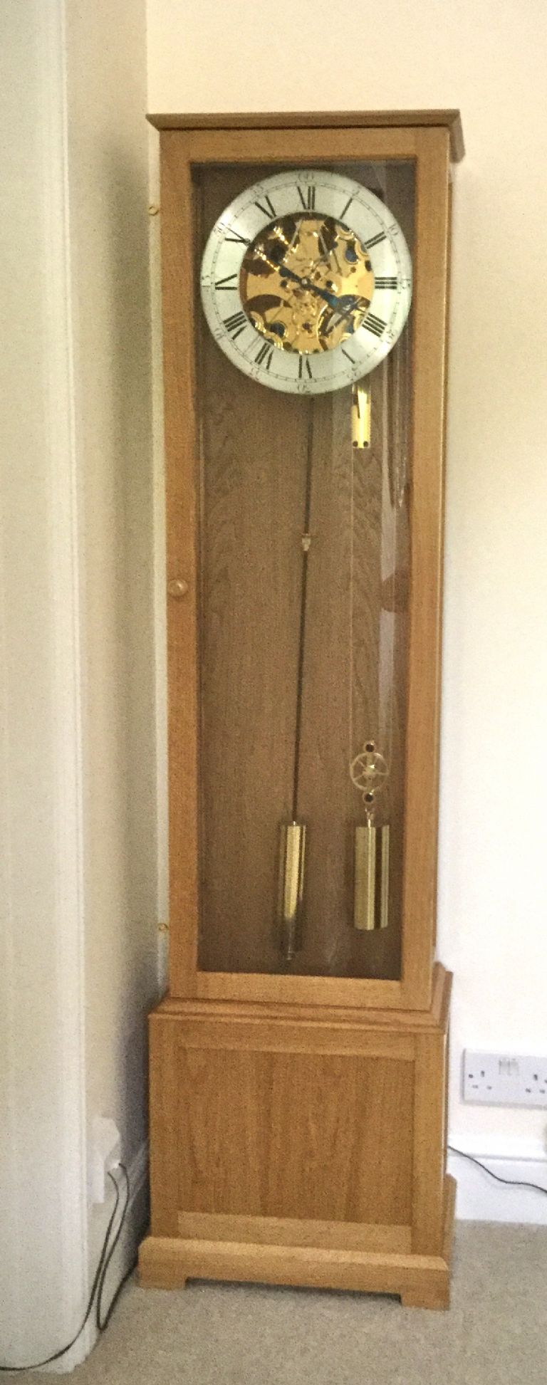

      Just completed my version of the Claude Reeves gravity escapement regulator. My main spare time project for the last 3 years, ( plus 6 months for the oak case).
      The build was based on John Wilding’s book. However I used miniature ball races throughout, which reduced friction to the extent that the clock will run on 10lb driving weight compared to 14 lb for Wilding’s version. I also used carbon fibre for the pendulum rod.
      I have to thank several people on this and the mlhorology forum for their help and advice. In particular Peter Bell, who sold me his spare set of water-jet cut plates, and gave much advice, Rex Swensen for guidance on the use of miniature bearings and other topics, and Joel Shugar and David Gee, both of whom had successfully built this interesting clock and freely gave their advice.
      A couple of pictures are attached.

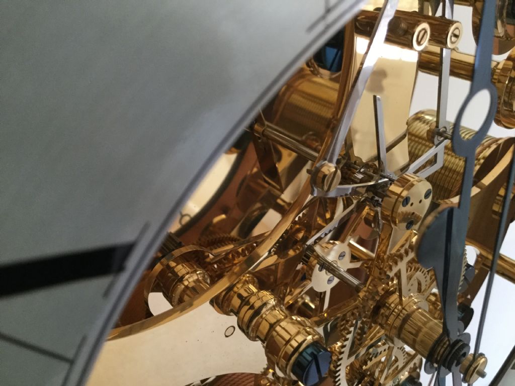

                  I'd like to see photos of the escapement if possible

                          Congratulations on a very fine clock. I shall look forwards to your results once you have been running for a month or two. Is the movement/pendulum attached to the wall or to the case?
                          regards Martin
                          #495823
                          Mike Crossfield
                            @mikecrossfield92481
                            Thank you Martin.
                            There is a substantial metal backplate fitted to the case, and the pendulum and the movement are separately attached to this. I’ll post some more photos which should make this clear. The case is anchored to the wall behind it.

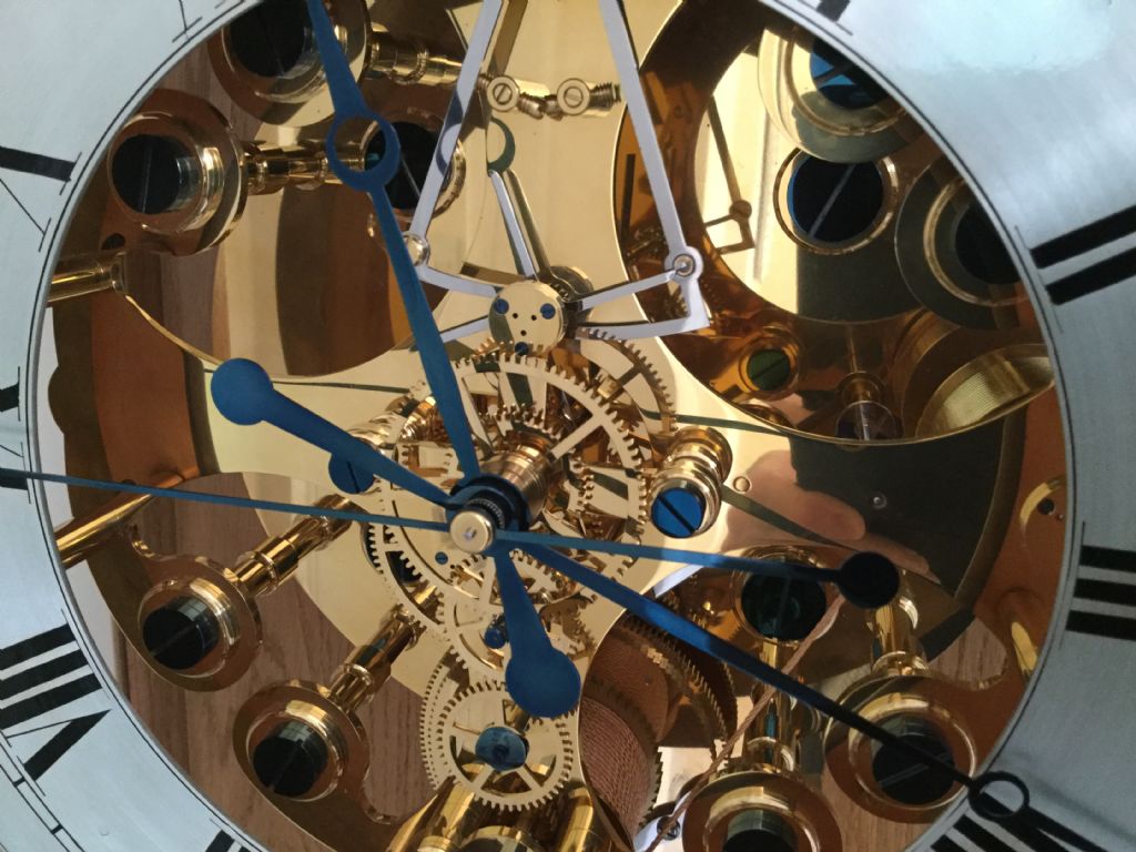

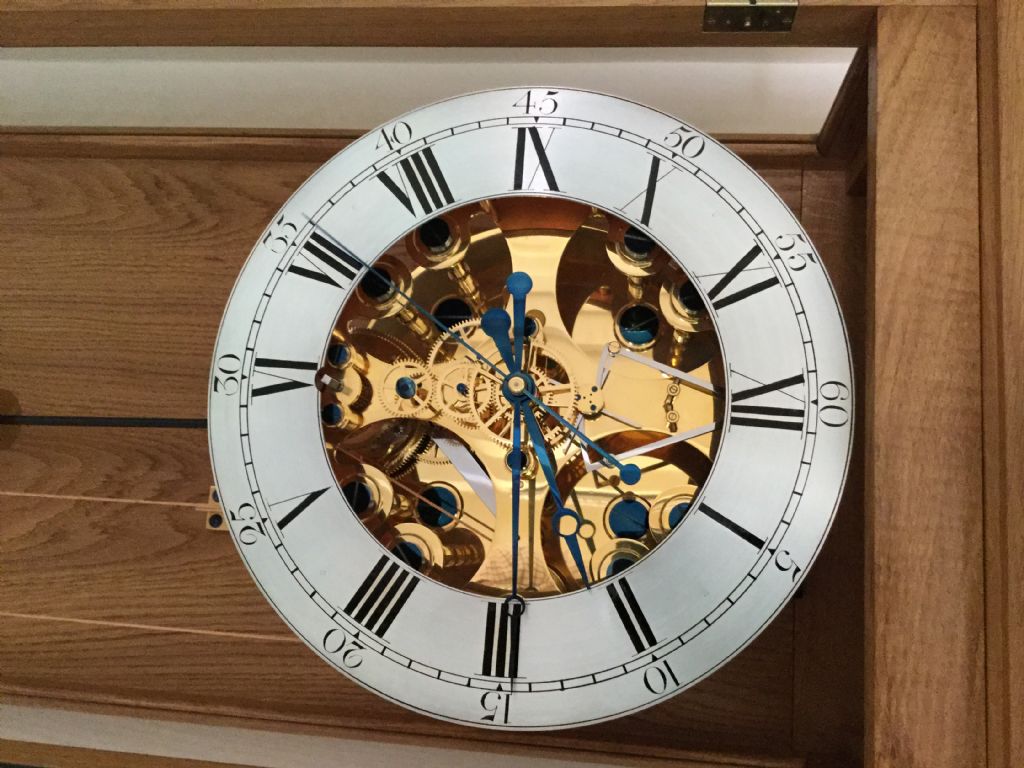

                            Marcus Bowman
                              @marcusbowman28936
                              A handsome job.
                              I must say I find your last photo, showing the blue hands against the polished brass very attractive indeed.
                              The case turned out well too.

                                  Since a few people have asked for more photos here are 3 more. There are some others in my album. I have also made a short video of the escapement. If I’ve done it correctly the link is
                                  Mike
