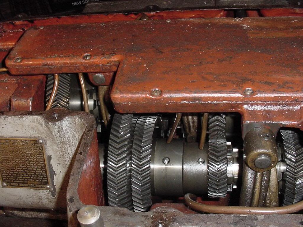

      There's me thinking for years the double arrow heads were representing hydraulic lift suspension… blush
      So ,they're double helical gear teeth actually ! Every day's a school day..
      How are they cut then ? I can see pics on the internet , of gears with a gap in the middle,so a cutting tool could run into the gap. and ones with a radius in the base of the V could be end milled ? . These ones appear sharp in the V though…copy of herringbone_gears_in_headstock.jpg

        #300768
        Nathan Sharpe
          @nathansharpe19746
          My best try is a two part rim/tyre construction pinned together and also fairly flimsy when looking at a collapsed tooth on the third gear from the left (foreground cluster) above centre line. Nathan.

          Jeff Dayman
            @jeffdayman43397
            A shaper could make those Citroen gears easily, with a good operator. I'd be surprised if Mr Citroen did not build their own special shaping machines for making them.

              #300784
              clogs
                @clogs
                Hi all,
                I beleive that Mr Citroen was in engineering before making car's………

                #300786
                Hacksaw
                  @hacksaw
                  Doh… how did i miss that thread ? blush
                  Its a headstock i believe
                  #300981
                  Phil Whitley
                    @philwhitley94135
                    I believe Monsieur Citroen actualy bought the patent for the herringbone gears from an impoverished Polish engineer. They were often used in mine winding equipment because the gears were self centering, and could not come out of mesh.
