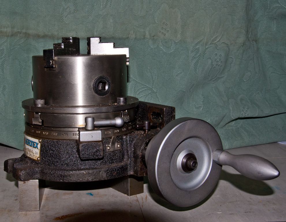

        Good Evening gents.
        I would like to attach a standard 3 jaw myford chuck to a rotary table.
        Here is the rotary table
        Rotary table
        with the screw removed
        I know I need some sort of adapter , – but which ?.

            The usual culprits – Chronos, RDG, Arc-Euro (?) have a Myford chuck adaptor for rotary tables that have an MT2 centre. Possibly you could modify one of those. It has the hard part done with the nose and thread.

              As the Myford has a screwed nose, one method is to make an adapter that replicates this. The advantage of this is that it easily maintains concentricity between lathe and rotary table. However, if for example an hexagon for a spanner is being machined on the outer diameter the rotation of the cutter will be attempting to unscrew the chuck from the adapter. The result can easily be a spoilt workpiece and or a broken cutter.
              The alternative is a plate mounted on the rear of the chuck using the chucks back plate fixings. Of course, concentricity between lathe and rotary table becomes much more difficult to achieve.

                    If you can send for the Myford nose adaptor blank from myford.co.uk all you need to do is mount that adaptor between centre (nose thread's pointing towards each other) and turn a spigot to fit table centre bore, then a groove say 5mm wide by 5mm deep. Make a couple of clamps or use a couple of faceplate clamps located in the groove and bolted down in the rotary table tee slots. Clock adaptor up under milling spindle to be true. Screw lathe chuck on, job done.

                        My rotary table has a N0.2 MT hole at the centre and I have a No2 MT – Myford nose piece adaptor, (available from Myford/RDG . ) I bought this years ago but have never used it! I bought a large chuck just a bit smaller than my rotary table, made a backplate with holes to fit the "T" slots, and find that suits just fine for all occasions I have encountered so far!

                              Cheers Guys for all the helpful suggestions.
                              I am reasonably please with an adapter from RDG. Have machined a register in the bottom. (KIS).
                              can clamp it with T studs. Its mainly for the drill press.
