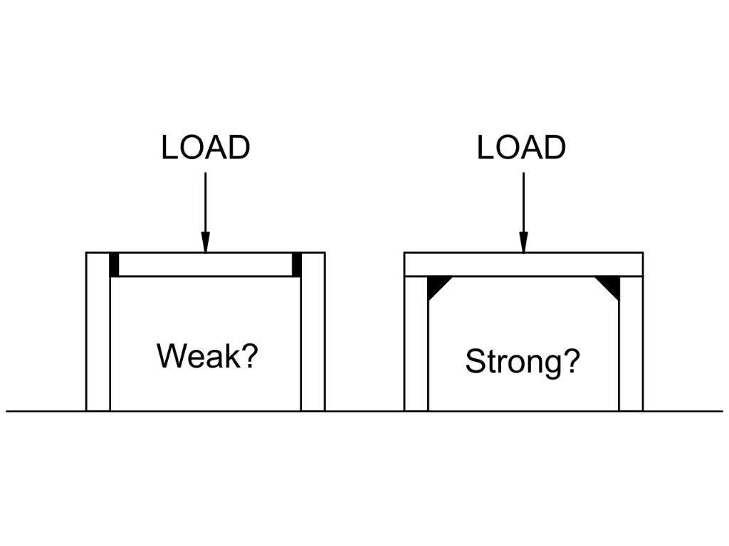

      I have just had a closer read of an article appearing in Model Engineer's Workshop 264 (February 2018) by Stan Nesbitt on construction of a chain hoist tripod. The design has many advantages I think, in its use of readily available and low-cost parts, its portability and its simplicity. I like it, and intend to make one.
      The only thing is, it is a lifting device — and yet no load rating was declared for the tripod itself (though the load limit of the recommended retail chain hoist block is noted). I am surprised that details on its fabrication were published without that information – surely standards apply to lifting devices in the UK as they do in this part of the world, and publication would seem to be an implied endorsement of the tripod's fitness for purpose. No mention either of limits to usage on slopes or such like. Is MEW not a little circumspect when it comes to liability? Or do you not have a thriving industry of personal injury lawyers like over here (Australia), ready to make the most of anyone connected to a mishap?
      Well, anyway, MEW's refreshing boldness aside, could anyone venture a load rating on the tripod as shown in the article?
      And secondly, the photos show use in soft ground where the legs presumably dig in to prevent splaying. What would be the situation if used on hard smooth ground such as concrete? Are we sure that under maximum load (whatever that might be), there is no tendency for the feet to slide out and splay? I guess not, but I'm no expert.

                Hi Ian, as far as I'm aware, their is no legislation for any lifting equipment made for ones own personal use. If anyone borrows such equipment, that may be a different question. As George says, chains can be used on the lower parts of the tubes to stop splaying out and would certainly be a good addition. However, to make something for lifting that has the potential to sink into soft ground is a bad idea and would not pass any safety tests for a work environment. Personally I have reservations about the "Adapter Plate" where the tubes are relying just on the welds, these tubes in my opinion, should have gussets added, which would prevent any tendency of the plate itself from bending at the welded area. The gussets could be as simple as three flat bars the depth of the tubes, each bar then welded between two of the tubes and along the edge of the adapter plate. I would also obtain a commercially made lifting eye bolt, and shackle if need be, rather than using a U bolt or a bent up bar.
                Lifting accidents in industry have been numerus in days gone by, due to poor design and/or faulty equipment and legislation is very strict about testing and maintenance of such equipment here in the UK.
                Regards Nick.
                    You've expressed something that was in the back of my mind about the 'adapter plate' — that the weld-ons didn't look the full business, especially the hook-eye in the centre which would be under considerable tension and high dynamic loads if anything was swinging or especially if the load suddenly slipped. Yes, a commercial solution there, although I'm still trying to visualise exactly what, would be better than the weedy U-bolt weld-on. And good point about gussets on the pole sockets, just right.
                    The quality of the welds is beyond MEW's control, but given the history of industrial accidents with lifting equipment, hence the web of design standards, workplace legislation and case law around them, the design ought to have been given a stated rating as part and parcel of publication — it's the act of publication that raises the level of due diligence. Other than the lawyer's picnic if the design/author/publisher can be upheld as a contributor to injury, its all about safety first.

                                        For what is's worth, Stan uses 3 Kwikstage standards for his tripod. In normal use, they would be vertical, and an accurate calculation would have to take that into account. However, depending on height and configuration when used as scaffolding, Kwikstage rate the standards at either 18kN or 25kN. (Likely this allows a safety factor of 6.)
                                        Say the standards are only good for 10kN angled over in Stan's tripod (an under-estimate for sure). They would take a combined load of 30kN safely, which is about 3 tons, well above the 1000kg limit of the chain-hoist. Looks good to me.
                                        I've no experience of welding, but would the adapter plate be stronger if the triangle rested on top of the tubes, rather than being welded to their sides? If the plate were welded in position resting on top, the welds wouldn't have to take the full load as they do at the moment.

                                          In theory, the weld should be as strong as the parent metal. In practice in the home workshop, your second example looks like a good idea. It's the way I would do it, being familiar with my own welding skills!

                                              Thanks Dave, that's the kind of rough estimate I was looking for to see if this design would suit loads to my probable limit of about 500kg, and it would seem that it would do, other factors being acceptable.
                                              The ideas for reconfiguring the plate are welcome. Not being a professional welder I can't assume that my welds are good enough to guarantee safety in all circumstances, so looking for redundancies or natural advantages as in your diagram B, rather than skimpy theoretical minimalism relying on weld strength alone as in A, is a better option for me.

                                                      In this case, I will be publishing advice on how to make the design stronger (fillets and nuts as well as weld on the U-bolt).
