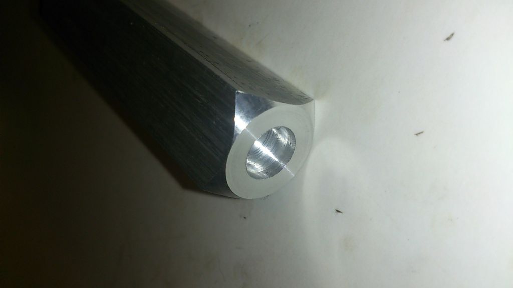

        Posted by Clive Foster on 23/10/2017 09:57:49:
        Robin
        Let us know how you get on. Maybe write it up for Neil. I centre square stock up about once every third blue moon so never really sorted the best method out. As my Dickson is always set square to the bed I just use an empty toolholder. Front of the back is vertical for all practical purposes and the jaw usually slips into the slot space.
        Well, after the belated realisation that I could perhaps use the cross slide DRO rather than faffing with a dial indicator (compartmentalised thinking!) I tried few things, ranging from just butting the toolpost up to the bar to making a sort of toolpost held squaring thing. I can get the 3/4" bar centered to within a couple of thou his way, which is more than good enough for the job in hand, and lot quicker than using the dial indicator. All I need at the mo is someting that doesn't look cockeyed, it's a simple but repetitive thing, but I've got a bee in my bonnet about centering square stock now!
