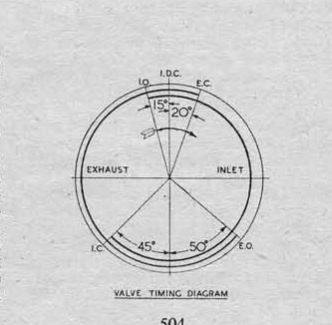

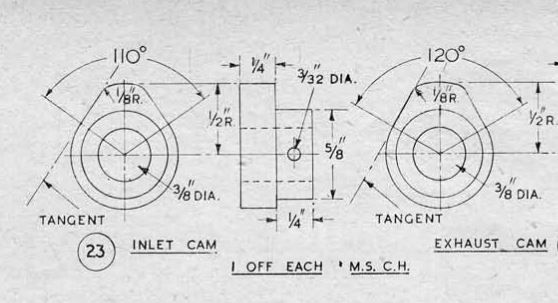

      I'm in the process of setting up the valve gear of my Centaur gas engine. Having made the cams to drawing, I can't achieve the specified valve timings. Both valves have opening periods that are too short.The drawings are shown below.cams.jpgvalve timing.jpg
      The inlet and exhaust cams lift over 220deg and 240deg. resp. and slightly less if tappet clearance is present The timing diagram calls for 240deg. and 250deg.Which is correct, does it matter much or have I got this wrong? Since ETW was a very respected designer and the Centaur is a long established design I'm surprised to find this apparent discrepancy. Comments would be appreciated.

          He does mention in the notes that if you set the opening points exactly to the drawing you will find the valve close a little early.
          **LINK**
          Page 504.

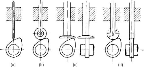

            I think you may find the discrepancy is down to the profile of the cam follower. If it were a small diameter roller, it would follow the cam profile fairly closely. But with the Centaur's flat profile cam followers, the edge of the flat camfollower contacts the ramp of the cam before said ramp hits the centreline between cam spindle and cam follower. Likewise, the cam follower does not fully close until the trailing ramp has moved past the other edge of the cam follower. Hence the actual valve opening duration is slightly longer than the cam iteself would suggest.
            If the cam follower is halfway in between and a flat follower but with a bit of a radius on it, the result will be halfway in between. On some old motorbikes with radiused "flat" followers, a performance upgrade was to fit followers with a larger radius or even flat, in order to both advance the valve timing and increase the duration of opening time. Even a full sized roller follower will extend timing duration beyond the simple profile of the cam to some degree.
            Best way to check it is put a large degree wheel on the finished engine and a dial indicator on the pushrod and dial it in exactly.
            PS Looking at pics of the Centaur, it looks like it has in fact large diameter roller followers, which would add to the timing duration to some extent.
            Phil Irving (designer of the Vincent motorbike) goes into this stuff in some depth in his book "Tuning for Speed" and how to map out valve lift with a roller tappet. It is not a plain matter of cam lift equals valve lift. Quite complex to map it all out, by drawing a roller moving around the profile of the cam in one degree intervals, then plotting the path of the centre point of all those circles. It does add degrees to the valve opening duration.

              You can see how different cam follower shapes affect actual valve timing, vis a vis cam profile.
              in (a), a perfect point follower (never used in practice due to wear) follows the cam's timing exactly.
              But in (b) with a roller follower, the follower has already started to open the valve, even though the ramp is not yet in line with the centre line. The cam is in the same position as in a, but the roller is contacting way up towards the point of the cam lobe.
              In (c) with a flat tappet, the effect is more exaggerated. The cam is in the same postiion as in a and b, but the follower is riding on the very point of the cam already, well and truly open. The contact point is a way over to the right of the centreline of the camshaft, not in line with it as the pointer follower in a was.
              That effect would give you your extra 20 to 40 degrees of valve opening duration between the gain on opening and the mirror effect on closing.
              So if you took out your roller tappets and put in flat tappets, you would get earlier opening, later closing, plus faster opening and more time with the valve close to fully open, but the same lift. Cheap bolt in horsepower. Probably not somthing you want to do on a model stationary engine! But vintage motorbike guys were known to do it back in the day.

                              Looking further at your timing diagram in the OP, is is very surprising to see that kind of valve overlap on a low-revving, low-performance stationary engine. According to this chart, your Centaur has more valve overlap than ETW's Kiwi engine, which has 10 degrees inlet lead and 20 degrees exhaust lag vs your Centaur chart showing 15 and 20 respectively. That's according to the Kiwi drawings I have sitting under the bench awaiting the day castings become affordable.
                              This overlap is surprising on the slow revving Centaur because the Kiwi was a high-performance, high revving engine developed on a dynamometer with Prof Chaddock to power racing model boats at full tilt. So it seems possible that ETW's drawing of the Centaur cams is correct but his timing chart is out, perhaps confused with one from a higher performance engine?
                              So you might try sticking with your existing cams but repositioning them so the intake opens later and the exhaust closes earlier, pretty much eliminating the overlap when they are both open, and both valves sticking to the timing diagram at the other end of their duration, ie intake closes 45 deg after BDC and exhaust opens 50 deg before BDC.
                              Plenty of low-revving low-performance engines (including some Harley Davidsons of the 1990s even!) run with little or no overlap, or even negative overlap where the exhaust valve closes a few degrees before the intake opens (1990s Harleys to meet emission standards) so your Centaur should run with that sort of valve timing.
                              Lack of valve timing overlap should also give you increased effective compression, which can only help too. Valve overlap really depends on a long exhaust pipe to provide the extraction effect for exhaust gasses, then a tuned length pipe so a reversion pulse wave pushes any excess intake charge back into the cylinder from the exhaust port just before the valve closes. You are not going to get any of this stuff going on at low revs and with the Centaur's stubby exhaust pipe. So I am really suspicious of that timing diagram with all that overlap in it.
                              ON the other hand, many dozens or hundreds of these engines have been built in the 65 years since its inception and there seems to be no mention of them not running with the standard cam set up. So maybe the problem is elsewhere?

                                                  Is there the same discrepancy between the duration of the cam drawing and the timing chart on the Wyvern drawings?

                                                    Interestingly, on Julius De Waal's drawings for Wyvern, the only ones I can find on the net, there is a note on the camshaft drawing saying "Angle X to be determined by experimentation". Angle X is shown as the angle between the two cam lobes, which would determine overlap. So obviously there is some history of trial and error in setting the cam timing/overlap on these ETW models.
                                                    No cam timing chart on Julius's drawings though, so still wondering if ETW's originals had a similar discrepancy between the cam drawing and the timing chart to Centaur's.
