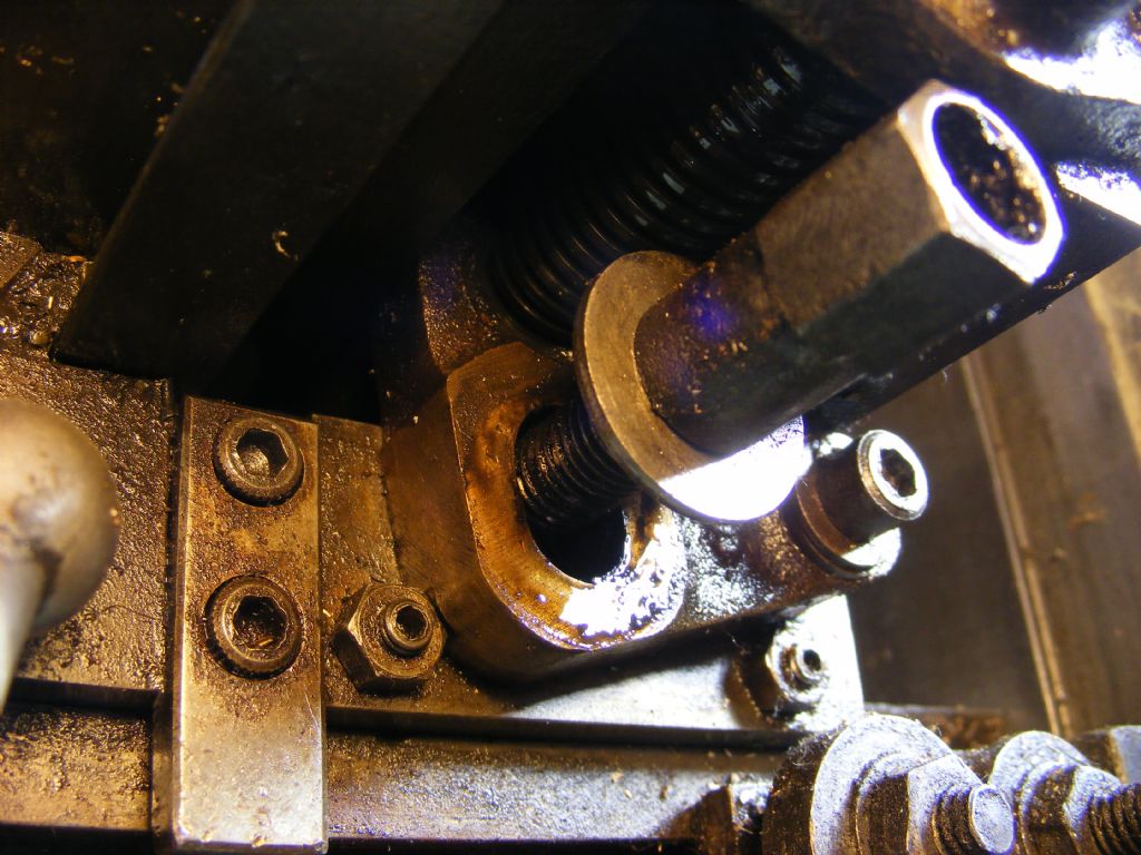

      How do you adjust the backlash on the Centec 2A, I think its the X axis (east-west).
      I can see a bronze collar that the lead screw runs in and a bronze coloured nut that stands proud which is very tight, I dont want to force it

          OK I understand now that its a half nut and there should be a lever to disconnect it when using the lever to move the bed.
          Its no longer lever operated.
          Having adjusted the half nut as tight as possible there is less backlash but still around 15 out of 100 on the graduated dial.
          I dont have any screw cutting facilities to make a new one so will need to find one.
          Any ideas anyone on where to get one please

                  I’m not sure how it would mount Bryan.
                  Looking at the photo below thats the entire nut, there isnt a top half as its pushed up against the leadscrew, so I cant see how it would insert.
                  The only ways I can see it working is if I made a new carrier for it or filed out the existing one, which leaves me with no way back

                        If you’ve got a unit which has seen a fair few years of use then you may well find it impossible to have a zero backlash situation without renewing the leadscrew itself.
                        I can adjust an old lathe I have with “zero backlash nuts” but the leadscrew nut gets pretty tight at each end because there’s always more wear in the middle of an older leadscrew.
                        It’s only a few hundredths of a millimeter but it’s there, and it’s easy to notice on a decent bit of kit, the nut jams up at each end.
                        Worth bearing in mind before you make a big effort, a perfect nut will not fix an imperfect leadscrew.
                        I’ve had zero backlash before on a renewed cross slide nut and it doesn’t last long in regular use before it needs readjusted, a month or two max.
                        It can be readjusted to bear on one surface but a heavy cut in the wrong direction will expose any slop in the mating of the nut/screw until the surfaces rebear on one another.
                        So if you’re really serious about achieving zero backlash on a regular basis, get a new leadscrew and two new adjustable nuts.
                        This means the leadscrew thread can bear fully on one nut in one direction, and bears fully on it’s counterpart nut when it travels in the opposite direction.
                        It goes without saying that you will need a perfect leadscrew to achieve this nirvana over the full length of travel.

                            The Y axis has 20 thou backlash in the middle and 8 thou at each end, where its also tight.
                            The Y axis nut is bronze and could be replaced using the delron method but its not worth the effort unless the leadscrew is changed at the same time.
                            The X axis is 15 thou consistently along its travel, but there isnt enough space for anything other than a half nut so it needs a authentic half nut replacement. or a new one making, tapping and cutting (in half)
                            Thanks for everyones advice, I’ve decided to leave it as it is, I can cope with the backlash and I know how much it is. It dosnt seem worth spending a small fortune on leadscrews and so on
