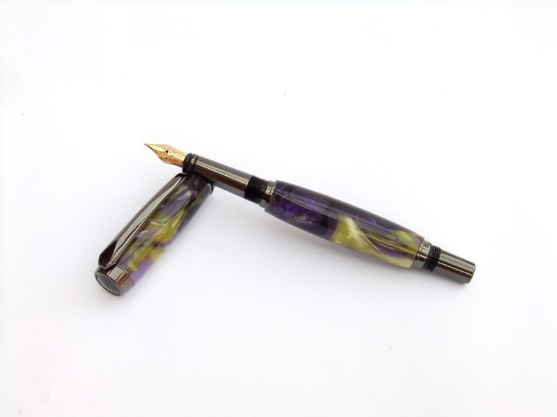

                  This part is more for information rather than what should be used for ABS plastics. I have cast polyester resins to make pens in the past an example in the picture below.
                  As for the use of a vacuum vessel this will remove the air and would need to be left under vacuum until everything it cured. if the material being put into a chamber is fast setting for example this could cause air bubbles to be suspended in the mix if fast setting materials are used a pressure put would be a better option as this will reduce bubble size
