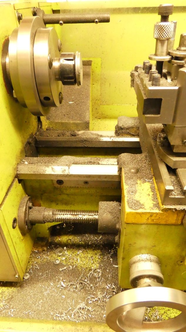

        this was my first time machining cast i knew it was dirty stuff but i didnt know this bad its taken me 3/4 of an hour to clean up its certanly something i will be avoiding in the future blxxdy horrible

              I believe that cast iron dust is the one thing that must be cleaned off a lathe. I was told a story, which I believe, of someone who left a nice pile of cast iron dust on the ways of his lathe because he was lazy. He returned to his slightly damp workshop a couple of weeks later to find the dust was solid and he could not remove it.
              Be warned!

                If I'm doing a big CI job I clamp the hoover pipe so that it picks up the swarf/dust straight from the tool. Cover as much as possible with paper, not rags in case they get caught up, and don't use coolant. I actually like machining cast iron unless it has chill hard spots in it when it becomes a right pain. Brazed tip carbide with a big nose radius can help.

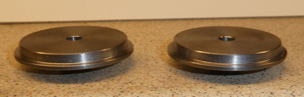

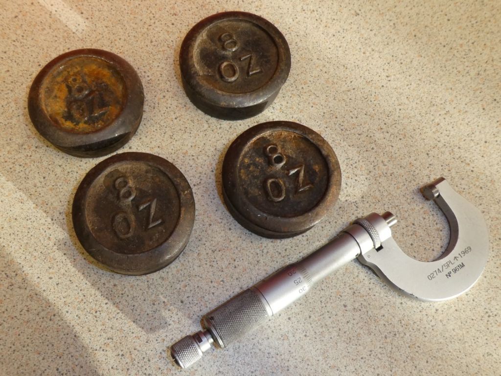

                              Cast iron machining was the order of the day today. Turning the four wheels for my little narrow gauge quarry loco from these four.
                              Lovely to turn with absolutely no hard nuts at all. All four roughed out with two wheels complete and two left to finish.

                              The lathe is filthy (it’ll clean) and my nose is claggy (it’ll blow).

                                Posted by Rik Shaw on 10/12/2016 17:24:05:
                                Nicely done, Rik … Looks good material, and I guess they should be pretty well-balanced.
