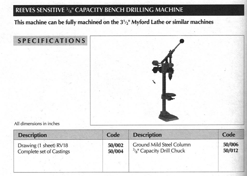

              Hi here is a scan of the one that Clive has linked to and has the same drawing code to the one in DiogenesII's link.

                    Thanks Nick. Some similarity, but mine features a rack and pinion quill feed. In some ways it's almost a larger bench drill in a miniaturized form.

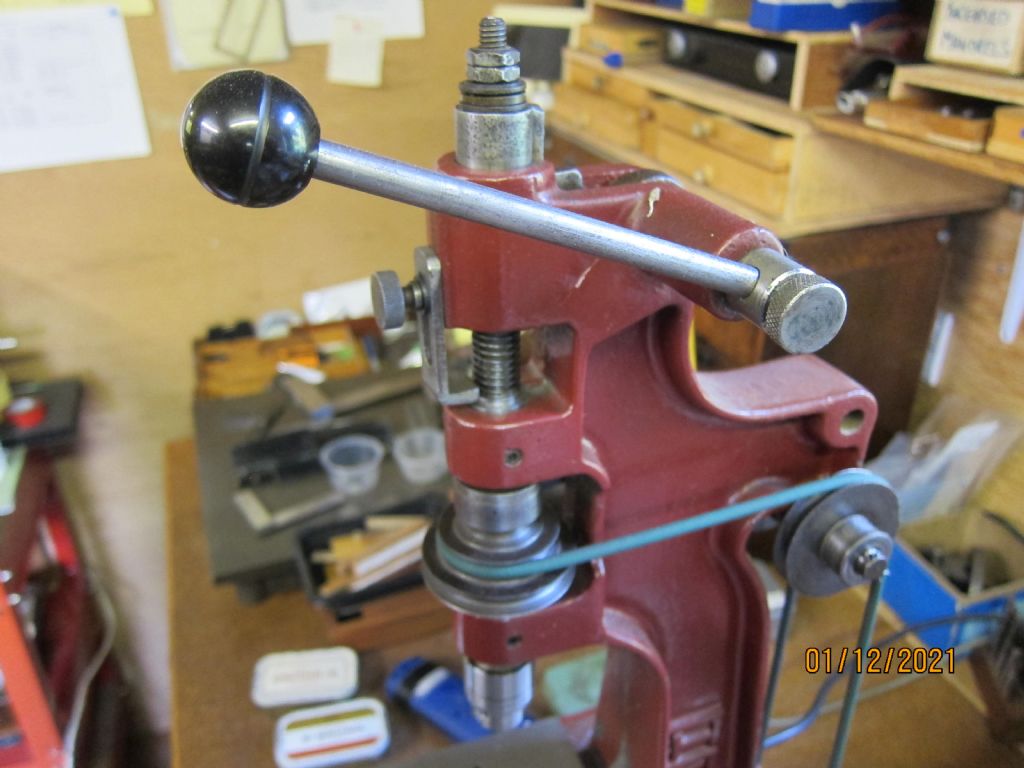

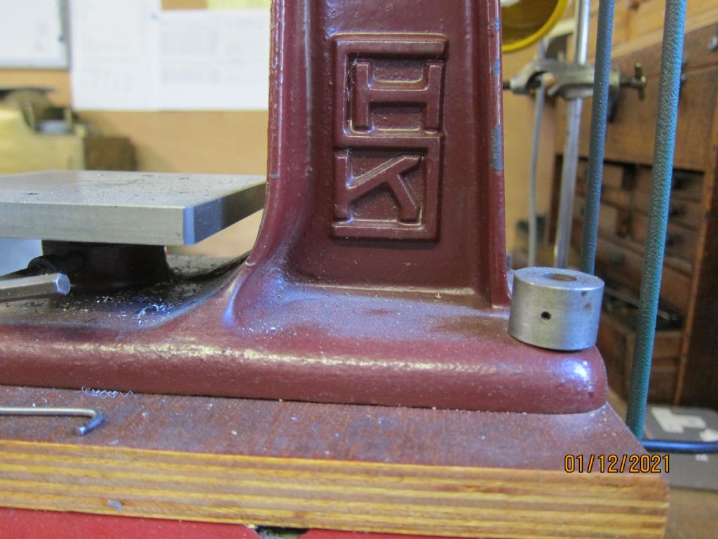

                      Have attached some pics of my vintage sensitive drill press which was picked up at a carboot sale some years ago and has proved to be a very useful addition to the workshop. As in the OM, I have no idea of its origins and have never been able to decipher the makers name from the initials cast into the base. Any suggestions would be most welcomed.

                        A quick Google search found HKS as makers of machine tools.

                          Thanks for that, very useful bit of info. I must confess however that I have never been able to read HKS into the cast panel. You live and learn on this forum.

                            HKS… or SHK? I have just perused lathes.co, looking for names that might match the initials, not just on drilling-machines, without luck!
