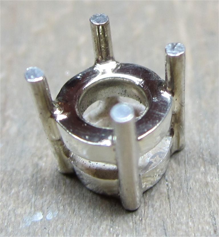

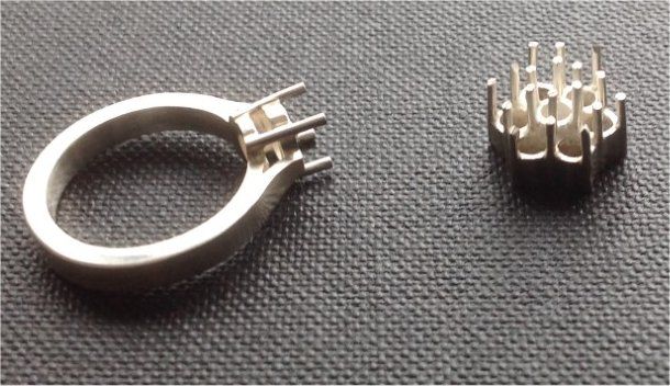

                        Bill Phinn
                          @billphinn90025
                          Posted by Michael Gilligan on 21/01/2020 10:28:23:
                          The most common silver solder melting point divisions are:
                          • IT: The highest melting temperature, used on fine silver when enameling (melting point: 1490 degrees Fahrenheit)
                          • Hard: Used for bezels and as a first step when doing multiple soldering (melting point: 1425 degrees Fahrenheit)
                          • Medium: Used mostly when only one or two steps will be done (melting point: 1390 degrees Fahrenheit)
                          • Easy: Used as a final solder or when soldering on findings (melting point: 1325 degrees F)
                          • Extra Easy: Used primarily for repairs and is distinctly yellow in color- (melting point: 1270 degrees Fahrenheit)
                          [/quote]
                          For jewellery fabrication I use all of those except the enamelling solder.
                          The good thing that many newcomers to jewellery soldering don't realise is that solder can be quite forgiving, and if you're careful and have an appropriate torch/burner you can do multiple successive solder joints even when very close together using a single "hardness" of solder.
                          For example the cluster and collet settings shown in the images were made using twenty-four and ten successive solder joints respectively, and hard solder was used in all cases. The only time I switched to easy solder was to solder the completed collet into the fabricated ring shank.
                          Someone recently asked somewhere why solders come in different thicknesses. I don't know whether this has been answered yet, but my reply would be to say that apart from the obvious fact that different sized workpieces need solder fillets in proportion to their size, and a choice of solder thickness makes achieving this more convenient, there is also the identification issue: fortunately extra easy, easy, medium and hard all have their own specific dimensions, so unless you are careless and pick up the wrong solder you never ruin a fabricated collet, for example, by inadvertently creating it with easy and then trying to join it to your shank with hard. I've said solder can be forgiving, but it's not that forgiving.

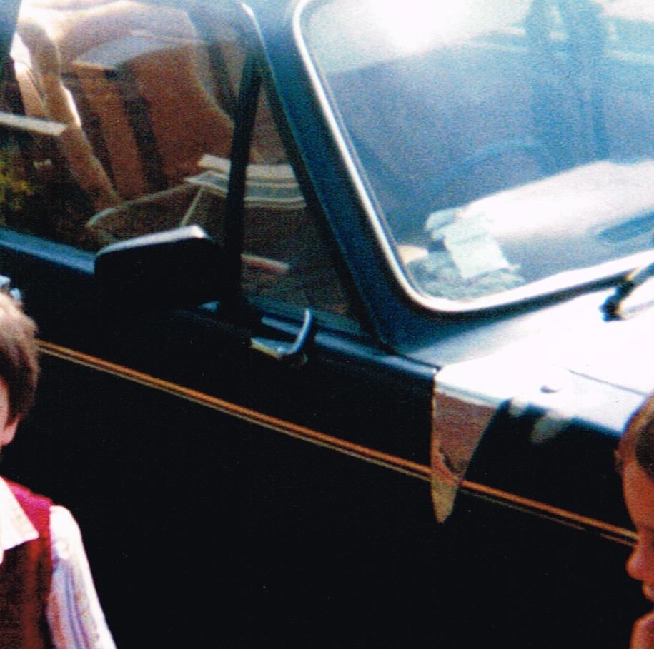

                                              Nicholas Farr
                                                @nicholasfarr14254
                                                Hi, I used glue back in 1987 or there about, to fix four stainless steel patches on the wings of an Avenger to get it through the MOT, although the wings were not in there own right subject to any structural issues, but rusty jagged holes in a position where they would cause additional injury to persons if they were struck by ones car, are.
                                                The photo above shows one of the patches. When I took it for the MOT, the examiner was intrigued by my simple solution to the problem and passed it OK. The next year he told me that Vauxhall were gluing the wings on their new builds.
                                                Maybe this could be low temperature brazing, as there is a small temperature rise during the curing of the glue I used. dont know
