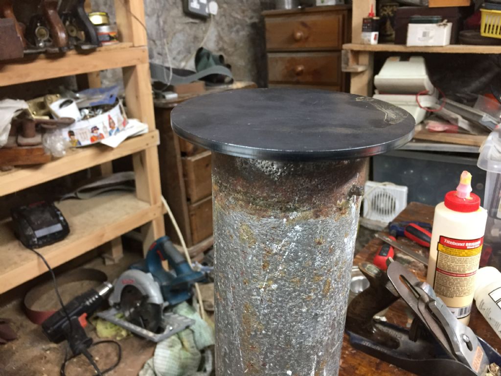

      I was asked by a ceramicist friend if I could machine an external flange from 6mm steel plate to fit his clay extruder:
      The idea is to bore out the plate to slip over the tube and fix it in place. Welding is the obvious way, but I have only a stick welder and little skill with it – I worry that I would blow through the ~2mm tube trying to weld 2mm to 6mm.
      I suggested silver solder, and after having quickly got past the usual 'Him:but will silver solder be strong enough? Me: yes.' conversation I came across the specs for Loctite 638.
      Henkel give a tensile shear strength of >25N/mm^2 for a joint up to 0.25mm. The tube is about 100mm external diameter, Pi is 3, the plate is nominally 6mm, so that's roughly 1800 mm^2 surface area. If I've got the arithmetic right the joint should fail at somewhere around 1800 x 25 = 45,000 Newtons, or about 4.5 tonnes force.
      Can this be right? I doubt that the arm-powered force on the piston which drives the clay can be much more than 5,000 N which would give quite a good safety margin.
      It seems crazy that glue can be that strong , but maybe?

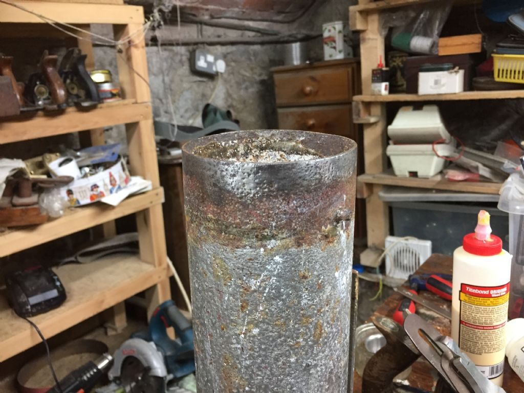

          Looking at the ammount of pitting corrosion on the tube Loctite is not the answer.
          Machine the flange with a 45 deg chamfer 2 to 3 mm on the bore.
          Carefully Swage the end of the pipe with a ball pein hammer to the chamfer.

                  I think the proper way of fixing the plate is to braze on a fairly thick walled flange to the cylinder, it could be bent up from 25 mm angle iron, and then bolt the new plate to the face of that. I really don't think Loctite would hold it.
                  Brian

                    As I have repeatedly commented on this forum:
                    Loctite 638 [*] works by hardening to a material not unlike Perspex … which fills the voids between the two surfaces and then then acts in shear.
                    [ it is not a particularly good adhesive, and has quite low peel-strength ]
                    The exact mechanics of a particular joint will vary, but : provided that the 638 cures, the presence of a rough surface is no great detriment … the ‘balls’ of resin are in compression when the joint is loaded.
                    If you can get clean metal surfaces [albeit with some pitting] on both components, and a sliding fit … I predict that 338 would work nicely.
                    A wipe over with Copper Sulphate solution, allowed to dry before assembly, would provide a useful catalyst to accelerate curing.
                    [*] at least in the original formula, which is the only one I have used
                    Edit:
                    I have assumed that the 6mm plate will be evenly loaded, not subjected to localised point loads that might peel the joint.

                                Brian – I'm sorry if the pic was misleading! I did in fact give an estimate of the force involved (about 5000 N) which would give a shear of roughly 2.8N/mm^2 for this joint – well within Henkel's claimed 25N/mm^2. The reason for my post was that I was surprised by my calculation, and thought that I might have got the decimal point in the wrong place, or that the Henkel number was under lab conditions and someone with real world experience would say I should derate that by a factor of 100 maybe. It seems not.
                                Encouraged by anecdotal evidence and MichaelG's bold prediction that 638 (I assume that 338 was a typo Michael?) I'll give it a go and report back. The worst that can happen is that it fails and I have to resort to 'brazing' – I take your point Mike – or welding.
                                Some interesting (to me at least) things I learned in my researches for this job are:
                                • If I soldered with Silver Flo 55 the joint would (theoretically) be good for 25 tonnes – the tube would burst first.
                                • Epoxy resins (including JB weld) are weaker in shear than cyanoacrylates .
                                • There is a significant difference between the tensile and compressive strengths on a joint of this type. In this case it's tensile, which is weaker than a compressive joint. But Henkel specify 25N/mm^2 tensile, so it might work!

                                  You might struggle to get anything to stick to that poxy old bit of pipe. Appears to be more 'oles than metal. If you are going to the effort to do the flange it seems a new length of pipe might be in order?

                                                    Yes, it can. It has pretty good gap filling and cures in the presence of metallic ions so surface area is a good thing. I have seen it do some things I would not have believed possible and would not think twice about trying it first.
