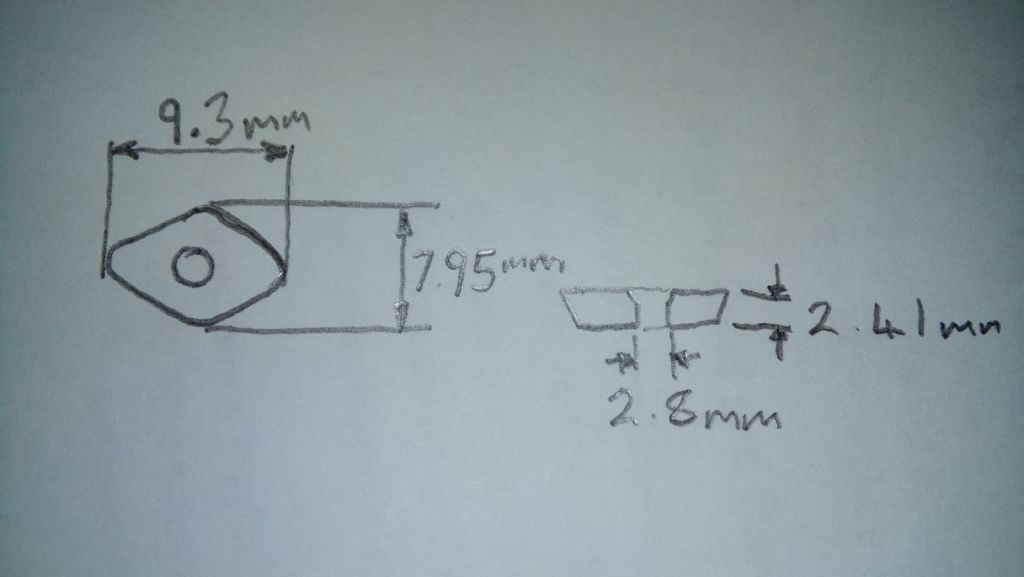

Can anyone help ? I'm trying to id this inset, I was given it with a holder which is 10 mm sq, there are no markings on insert or holder. I've contacted Glanze but they haven't replied
Thanks
Mat
Dimensions agree pretty well with my CCMT 06 inserts. From your sketch I would reckon perhaps a 0.6mm tip radius. e.g. like this
HTH,
Rod
Edit : forgot to add the 06
Edited By Roderick Jenkins on 21/11/2016 13:06:42
Possibly a CC??06????, ? represent other unknown figures but CC and 06 will be listed as insert shape and size of cutting edge.
Emgee
Rod posted while I was typing, too slow again !!!!!!!!!
Edited By Emgee on 21/11/2016 13:05:46
But I was editing while you were posting!
Good to have some confirmation
Just measured these.
They measure to your sketch.
These are Sandvik ones but are made by countless others.
Nick
Hi Roderick, Emgee and Nick.
Thanks for your reply's I can get some replacement tips now.
