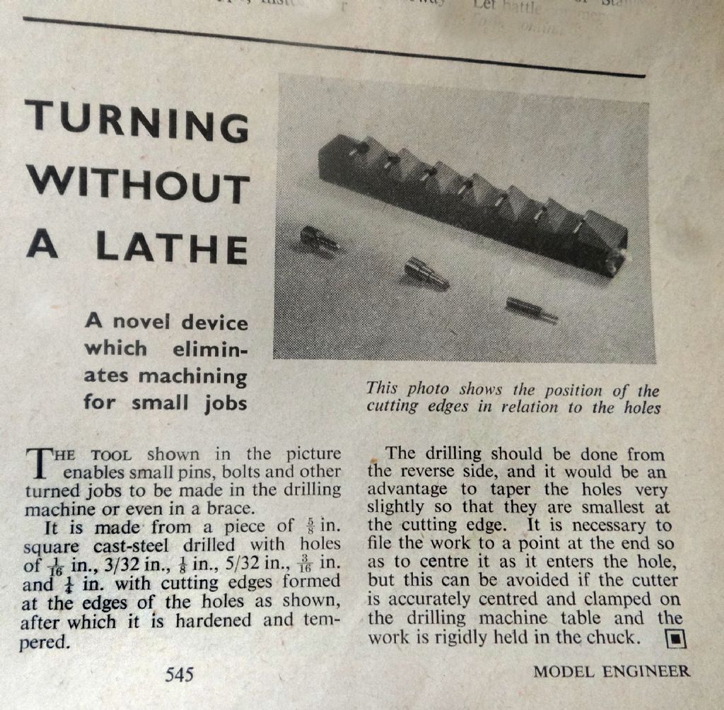

      This very short article appears in ME №2891 18 October 1956.
      The photograph of the tool is blurred with poor contrast in the original.
      Does anyone know how the teeth should be shaped and how it works? I'm guessing this is so simple it's obvious. But not to me!
      Ta,

          Hard to see from the photo but the cutting action may be similar to that of those excellent chatter-free countersinks where the cutting edge is formed by the convergence of a hole at 45 deg to the tool's axis with the 90 deg, etc cone.

            In principle, I think it's best thought of as a set of single edge cutters in a row, one for each diameter.
            Material would be held in the rotating drill chuck and pushed through the tool.
            [ sorta like a lathe on 'relativity' ]

              I expect the stock would be turned by a drill or brace and introduced into the bore of the tool to cut. The tool was likely intended to be held in a vise.
              A neat idea, but tool life would likely be short cutting steel, brass probably would enable a long tool life. Not easy to resharpen the cutting edges I think, if the tool were hardened.

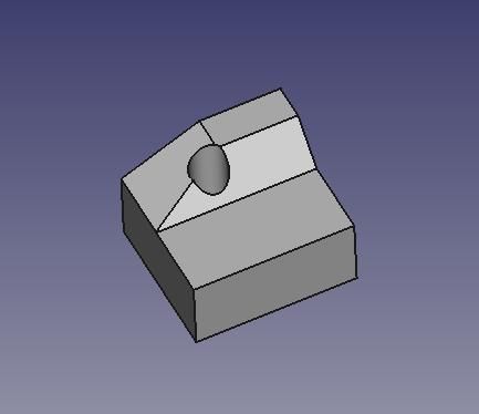

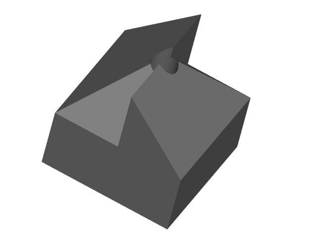

                I think each 'cutter' is shaped like a 'roof' aligned with each hole. Half of each side is then filed away again to create a pair of teeth on each hole.
                This would allow all the teeth to be created by filing alone:
                EDIT: on staring at the original pic, I think each tooth is filed down slightly to reduce the front clearance and make the teeth stronger. This is where you would sharpen it.
                Edited By Neil Wyatt on 26/11/2017 19:26:40

                    Thanks for the other suggestions. Like Neil I've been trying to visualise the cutter in 3D CAD. My effort is much less convincing than his.
                    Pity the photo is unclear. I don't think it's as complicated as Neil's suggestion but it's hard to tell.

                      Have you ever made a 'spot face cutter'? Essentially a bit of silver steel, hole bored axially, saw across the end twice then file 4 angled lands on the end, insert an alignment dowel in the hole. If you leave out the dowel and spin it into some wood you have a 'plug cutter'. Well this si just a two land version for metal.
                      Google spot face cutter and plug cutter images if necessary.
                      Probably a good idea for non lathe owning model railway boys of the time who could make the gizmo in the school workshop.
