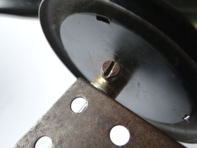

      My 3D-printed engine design is stumbling towards being printed, but as it will take about 24 hours and use lots of plastic filament, I want to improve it as much as I can first.
      Friction is worrying me because plastic running on plastic is more like a brake than a slippery bearing.
      When I did Meccano, it was recommended to reduce friction by fitting a loose washer on the axle to separate the wheel hub and frame, as in the silvery example just visible in the photo:
      I suppose the idea is the brass hub slips against the washer, which is free to rotate and slips against the frame as well.
      Attractive to think the arrangement reduces friction, but does it work? Another way of looking at it is it doubles the braking surfaces and wastes energy spinning the mass of the washer. The arrangement seems likely to increase friction, not reduce it.
      Slightly different case maybe because the contact pressure is much higher, but I think bolts tightened on to a washer are less likely to work loose, not more!
      I'm thinking of using a plastic printed washer to reduce friction on my plastic engine. Worth doing if it decreases friction, otherwise a waste of printing time and plastic, perhaps adding friction to the engine as well. What do the team think?

            Which is a strong hint washers do reduce friction, thanks!

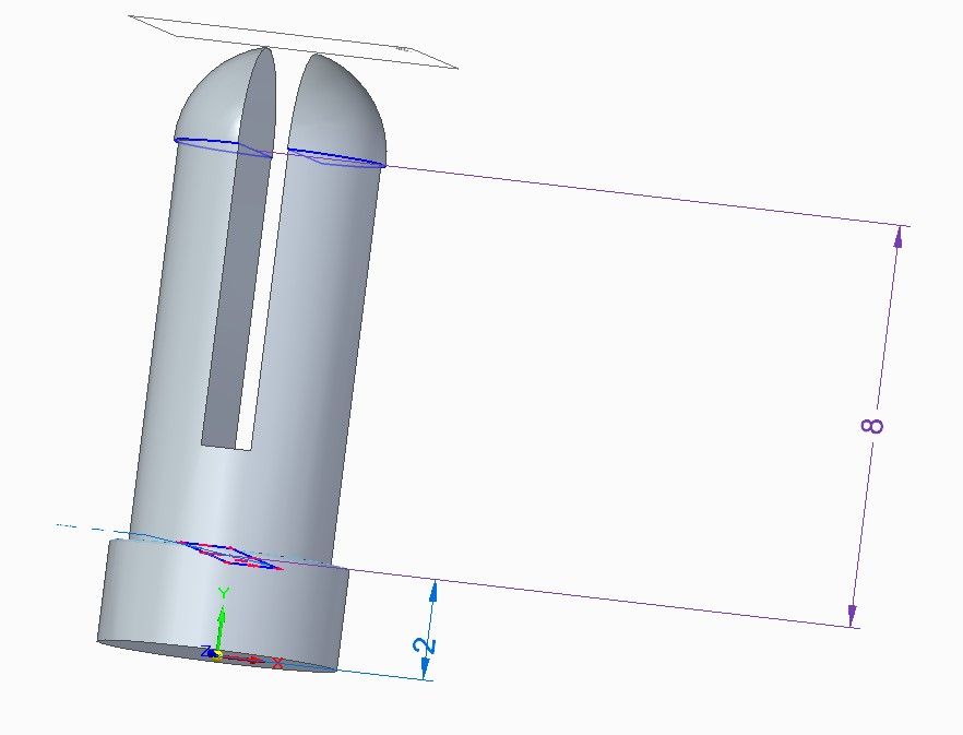

            Should have mentioned I'm trying to print the entire engine from PLA if I can make it work, so PTFE isn't entirely welcome (yet). I'm looking seriously at hook clips and bayonet fittings at the moment as a way of avoiding glue!
            Except it's obvious my pure-plastic approach makes life difficult! Allowing other materials would simplify and improve the engine in many ways, for example the design could easily be changed to use standard metal roller bearings, which are far better than plane bearings made of ripply plastic.

                Great minds think alike! Rivets are under investigation, though I hadn't thought of melting them – good idea. My version isn't permanent. Need to make some and experiment to see if the plastic is springy enough and how tight they hold.

                        Thanks for the replies gents, even though they confirm my fears about running plastic on plastic. At least the washer idea isn't completely bonkers.
                        However, the answers tipped me into a rethink about the engine: I need to test how the plastic I have in mind (PLA) performs in a bearing, so something simple is in order. Back to the drawing board!
