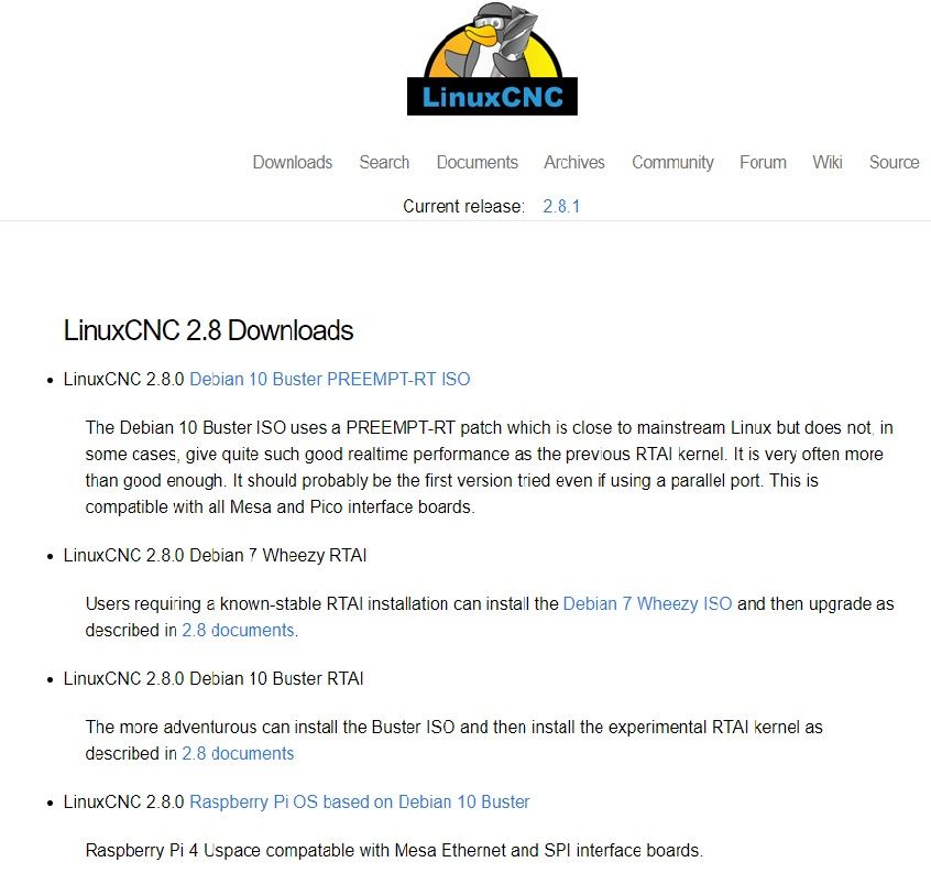

                        #516321
                        Another JohnS
                          @anotherjohns
                          Joe;
                          http://linuxcnc.org/downloads/
                          lists an ISO download.
                          I do know that there was an issue going from one real-time kernel to a newer one; this gave the LinuxCNC team a bit of an issue. Looks like it's solved.
                          Note that with "smart" cards like the MESA ones, perfect real-time is not required; with the old parallel port, servicing that port did require quick and timely response. (I use the MESA cards in all of my machines)
                          I can fully understand the frustration when LinuxCNC was going through that real-time transition, but with an ISO, maybe it'll install nicely. Knowing what I do from seeing your work here, I'd expect that once it is running, and you comprehend the flexibility, you'll be very happy.
                          Whatever you do, keep doing, and (especially) keep posting!

                                  Posted by John Alexander Stewart on 30/12/2020 15:16:12:
                                  Joe;
                                  John.
                                  Hi John, Thanks for the encouragement!
                                  Yes, I was on that page, but that is what I found confusing ( for the un-initiated..)..
                                  Assuming I have MESA cards, what must I choose?? Makes me feel all Wheezy..
                                  Joe

                                  Another JohnS
                                    @anotherjohns
                                    Joe;
                                    on all of my machines, I use the MESA 5i25 cards. I use the parallel ("printer&quot cable option.
                                    On one machine (a small CNC lathe) I use a Gecko G540; on my older Seig KX1, the same.
                                    On my larger mill, and ex-project CNC lathe, a MESA 7i76.
                                    (I hate giving advice, so use your judgment )
                                    I think for you, a MESA 5i25 and 7i76 combo. It gives you lots of stepper outputs, lots of signal outputs, inputs, spindle encoder, "0-10v isolated" spindle control, etc, etc. Way more i/o than you'll need, but better too much than too little. You've got the brains to figure out a) what you need i/o wise, and b) what else you can do once you have it running.
                                    There is a "plug-n-go kit" for the combination:
                                    http://store.mesanet.com/index.php?route=product/product&path=83_84&product_id=215
                                    Anyway, my 0.02c – it's what I use and I find it well supported and incredibly reliable.
                                    And, if it matters, my 3 machines are running an old Intel board, dual-core, obsolete from about 6 years ago; more than enough power to run the machines, with i/o, MPG controllers, touch probes, 4th axes, and so on.
                                    John.

                                      Joseph Noci 1
                                        @josephnoci1
                                        Posted by John Alexander Stewart on 30/12/2020 17:50:24:
                                        Joe;
                                        on all of my machines, I use the MESA 5i25 cards. I use the parallel ("printer" cable option.
                                        John.
                                        Ok John, Now you are pushing…I may still try this route – it does have a lot going for it – the learning curve scares me – I presume I will get to grips with it, but I had hoped to put the effort more into the machine as opposed to the software..
                                        Could you explain a little the listed downloads on that page I included – There is the ISO you mentioned, but its definition differs ( a lot?) from the other available downloads – is that significant to me? Or do I just take the ISO and go for it?
                                        I gather from your PC that the ISO is 32bit? That also confused me a little – in the system requirements on the wiki is is quite unclear what is needed – they mix 32 bit and 64 bit requirements somewhat haphazardly..
                                        Joe

                                          #516401
                                          Another JohnS
                                            @anotherjohns
                                            Joe – the Real Time package for Linux has changed; as LinuxCNC (especially if driving one of the inexpensive breakout boards) needs realtime so that signals come and go without varying latency. It seems like it's fairly settled now.
                                            That first ISO, on the top of the page is one that I would use.
                                            Just download the iso, burn it to a USB, and boot. You should be able (if it is as it was) to run LinuxCNC directly, without installing it, just to test drive it.
                                            32 or 64 bit – don't worry about it. Try that ISO on the top of the page.
                                            (Am I pushing? Well, Tormach went from Mach to LinuxCNC-based software, and paid $$ for work on the trajectory planner in LinuxCNC, so why not use what a successful company uses?? They also use MESA hardware, so you are following fairly closely a known, successful path)
                                            #516558
                                            Joseph Noci 1
                                              @josephnoci1
                                              Posted by John Alexander Stewart on 30/12/2020 21:23:48:
                                              John, Seems the 32bit/64bit thingy is important…I downloaded the ISO, created a USB boot drive, and stuck it in a Mini-ITX pc I have – 32 bit Intel Dual core – came back and told me I am an idiot trying to boot 64bit stuff on a x86 machine…Ok, stuck the USB drive in my Dell 64bit Win-10 laptop – it booted , into Linux, and for the life of me, I could not work out how to run Linuxcnc controller! After an hour digging in the LCNC forums, gave up, and found my Laptop would now no boot windows anymore..put it in its bag, packed away, and gave up!
                                              Next year's problem! ( Oops..that's tomorrow..)
                                              Won't give up just yet, but need some direction soon!
                                              From Namibia, Happy new Year to all!
                                              Joe
