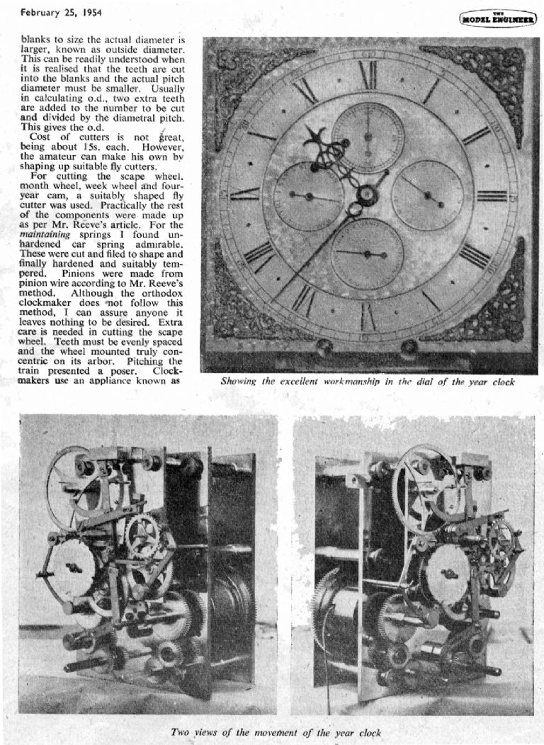

            Before replacing the old & yellowed issue in the book case, here's a fairly hi-res scan of the only other page with images.

              Thanks for the quick reply, Hermann seems to have copied Claude's design to the letter, I intend to use a much simpler perpetual calendar that was described by the late Brian Bisset in the Horological Journal in 2008, on a sub plate on the front with all the clock work between the plates, that is the theory any how. Again many thanks.
