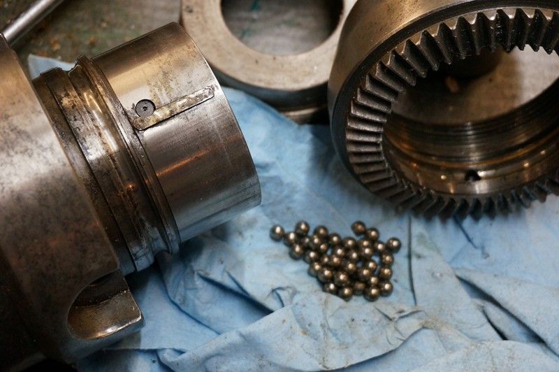

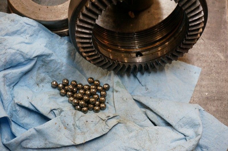

                              Ian Parkin
                                @ianparkin39383
                                Took my chuck to bits to photograph its construction
                                Remove the large screw from the outside on the ring…fairly tight large well fitting screwdriver needed
                                Hold chuck over a basin or rag and rotate body holding ring with screw hole downwards
                                about 30 balls will drop out
                                or dsc00784 (copy).jpgyou could fish out with a small magnet
                                then the ring will pull off clean and refit
                                Ian

                                KWIL
                                  @kwil
                                  Slotted screw cap does indeed give access to the ball bearing ring inside the closing piece. Screw is only lightly nipped in place.
                                  I have used Rocol Ultraglide Slideway oil to lubricate, keeps it smooth to operate. Place aperture at top, drip oil in to fill, hold closing piece still and rotate backplate, you can see the balls go by and the oil enters the raceway, add again if necessary, replace cap and nip.

                                  ega
                                    @ega
                                    Good to have further hard information. I'm guessing that the function of the balls is to allow greater torque to be applied to the closing ring as with a ball bearing three jaw drill chuck.
                                    And presumably the need for maintenance arises from the ingress of suds and oil loss through centrifugal action.

                                    #209231
                                      Thanks, Ian
                                      Very useul reference photo.
