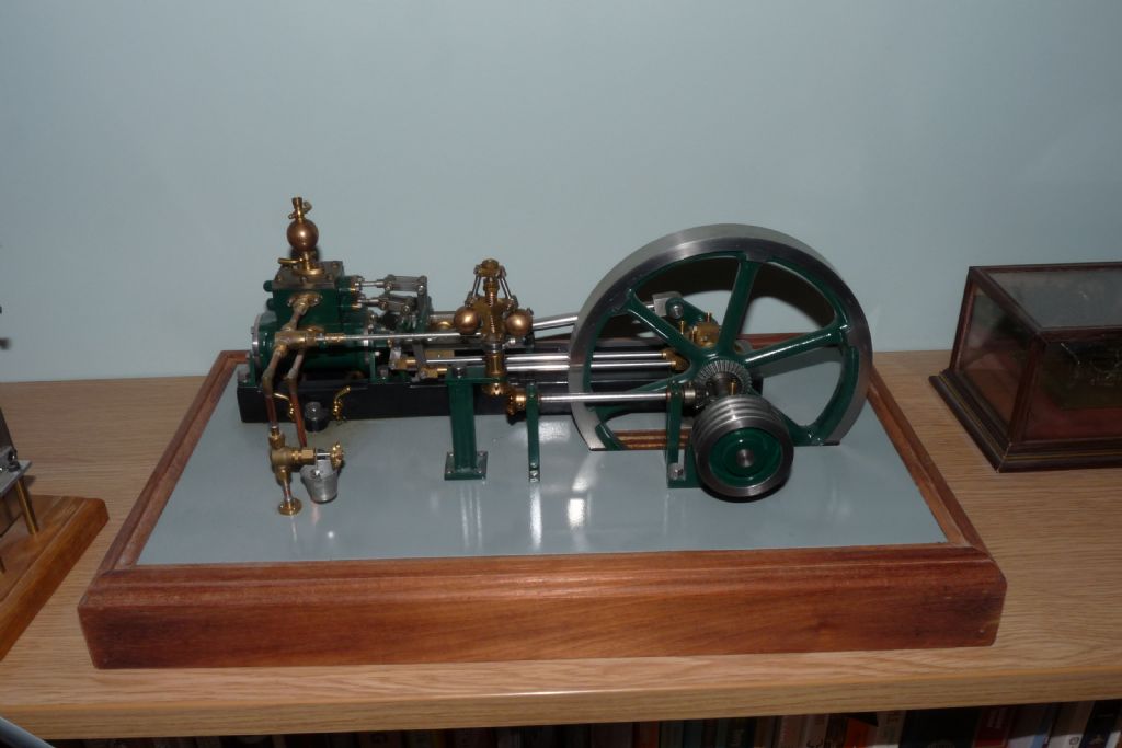

I've finally got started on my James Coombes build. Allan will twig what the "with chips" is about…
When I decided to build my first stationary steam engine, I had a very specific configuration in mind. It became very obvious that the Stuart castings and kits like the Victoria are versatile and can be used to build quite wide ranging variants.
My first attempt at a stationary engine was based strongly on the Victoria, but it has some features which are of my design and markedly different.
The James Coombes was configured from some existing Stuart castings and extrusions, then a few extra, like the boxbed, the cylinder caps and crankrod guides were created for the kit.
My Victoria was a long time in the making, mainly because of the time taken to work out the design and build of the bespoke parts. Although the Victoria was built and intended to run on steam, I 've only run it on air, I couldn't face stripping it down to clean out the water and gunk from the steam oil afterwards as it would be on the shelf for very long periods.
So, for the James Coombes, the plan was to build it straight out of the box, but include the governor. The cheap way to make the governor was to use the plan I have for the original governor kit and simply buy the fixings kit, which provides the balls and spring and of course, the fixings.
When I started reviewing the plans, I decided that the four columns that support the cylinder assembly could be improved by using square bar so that the machining would leave square "feet" at each end of a column and to add create the impression of a chapiter at the top of each column.

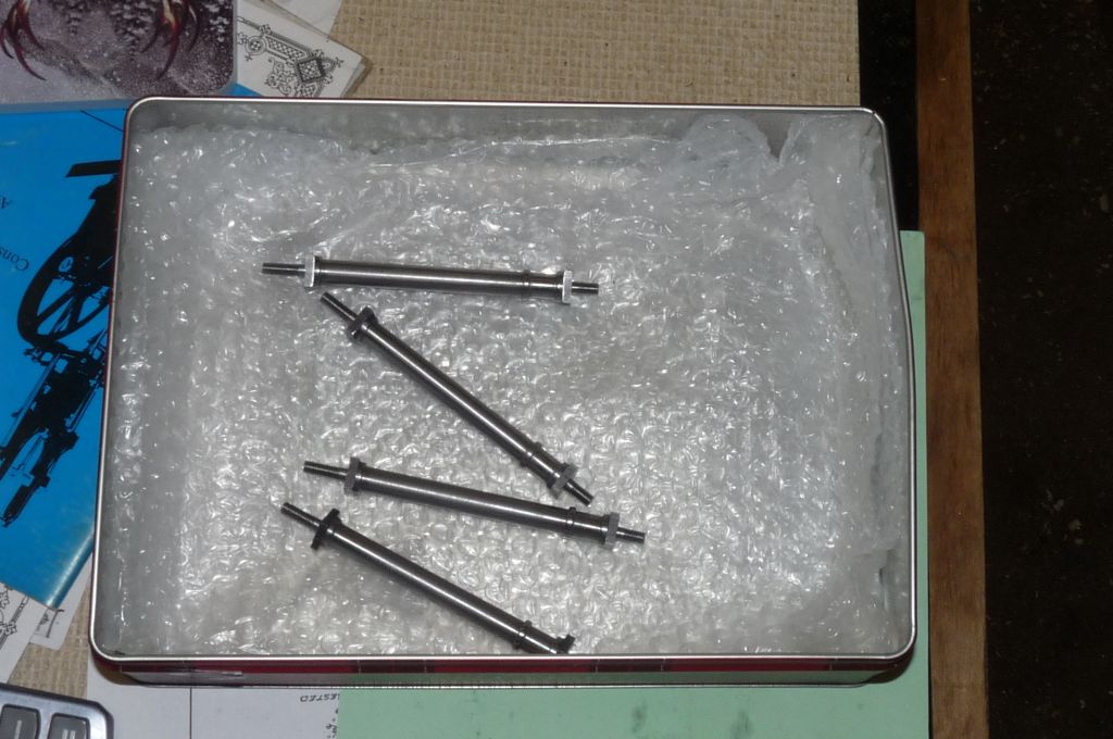

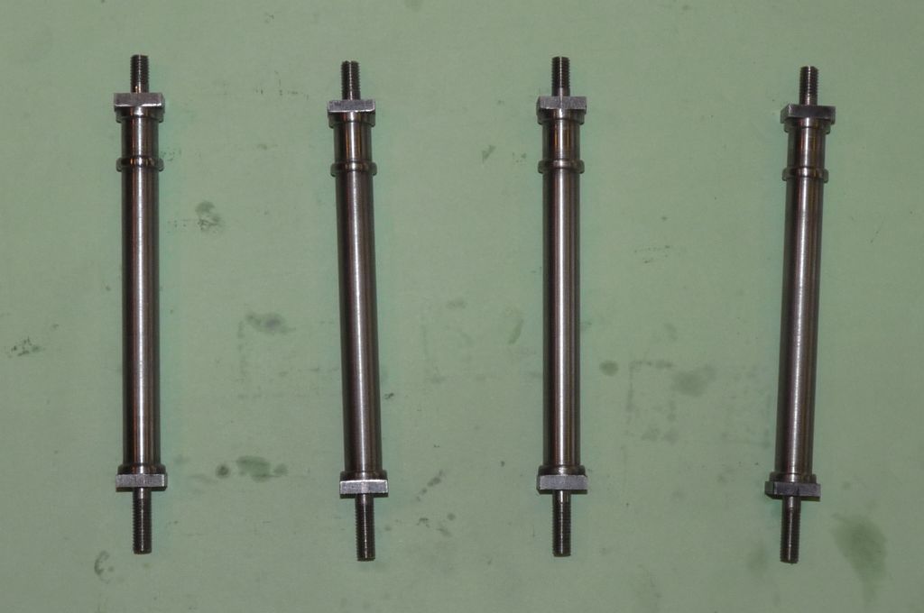

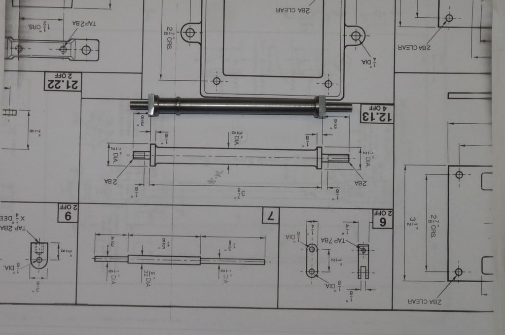

This is the prototype column, I sketched it out, machined it, had a think about the proportions
and then made four "production" components:
I'm afraid I missed out the lilywork and pomegranates, may be next time ![]()
When I built my first engine, the Nemett 15S (the "Lynx" I think it is now called?) I'd make a part, admire it, then throw it on the bench, and move on to the next part. Stupid.
Now they don't get lost or damaged!

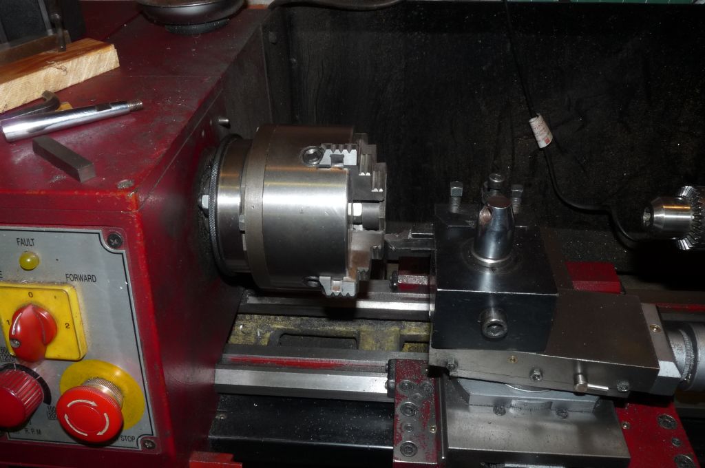

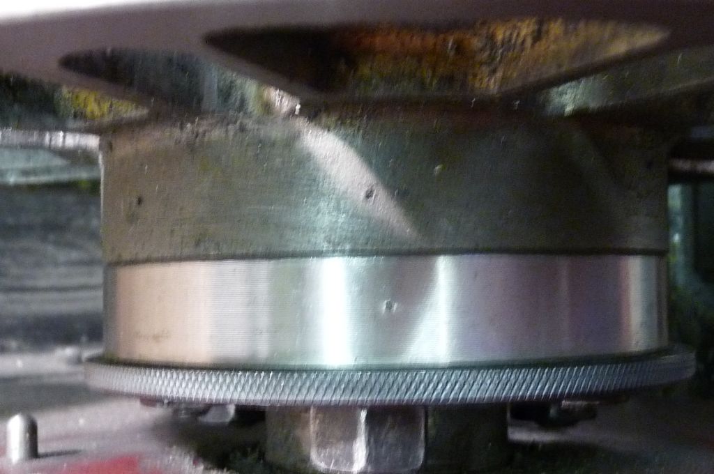

The serious point to make to folks just starting out, is that this stuff is razor sharp and you do not tug at it with bare fingers. The second point is that I used home ground lefthand and righthand HSS knife tools. The Lefthand tool in particular was suberb at removing material and producing a very nice finish. It did this by producing continuous lengths of this stuff at high speed, which can be dangerous (you really wouldn't want this wrapped around your nose!). One solution I've successfully used with a homemade boring bar is to grind a groove behind the cutting edge, which will break up the swarf and make the cutting operation much safer.
In the photo below, I've swapped my quick change tool post for a standard four way tool post and set up the LH and RH knife tools, which I think is a lot faster for this operation than the QCTP.

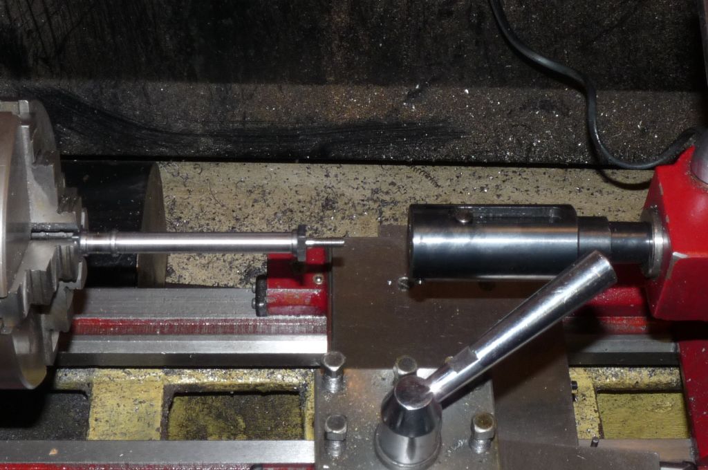

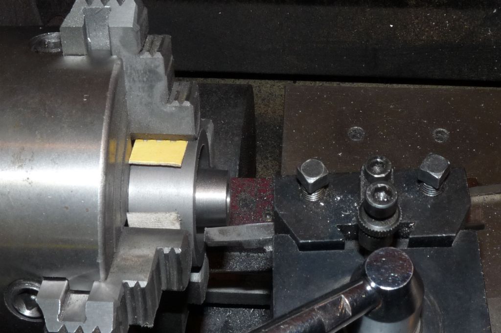

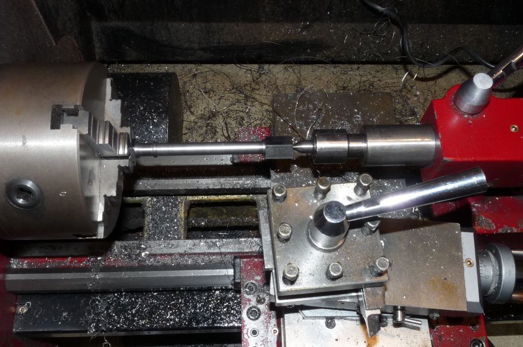

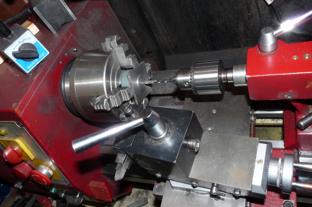

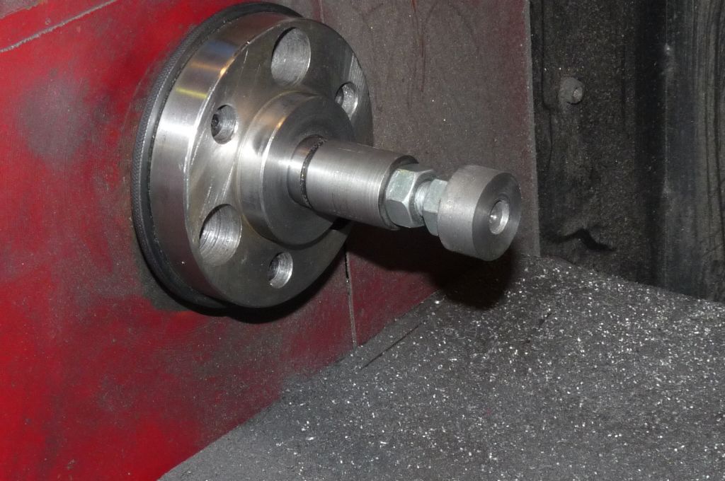

Cutting the threads on each of the column was done with a tailstock dieholder:
I did not cut the threads under power, but just spun the chuck by hand. The chuck by the way is a TOS four jaw self centering type. I bought this from one of the usual suspects for about £70, a real bargain, the only time I use the three jaw now is for hex bar.

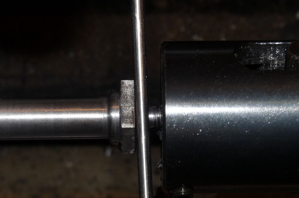

The mounting studs at the end of each column have a 1/8 inch shoulder, I measured this very simply by using a piece of 1/8 inch silver steel as a gauge:

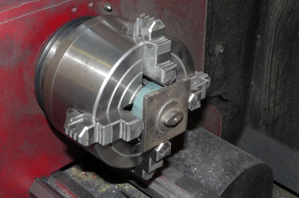

And the last thought in this post is to remember to protect components from damage when holding them in the chuck. You can just see the use of soft metal sheet (I had a bit of scrap bronze shim in the box) to protect the column from the chuck jaws.

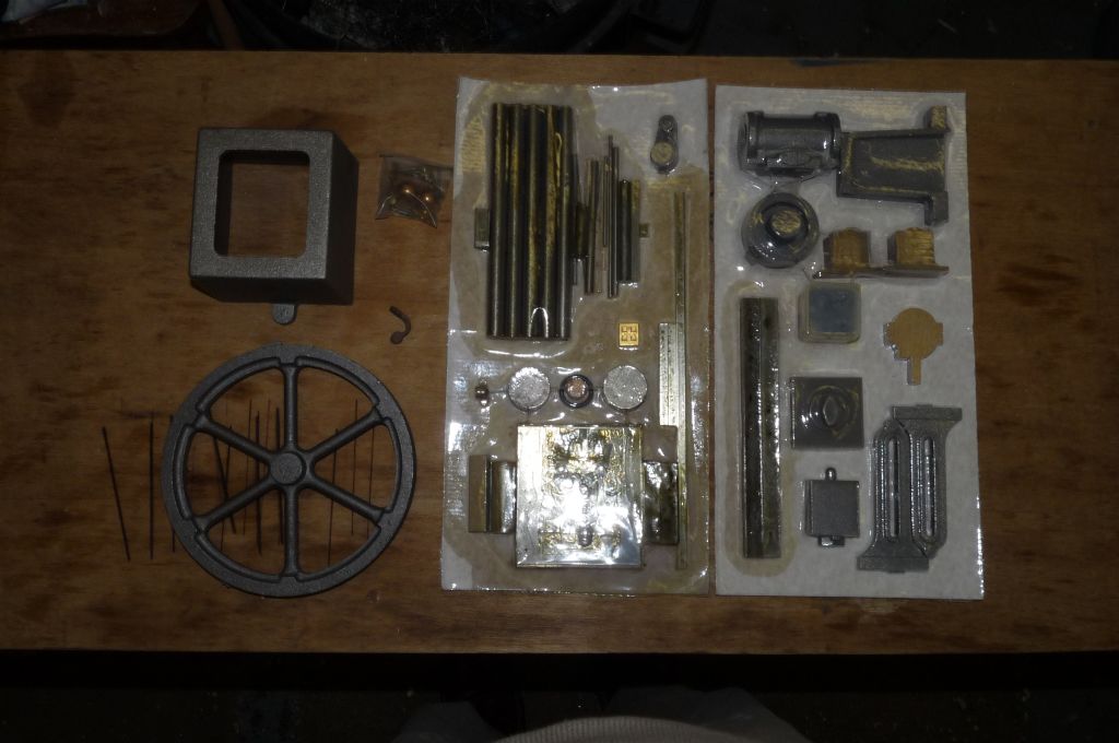

Anyway, back to the James Coombes – this is what is in the box:
I've also bought some bits to make up the governor. I do think these engines need a governor to be really finished.

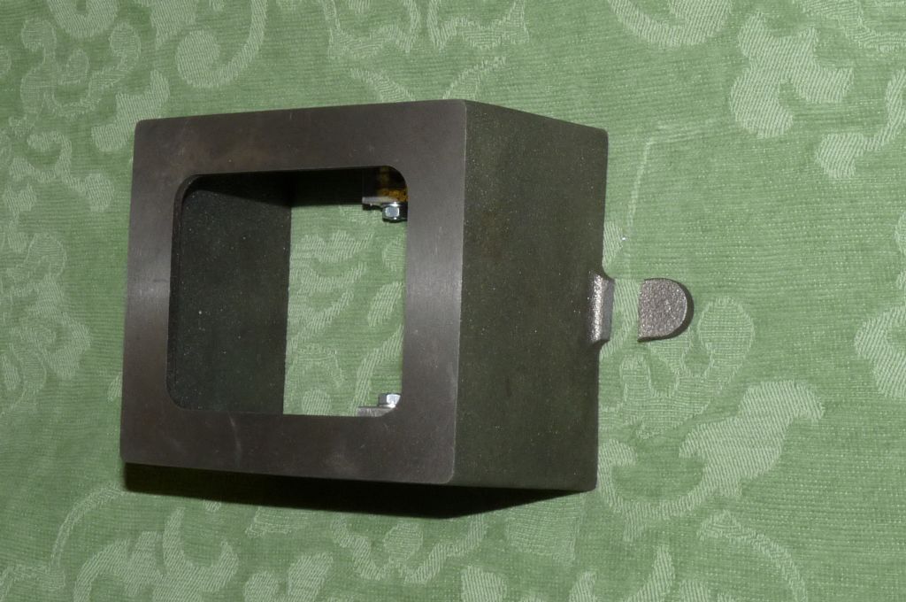

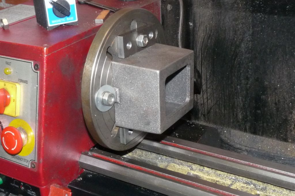

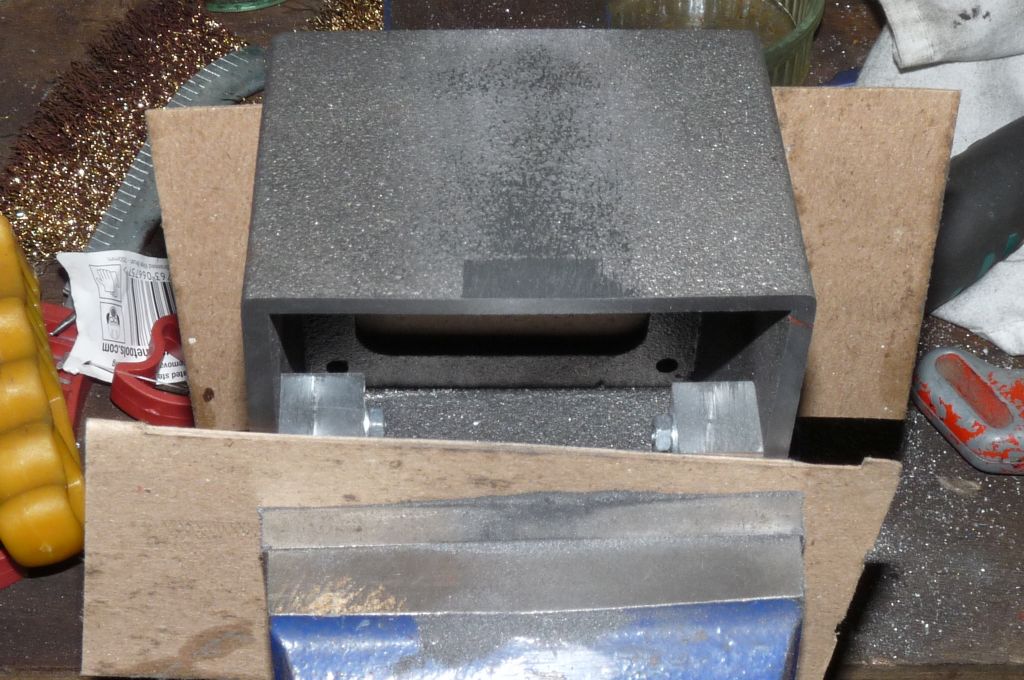

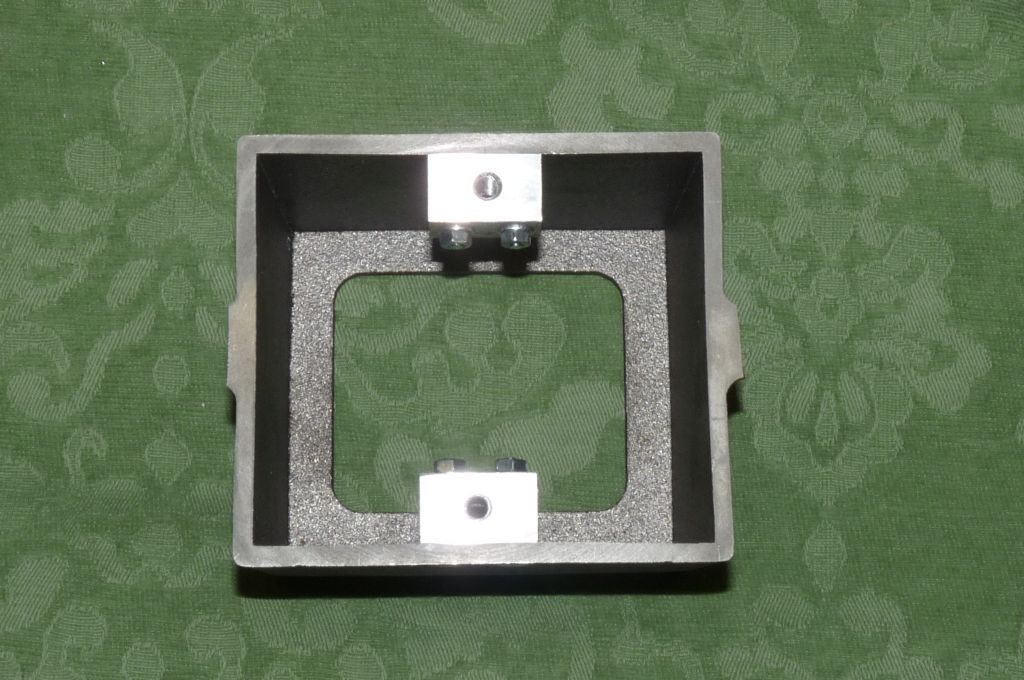

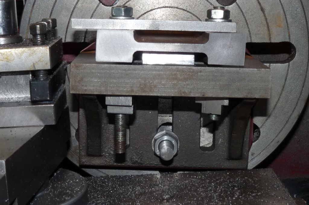

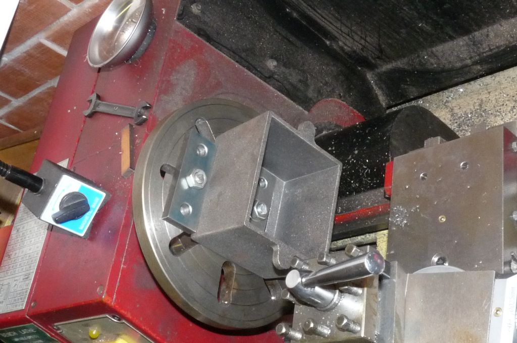

After the columns, I moved onto the boxbed. Standard approach – skim the base, turn over skim the top, all done. I decided to do this on the lathe, rather than the mill, the large square base looked easier that way.
I discovered that the casting had some distortion, causing one of the mounting lugs to be bent downwards. The consequence is that if I had taken the bulk of the material is taken from the base, I would have ended up with very thin lug, so I decided to take more off the top of the casting.
By way of scale – this is a 9 inch faceplate. I used a standard carbide insert to do the machine. I ran the lathe around 200rpm. The lathe is a C6B variable speed job, but I fitted an additional low speed ratio for jobs like this. I didn't experience any vibration and did get a nice finish. The intermittent cut didn't cause any problems, as carbide is brittle and care has to be taken.
In order to get the boxbed to the right height, I had to sacrifice the rounded top of the boxbed, which I don't think will detract from the appearance of the engine. The height of the boxbed is important as one of the crankshaft bearings is mounted on it and the other is off-board, obviously the centre height of the two bearings must be the same for the crank to run freely.
Slight accident – the deformed lug broke – I hadn't supported it properly as I tightened down the clamps. The way to solve the problem is to remove the other lug too –
Then to add the lugs internally. The blocks are drilled and tapped 6mm. I installed the new lugs just proud of the base and then skimmed them flush. At the right hand edge, the distortion is just visible. I think getting rid of the external lugs will improve the look of the finished engine. In actual fact, the prototype model that Andrew Wilson built, had the lugs on the inside.
Finally, the old lugs are filed off flush with the body and this component is complete.

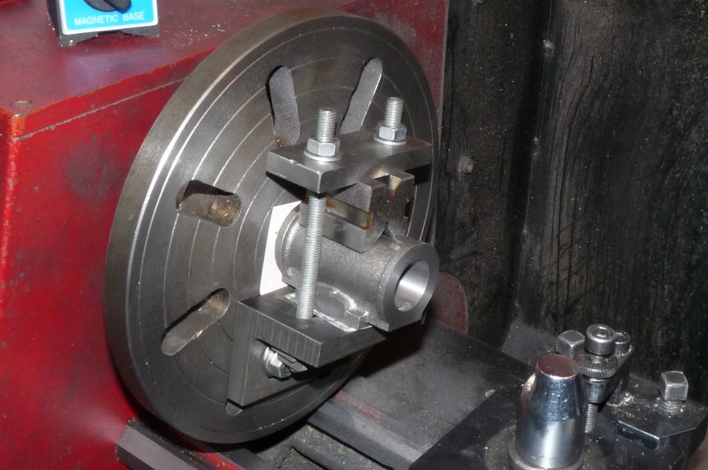

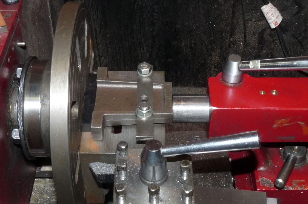

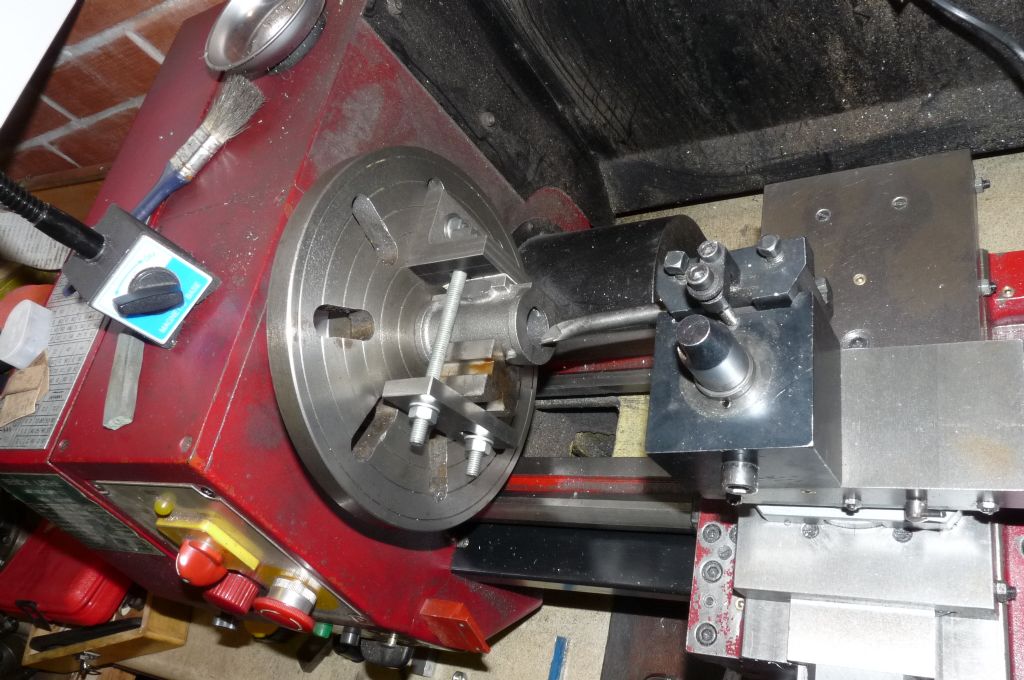

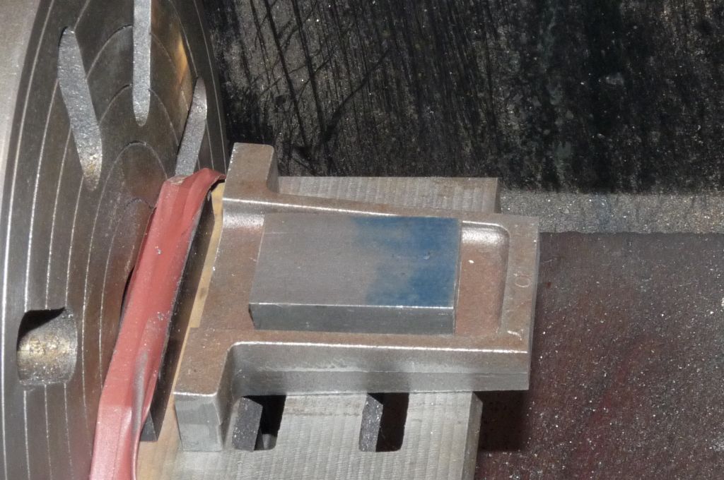

After completing the box bed, I progressed onto the off-board bearing mount. This component has to have a finished height of 3 inches so that the bearing will end up at the same height as the bearing on the box bed. It's a straight forward job on the lathe, except that the sides are tapered, so it cannot be clamped directly to an angle plate.
In this photo the casting is pressed against a packing piece, but you can see the front edge is not in contact with the angle plate. Using the tailstock to keep pressure on the workpiece during clamping is a neat trick someone on the forum told me about, but can't remember who! It does work.
In this photo, I've shown the packing piece underneath the workpiece. It turns out that the web is actually parallel to the vertical axis, so it can be used as a reference, so this is what is used to clamp against, just needs the packing piece. I've also taped down the packing piece to ensure no unexpected departures from the angle plate.
Finally, the workpiece clamped down against the web
The packing piece has to be clear of the radiused edges of the web. I'm not going to drill the bearing mount until I've completed the bearings themselves, as I will spot through from the bearing into this mount.

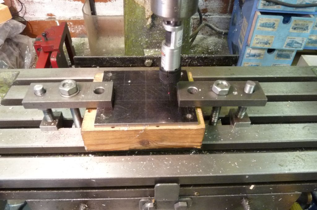

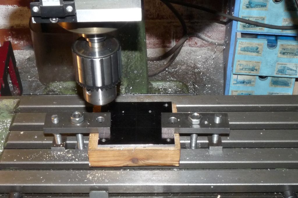

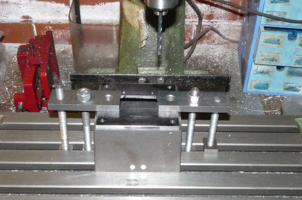

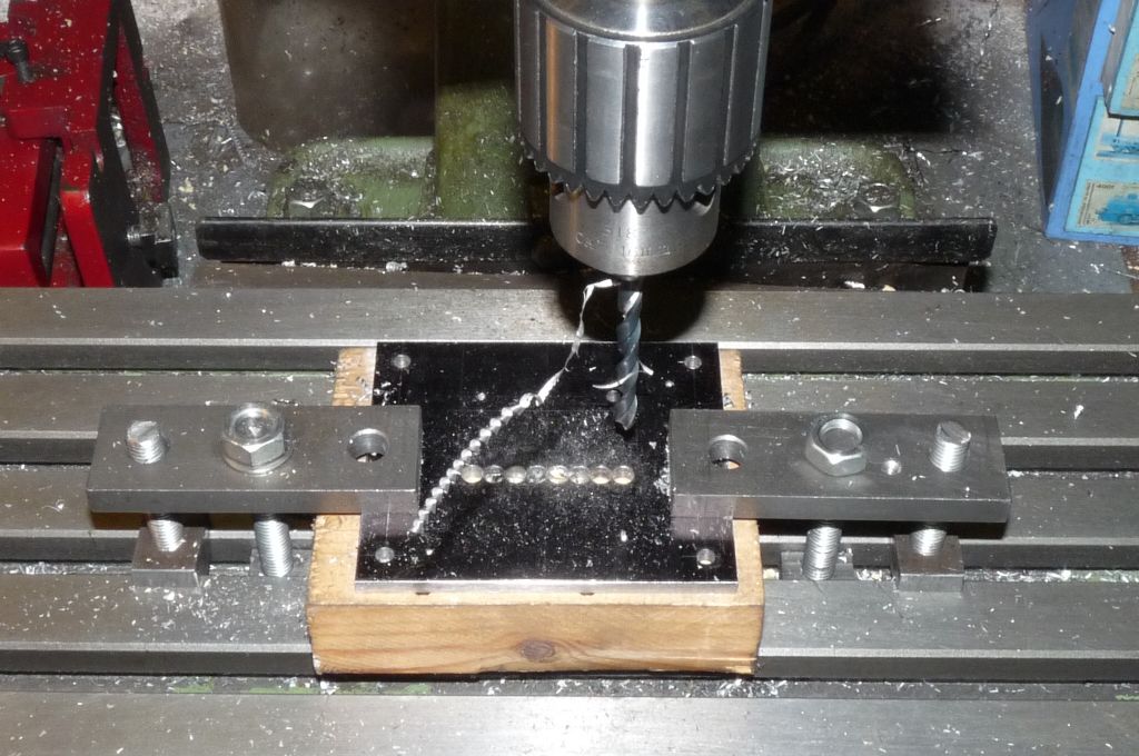

So the next components are the two flat plates, one forms the top of the boxbed and the other the "entablature" itself, that is the table the cylinder is mounted on. (That's why it's called a table engine, not because it sits on my table while I admire it
These plates are 3/16 steel from 4 inch wide stock. They are close to size in the box but cut edges do need a bit of filing to square off, which brings them to size. I did think about skimming the edges in the mill, but not sure it would be worth the effort.
The plates were "painted" with a big dobber permanent marker and then marked out as per plan.
Here is the first one being machined:

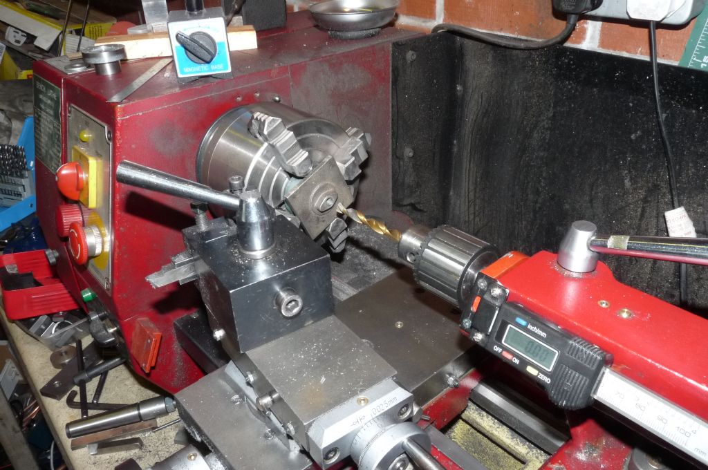

I'm just using the mill as a decent drilling machine. I'm simply working to the marking out, the hole centres have been centre popped.
There is a decent size slot to cut, so this was chain drilled, pretty accurately – I used a 6mm drill and moved the drill on 6mm each time, taking care to stay just inside the marking out.
A 6mm drill is slightly undersize for this operation, a slightly larger drill would have been better. The 6mm drill doesn't quite fill the area to be removed.
Before I started to chain drill, I used a laser centre finder to make sure the plate was properly aligned. I bought this thing on impulse at Harrogate one year and it's great for aligning edges (like a mill vice jaws and marked lines), but I really don't trust it for finding centres and don't use it for that purpose. I think there are better uses for £60.

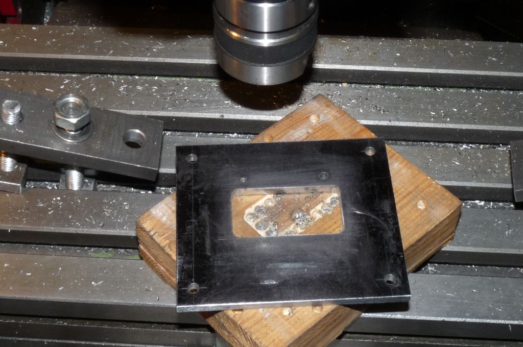

The chain drilling in progress:
The holes just touch so once I've been round, a touch with a cutting disc in the dremel, and I can lift out the waste material. (Is it safe to say "waste" in this community?) Some magic happens with a 6mm slot drill and the bottom plate looks like this:
The sharp eyed will spot one of the drilled holes is not right – the tip of centre drill broke off – I fixed that by drilling from the other side, I used a smaller drill to allow for any misalignment, then used a small punch to knock out the offending HSS. I then drill the hole the correct size, from the right side of the plate with the final size drill without problem.
Finally, spotting through to the boxbed to ensure the holes line up:

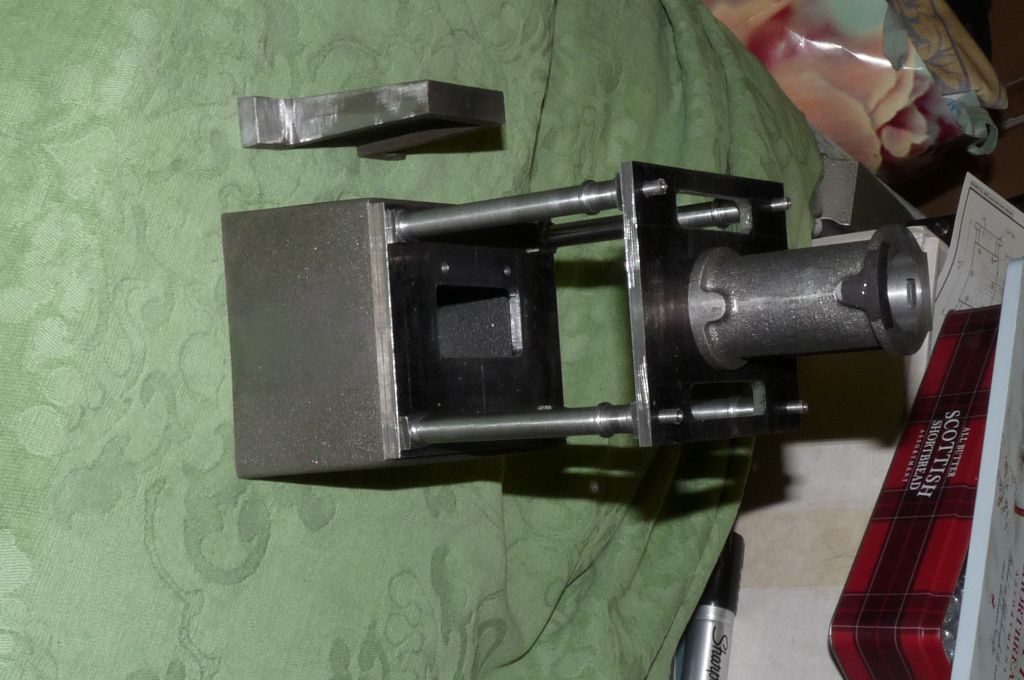

The top plate – the "Table" top is the same, but with two narrow slots for the dual connecting rod arrangements.
At this point I couldn't resist putting the bits together – apologies but forgot to rotate the image before uploading

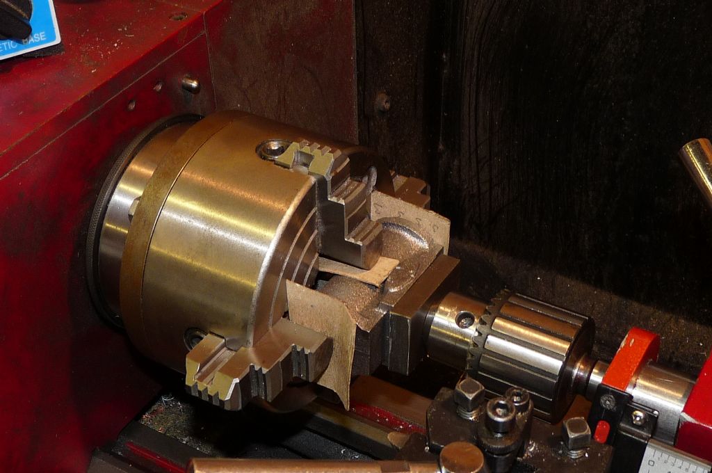

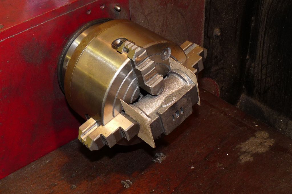

Next step is to machine the cylinder, I followed the method described by Andrew Wilson in "Building the James Coombes". It's the same method as for the Victoria, it is the same cylinder.

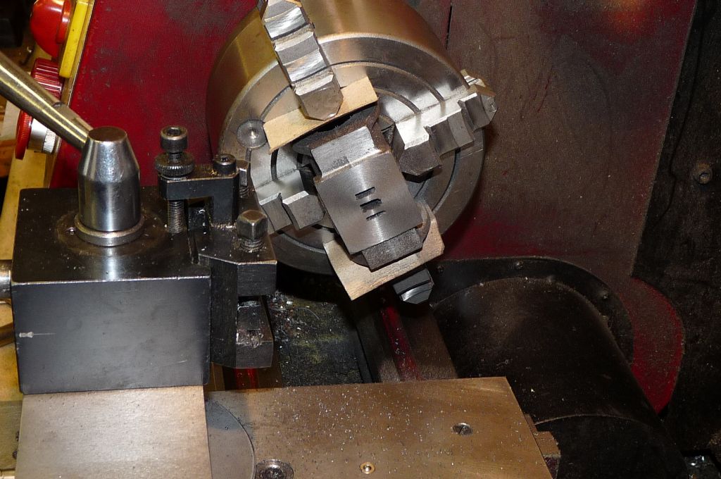

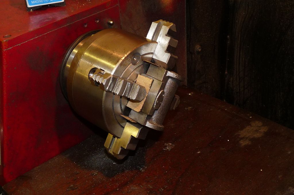

Once the cylinder casting has been cleaned up, then the cylinder is set up in the four jaw chuck using the jaw slots as pseudo V-blocks

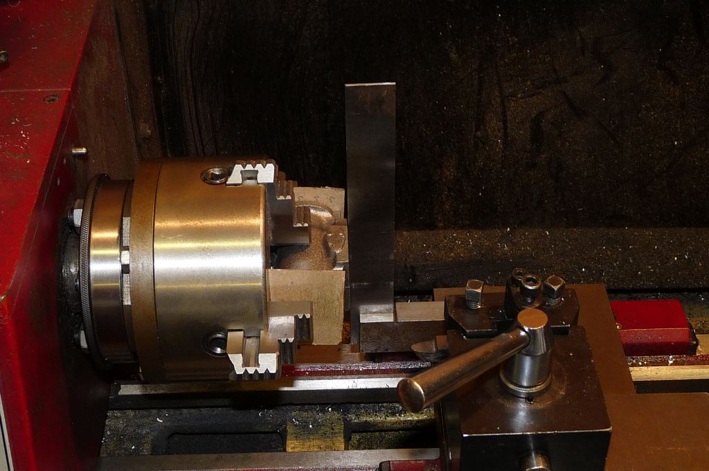

The port face is set square by using a set square on the cross slide –
Again using the tailstock to make sure the workpiece is properly seated in the chuck –
Thin card being used all the while to prevent the jaws damaging the softer cast iron. The port face only needs a light skim, to bring it to dimension.
The actual ports are a bit untidy, so these I cleaned up with a needle file, but it's quite difficult to get them to plan.

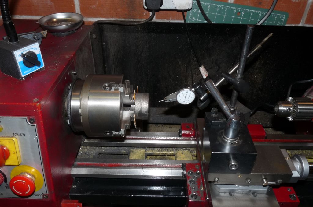

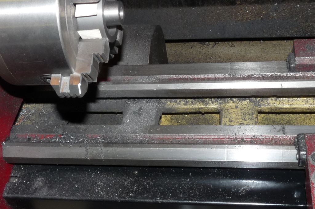

Just a couple of notes on my lathe. I have a centre pop mark on the spindle, in this photo you can also see a matching pop mark on the back of the face plate. Once I'd had the face plate a couple of years I centre popped the back, then took a light skim right across. The intent, if not the reality, is that provided I'm scrupulous about keeping the mating faces clean, the faceplate should run true. I use the same technique with all my chucks too, though not the independent 4-Jaw, to minimise the run-out. Chuck back plates are not expensive for this machine and ir's not hard to machine them in-situ to achieve minimum run-out. Given the runout on my first lathe chuck was 1/16 and I still managed to make a cylinder and piston set, It's not something I obsess about.
Final piece is this –
Two points, my machines are all metric and Stuart kits are imperial, so I use excel to make and laminate conversion charts. The little fixture I made for the Victoria and I pretty chuffed with it to be honest. The plug end is turned to 25.4mm to act as a gauge for boring the cylinder to size, the top flange is a drilling jig, it has a series of 7BA tapping size holes to make drilling the cylinder easier. Last part its that I have turned a recess into the large end which matches the cylinder cap boss, so it can be used as a drilling jig for the cylinder caps. A lot of value from a 30mm length of EN1 ! I'll show this little jig in place when I write up the boring operation.

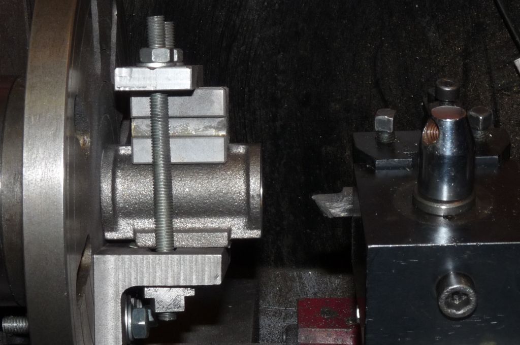

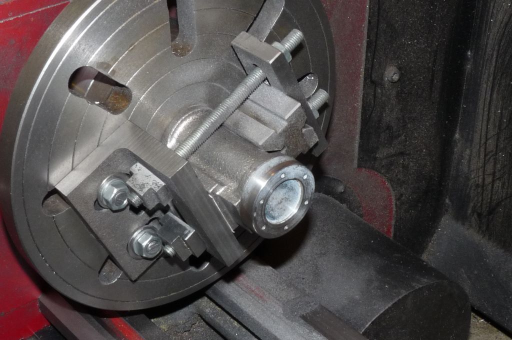

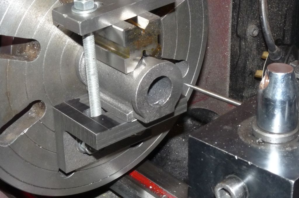

Moving on now to boring the cylinder. I find this is the most frustrating set up to get right. The bore obviously needs to be on the centre line of the cylinder and concentric with it – the bore needs to be correctly centred at both the front where the bore starts and at the back where the bore exits- the casting must not be "looking up" or down or left or right and must be properly centred. Here is my set up –
I'm using the port face (you can see it is just sat on some thin card to protect it). This should mean the casting is not looking up or down but facing down the centre line. Using the scribe, I'm then setting the height of the bore so that it is centred on the edges of the flange – this is the part of the casting which will not be machined, so the bore has to be set in relation the nominal centre of the flange.
Having set the height, I then needed to ensure the casting isn't 'looking left or right' I chose to use a little V-block that would just sit on the cylinder, so again, aligning to a part of the casting that would not be machined. The studs get in the way of using a single set square against the faceplate though.
Once I've got the setup the best I can (there are no absolutes with the cylinder casting, which always makes me uncomfortable), which takes ages, I then get ready to bore the cylinder –

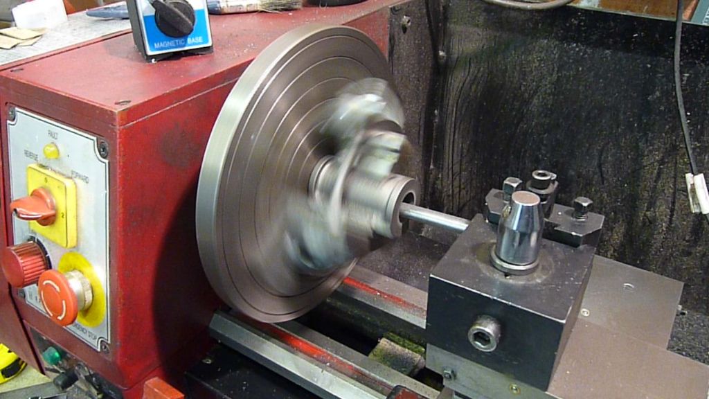

This is a home made boring bar, silver steel, heated, bent, ground, hardened, ground, honed, I find making these things quite therapeutic and you get the tool for the job, with little compromise. The overhang is set to just clear the bore and the faceplate centre hole is larger than the bore, so nothing to worry about with the boring. I find that sharp tools run at slow speeds with light cuts make nice bores.
So boring in action, all sound and fury –
It's a big file, so don't click the link if you are on 9.6K dial up
The spindle speed is around 150rpm I think.

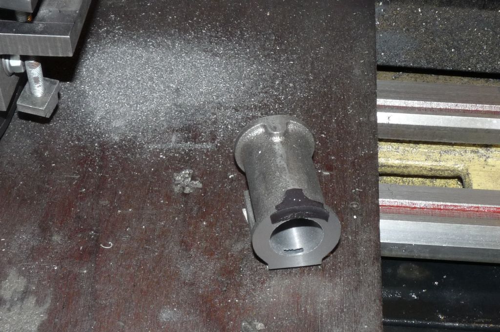

As per the previous post, I made a little plug gauge / drilling jig for these cylinders, here you can see the holes and the recess for the cylinder cap. At this point the gauge is a push fit, there is some resistance to entering the bore. The trick I use to getting to size is simply to "test" a new cut I put on, by just boring a little way (<1mm) and checking with the plug gauge, if it doesn't fit, I take the cut and then repeat. If I've put a bit much on, I can back off the cut a bit and try again. This way, if you do go oversize, there is only a small fraction that is oversize and doesn't spoil the job.The conventional wisdom is to take a number of cuts at the same setting to finish off the bore. I've found that once I've made a number of very light cuts, the effect is the same. The gauge fit the same both ends when I'd finished.
Once the bore is the right size, then I faced off the cylinder with a round nosed tool. At this point the flange face and the bore are at 90 degrees to each other and will be the end we use for the piston rod to enter as the other end is less likely to be as true.
Now the cylinder is turned around with the machined flange against the faceplate, protected with thin card, this should mean the two machined flanges are parallel.
Finally the cylinder can come off the machine – here I've marked the front flange in black marker and also put a little centre pop mark in the top of the casting, so I know which end is which
The machined portface is sat on a piece of card… I'll clean the lathe up, the cast iron makes a real mess and gets everywhere. It also makes an excellent grinding paste when mixed with the way oil, so it really must not be left. I know some folks cover the ways and saddle with a cloth to keep the horror out of the machine, I did try that once, but spent more time worrying about the rag getting caught in the work than I did about getting a good job done. Although I leave a bit of slack in the drive belt, the lathe still has plenty of torque to do damage a low speeds.

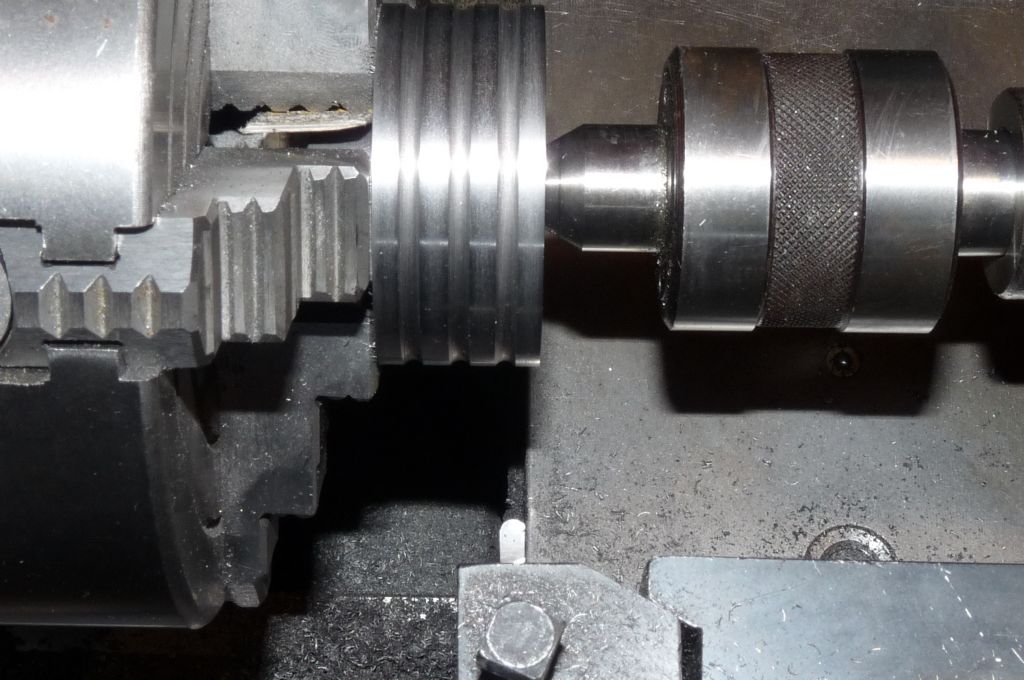

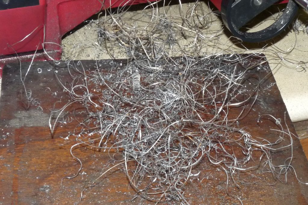

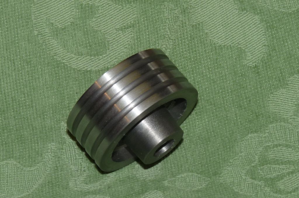

Off we go with the drive pulley. This is a real lump of cast iron and I started off by filing off the rough. I've mounted it in the four jaw chuck, gripping it by the hub. The hub is tapered, so not a great place, but good enough and it is all that there is. The bits of card serve two purposes, one to prevent the jaws damaging the hub, but they also act as an early warning that the tool is approaching the chuck jaws. Bits of card start to accumulate on the tip of the tool just before you get to the jaws.
I kept the depth of cut quite light to avoid the pulley being ripped out of the jaws. Next job is to drill the hole through the pulley centre. I did this in three – first a centre drill, then a 6mm drill then a 10.8mm drill. Finally a 7/16 machine reamer to take the hole to size. You can see in the following picture that the card has been cut away. (And not the jaws!)
What I've not show here is facing off the end of the pulley and the hub, but that's a very simple operation. In this photo, I've reversed the pulley and clocked it true. The ends of the pulley have been faced off, but here I'm actually turning the hub to a clean taper instead of the raggy 'as cast' finish. This means the hub and the pulley outer are concentric. I've also cleaned up the in inner recess of the pulley, again to make everything nice and concentric.
Finally, three grooves have to be cut – the little round nose tool (from 1/8 HSS) is effectively a form tool, so I use the live centre to ensure the cutting forces do not rip my nice pulley out of the chuck and toss it down the shed. Form tools have high cutting forces and here I use very low spindle speeds c100rpm. The tool is not perfectly ground and there is a little bit of chatter in the turned grooves, so I use a 1/8 inch round needle file to tidy up.
And then it's done!
But what a mess this cast iron makes – (This thread is called "with chips"!)
The camera isn't supposed to lie, but the lathe (& me) is a lot dirtier than this in the flesh after completing the pulley.

I wouldn't complain, it probably means more free graphite and therefore freer machining and better wearing.
Or your tools want a sharpen, those "chips" look quite dusty rather than cleanly cut chips like these. You are rubbing/scraping the metal away rather than cutting it.
Edited By JasonB on 08/06/2014 16:47:40
Edited By JasonB on 08/06/2014 16:48:17
The tools I used for the pulley were ground for the job, so freshly sharp – I wonder if the tool was set too high, so causing the rubbing? There was plenty of dusty stuff!

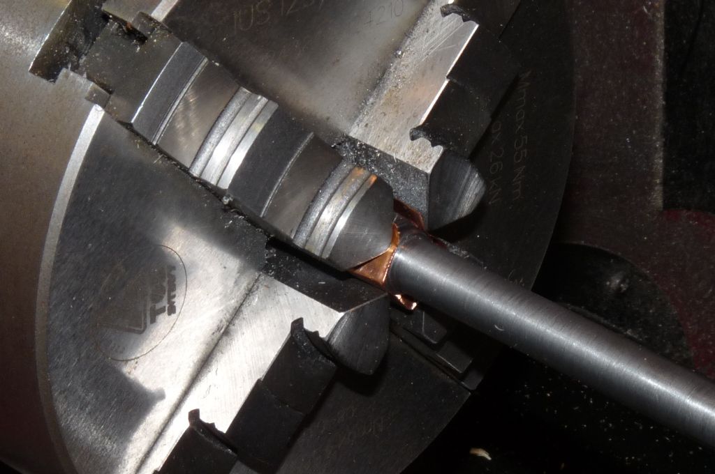

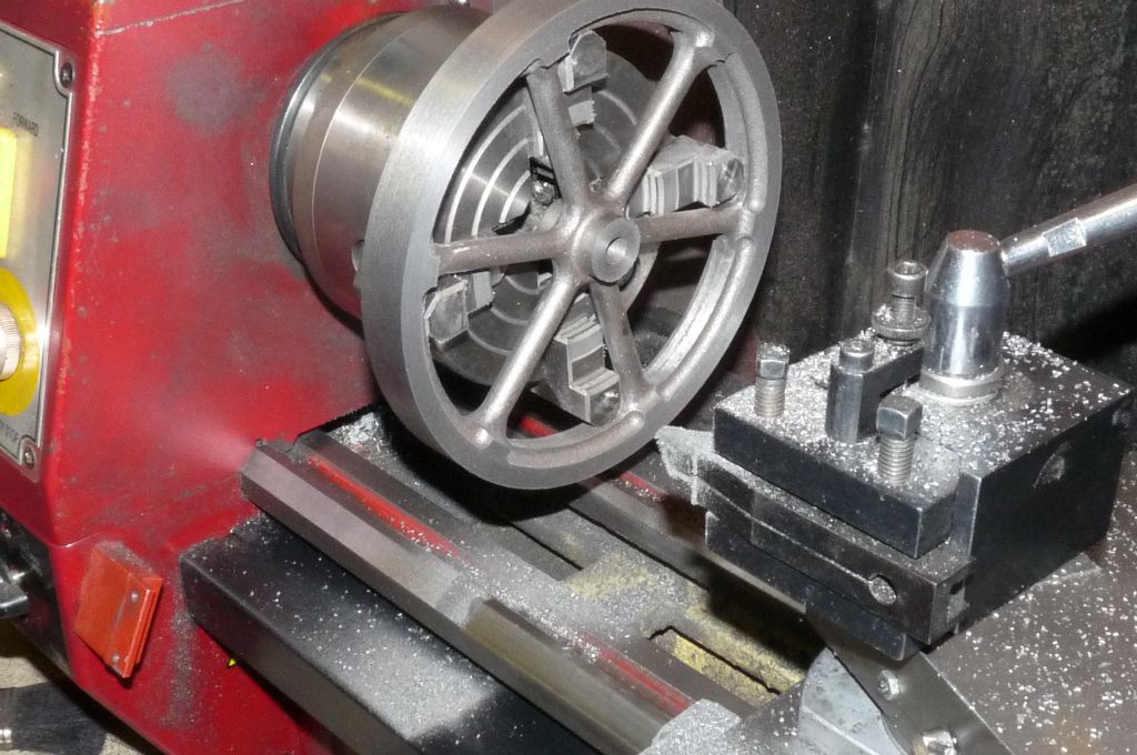

Next component is to machine the flywheel. The flywheel for the James Coombes is 7 inch diameter after machining. It will not go on the face plate as it's just a bit too small to make use of the slots and mount it on the spokes.
I've never made or used mandrels and didn't fancy using a mandrel for this flywheel, the hub is 1 inch wide and I wasn't sure how a mandrel would grip over that length.
So this is the option I chose – though I'm not comfortable with it either:
The forces from the chuck jaws are exactly right for bursting the wheel, so it was trying to make sure that the flywheel was tight enough to avoid any slipping without breaking it.
I started off by drilling and boring the hub to size then facing the rim and outer edge. The flywheel is located by trying to get the unmachined edge to run as concentrically as possible with the centre. Also any wobble needs to be adjusted out.
Once that's all done, the the wheel is turned over, clocked true off the machined hole through the hub, wobble again dialled out so the flywheel is running true and then the edges of the rim and hub are faced to size.
Pretty straightforward. What I didn't do was clean up the outer of the hub, I spotted that Jason had used a button tool to do that. Seems to be a neat trick so will probably follow suit.
Steve

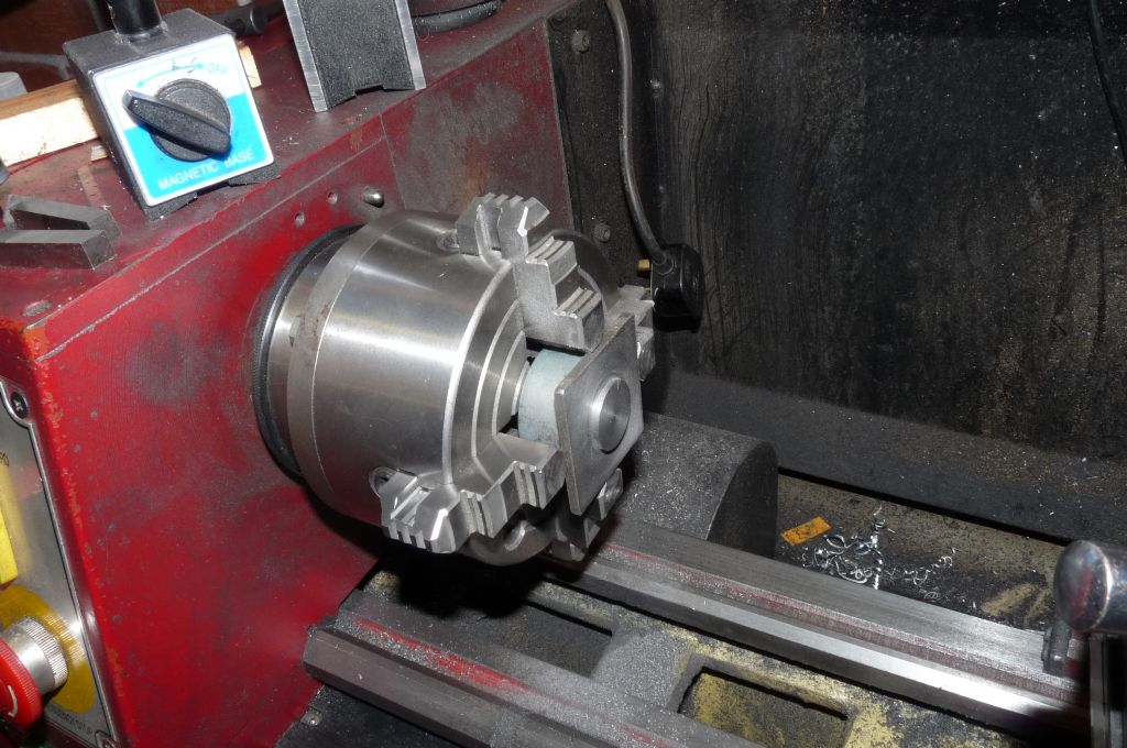

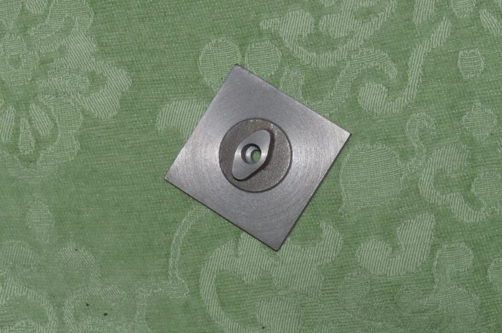

Next casting to machine is the cylinder end cap, that also provides a platform for the cross head guides, so it's a bit different to the usual.
I've mounted the casting in the 4 Jaw chuck, with a "circular parallel" to keep it as square as possible, I know some people like to use old ball races for supporting thin workpieces.
In this photo, I'm machining the spigot side first:
The approach I took was to take a light facing cut to clean up the casting. The I turned the spigot diameter to a good fit with the cylinder. Once that was done, I reduced the spigot to the 1/16 depth as per plan. Finally I used a "V" tool to get rid of the little fillet that was left in the corner between spigot and plate.

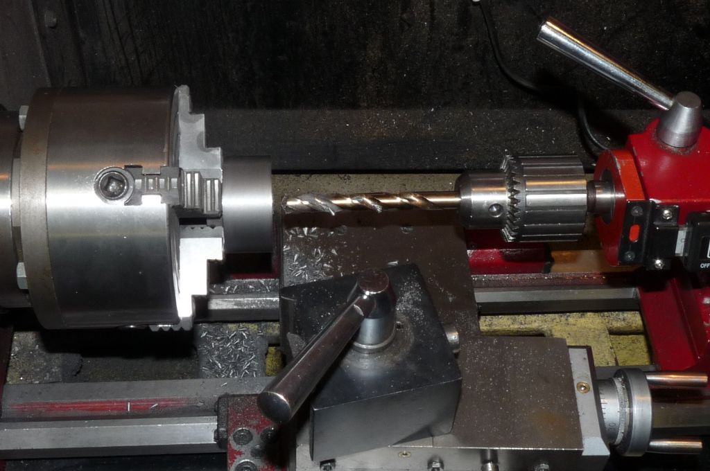

Next job is to drill and ream a hole for the piston rod –
That all progressed with no issue, so next job is to flip the cylinder cap over and machine the other side. To set up the cap, I used the tailstock to press the plate flate against the "circular parallel" and then clocked it true using the reamed hole as the datum:
Again, skimming the plate just enough to clean it up (the plate thickness has no dimension on the plan) then skimming the gland part of the casting to size all that is left is to counterbore the gland to 5/16.
In this picture, you can see I have added a DRO to the tailstock. This arrangement often fouls the toolpost when working between centres or with tailstock support, so it has to be removed.
Finally, the finished (bar the various mounting holes!) part:
Next piece is the steam chest and cover. I'm sticking to plan of getting all the cast iron machining out of the way, so I'll only have one big clean up to do. The I'll finish all the bits requiring the 4-jaw, such as the eccentrics and bearing mounts.
The steam chest cover is a little casting, just over 4mm thick, which needs to be skimmed both sides to end with a thickness of 1/8. Time for my secret weapon
All this is, is a 3MT blank arbor, turned down so it will fit in the centre hole of my 4-jaw chuck. Then it's drilled and tapped to take a piece of 12mm threaded rod (the cheap stuff from the DIY shops). A couple of locking nuts and a piece of sacrificial cast iron and you have an adjustable back stop for help with machining thin materials.
(My technique for facing even thinner materials is to put a piece of cast iron bar in the chuck, face that off and loctite the workpiece to the bar, using the tailstock to hold it in place whilst the Loctite cures. Once the machining is done, warm up with a blow lamp and the Loctite gives up. Good for thinning washers and shims.)
I'll use this backstop for machining the eccentric strap and maybe the bearing blocks.
Slip the four jaw chuck over the top, skim the back stop to ensure it is square against the lathe axes and then mount the steam chest cover:
Taking a cut from both sides to clean up and end up with a nice parallel plate for the steam chest. One thing to be careful of, is that it is a casting so has tapered sides ('draft' I think?). If all the material is taken from the bottom, then the casting might be a bit small to nicely cover the steam chest, so best to take as little off the bottom as possible and all the rest from the top.
Steve
