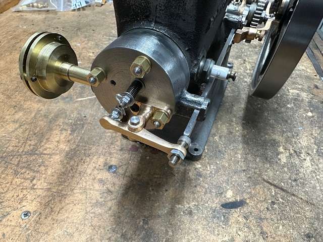

A quick question. Looking at the plans am I correct in saying that the 0.250" brass ignition stud is pressed through the insulation collar and through the hole in the gear such that it just presses on the oilite bush and so completes the connection.
Thanks,
Colin
Edited By Colin Heseltine on 26/02/2023 10:40:35
Hi Colin, I’ve spent a fair bit of time on it lately (maybe too much!) to answer your questions
I haven’t got round to drilling the timing shaft locking screw.
There is a locking screw on the crankshaft pulley
And yes the ignition stud goes all the way through to the oilte bush.
Just wondering what do you need to silver solder?
ian
The ignition lever sleeve is silver soldered which I've done. But the crank will be built up rather than using casting. So the crank shafts and big end will be silver soldered into the webs. The ones I was given with the engine are both built up but just pinned and the shafts have all moved in the webs.
I still have to drill the timing shaft locking screw and it looks as though my plans have missed the crank pulley locking screw. I also found an error for the timing screw. The dimple for the locking bolt was shown to close to the bolt head.

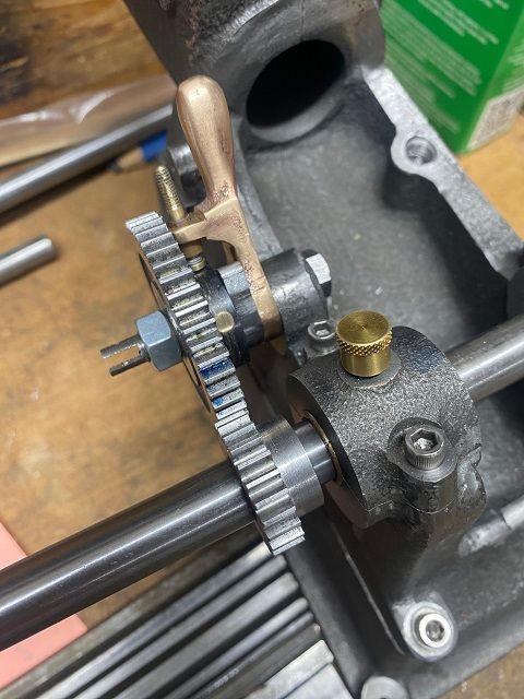

I have done the insulation sleeve for the ignition stud and fitted that and the stud and also done the contact stud and its bushing. Need to make nuts and source spring.
Colin

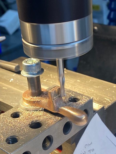

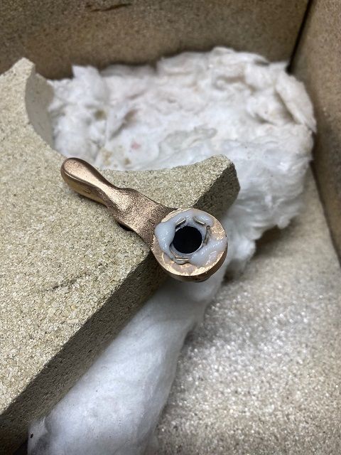

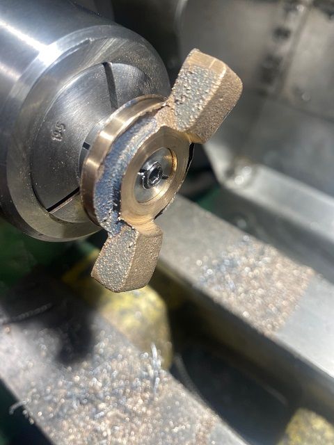

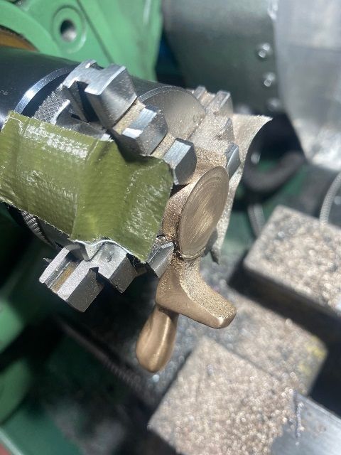

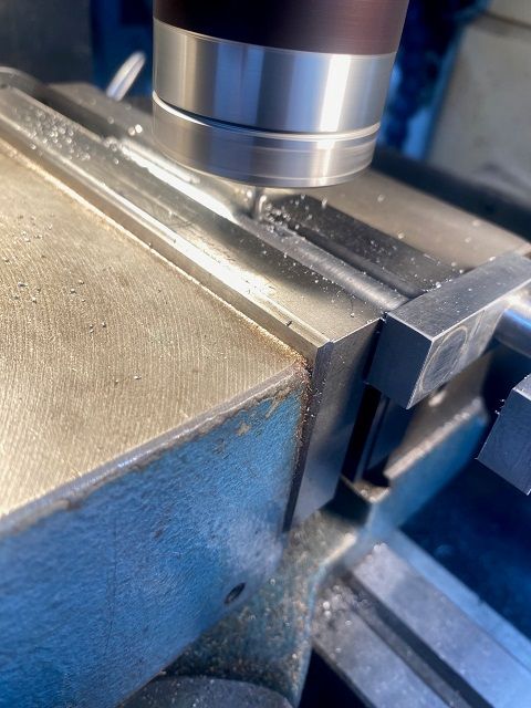

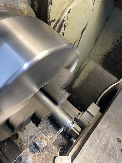

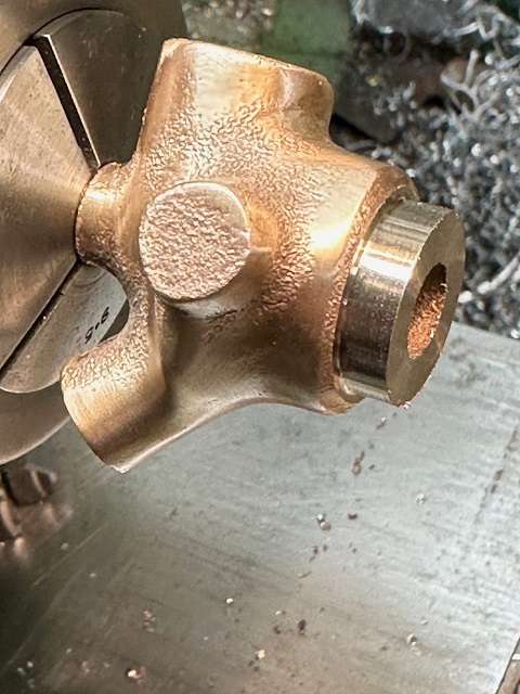

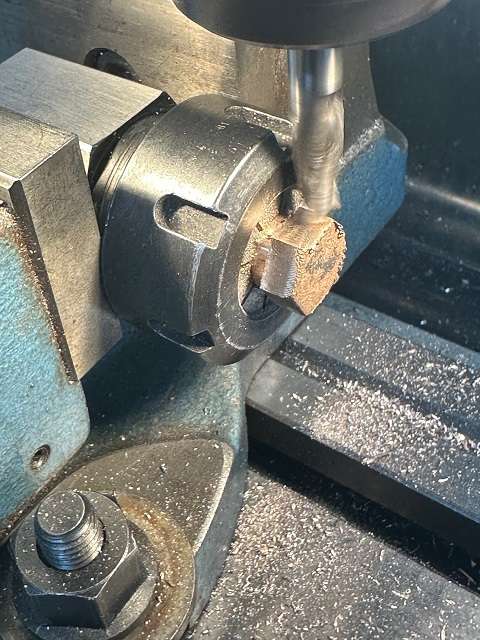

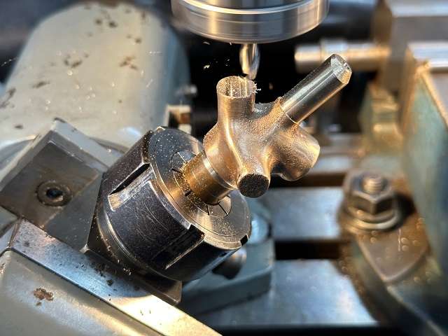

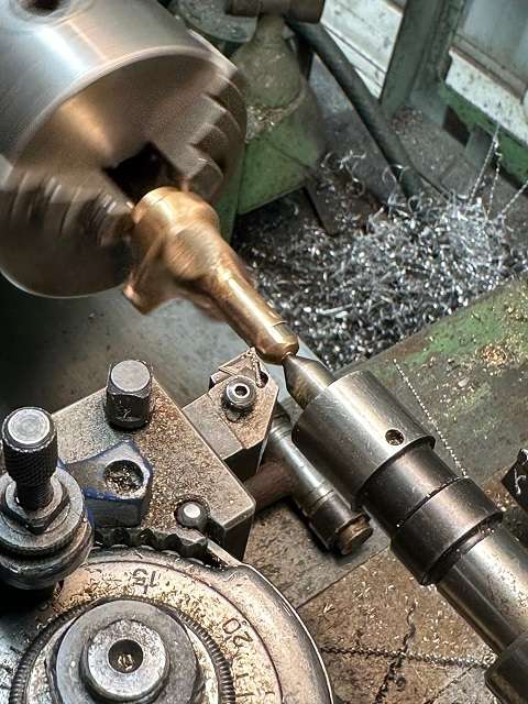

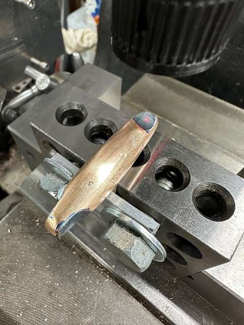

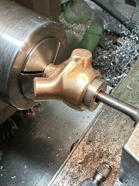

Moved onto Timing Lever. This is a small brass casting which is quite awkward to hold. First it was cleaned up with a file and sharp edges removed. Could not hold it my standard 3 or 4 jaw chucks used on the Myford, but I have a Myford spindle adaptor to be able to fit my M14 x1 threaded chucks from the Cowells lathe. The best option I found was the self centering 4 jaw but I still needed something to space it away from the chuck to leave face clear to machine. Found a suitable Joey block. I needed to leave this in place whilst facing so couple of pieces of tank tape to hold in place. This was faced on both sides to 0.188” thickness.
If anyone else does this can I suggest you face both sides to a larger diameter than I did. The rear face which mates against the casting was held clear by 15 thou or so and had to be filed and also the inside face needs taking right up to the bottom of the stick out for the timing stud. If you don’t do this you will find as I did that the cam will not rotate. Again, a bit more filing. I started drilling the casting with the Joey block in place and removed it just before the drill broke through. Hole then reamed.
The thin steel sleeve is then silver soldered into the casting. Bit dubious about this but it appears to be held okay but need a bit more tidying than I had hoped.
With the sleeve silver soldered in it was then possible to fix to a 3-2-1 block and clean up the top and sides of the boss on the casting through which the small insulation bush and contact stud are mounted.

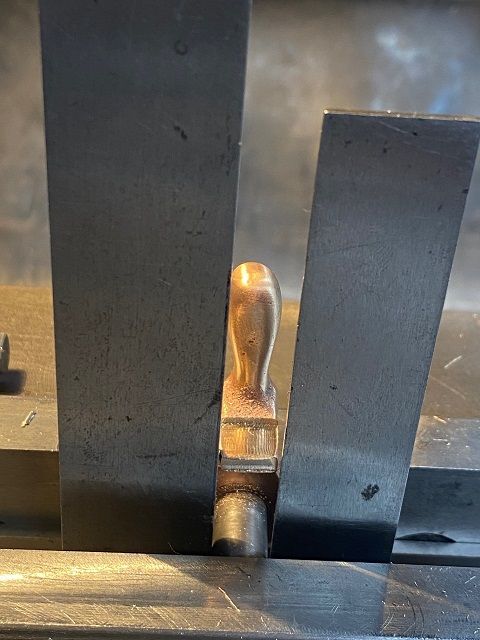

Aligned ready to drill and ream using two squares.
The oilite bush was shortened and then pressed into the timing gear. The insulation collar which is a firm press fit on the boss on the timing gear was next. I found I had some 1.004” diameter nylon/plastic bar and this was quickly made and the edge drilled for the ignition stud. Pressed this on the gear with the two holes aligned and then tapped the ignition stud into place. This passes through the collar and the boss on gear and is in contact with the oilite bush. I still had the soft jaws in the big lathe so returned gear to soft-chuck and then skimmed the proud edges of the ignition stud. The cam came next. I had to thin a piece of steel down to the required 0.188” t hen left it setup in the vice whilst marked out the cam.
The centre was then bored out. The steel then removed and excess cut off. Then used mill to bring down to within 1/16” of scribed line. Then used the die filer for its first proper job and shaped the cam. Back to the mill and centred on piece of bar then drilled and tapped 4-40 UNC for locking screw. This fits directly on the oilite bush.

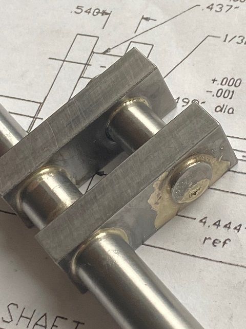

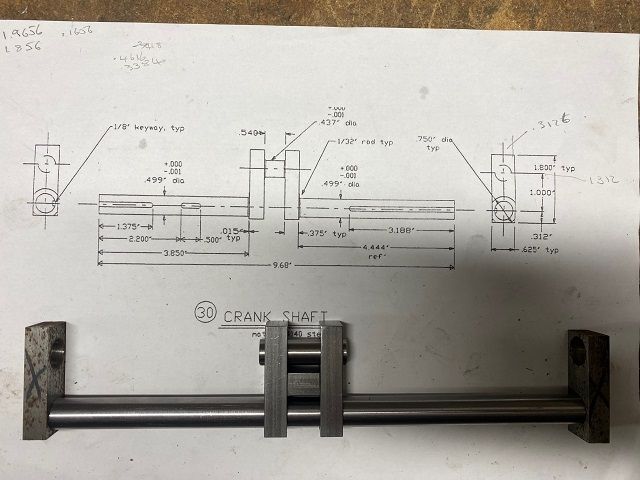

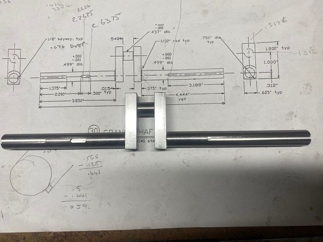

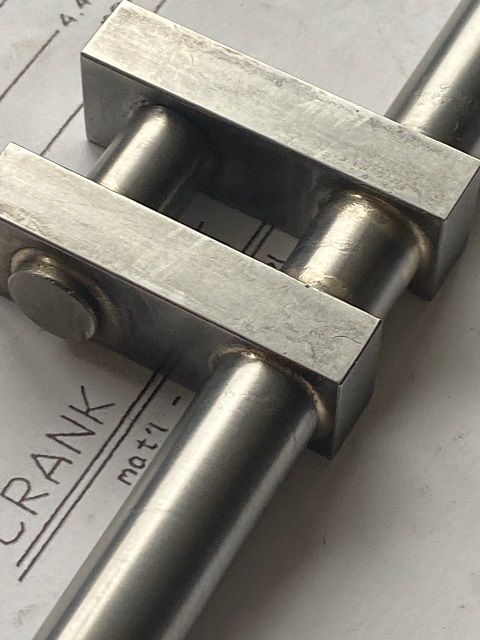

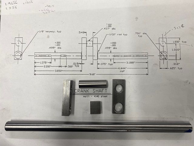

Decided I now had to bite the bullet an attempt to make the crankshaft. Two pieces of steel 0.625” x 0.375” by 2” long were cut and then super glued together. Into the mill and squared off and faced to length. Crank and big end centres marked with centre drill then drilled through in increasing sizes till just short of the required 7/16” and ½” diameters. Both holes reamed.
Crankshaft form PGMS cut to length and centred, big end cut around 0.125” over length. I also decided to make a spaced block from same material as the crank webs 0.540” thick. This used to ensure the two webs could be pressed against each other and keep correct spacing.
I had a spare pair of webs which had come with the engine so I reamed out the 1/”2 diameter hole and used these as supports for the outer ends of the crank shaft.

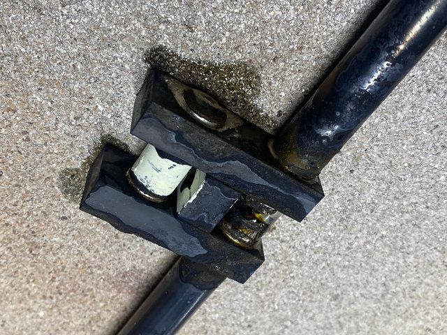

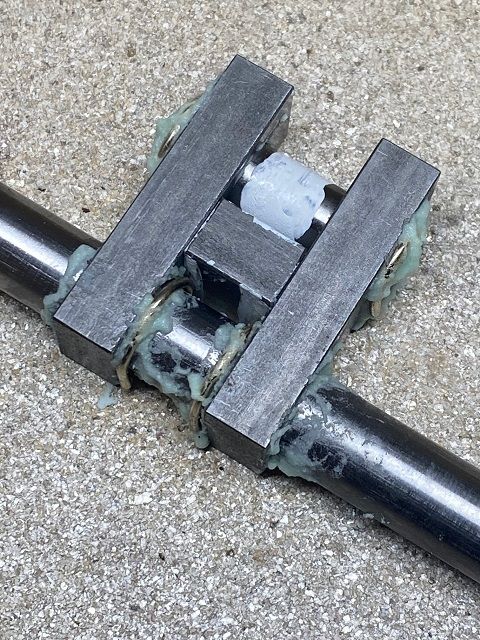

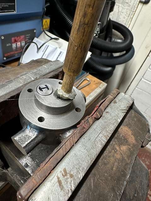

Now to the silver soldering. I first rang Graham Corry from Alyn Foundry and had a chat to him about silver soldering and then reviewed a video he had sent me a few pages back.

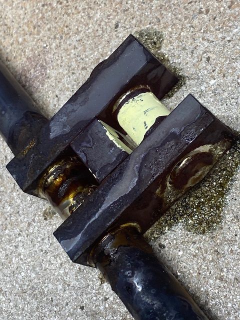

I set up the hearth on my wooden bench in the garage and put some heat bricks around the outside for extra protection. Cleaned all parts with acetone. Using HT5 flux I pre-fluxed the inside of the webs and slid them on the crank and big end. Slid them along to close to final position I then painted the made centre of big end with Tippex to prevent solder adhering here. Little more flux in all the countersink areas. Then cut 2 off 1” and 2 off 1.5” length of 1.5mm silver solder. These were then curled up into ‘C’ section shape and one put on each outer end of the big end and the larger one on the inside of each crank webs on the actual crankshaft. This was followed by bit more flux on each to hold in place.
Final check that the webs were in correct position and tight against the spacer, correct length of crank sticking out, ensuring the spare webs were on the ends of the shafts and all was ready.

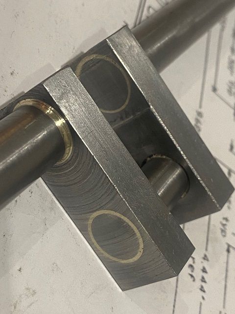

Fitted the big burner to the torch and started by preheating the ends of the shaft and gradually moving towards the centre. I had turned the light off above me and could slowly see the colour changing. The flux was bubbling and changing so I now concentrated on the webs, big end and the inner section of the crank and suddenly it happened. The solder melted and did its stuff much to my amazement. I though I could see one slight gap so dabbed fluxed rod on it, looked okay so turned off heat and went and had lunch.
After lunch all was cool, looked reasonable so into jar of citric acid now for overnight and have proper look tomorrow.
All looks like the solder has all flowed to where it should and minimal amounts where it shouldn't so you won't have much to clean up
Jason,
Thank you. I’m hoping it is all okay. Will leave in pickle overnight. Hopefully it will not need too much cleaning and isn’t warped. It’s my first proper attempt at silver soldering so reasonably pleased so far.
Colin

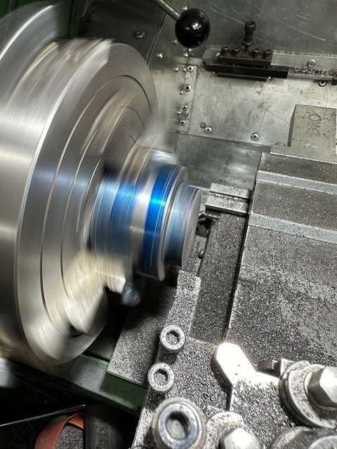

Into 5C collet chuck on Myford and the big end stick out faced flush to the webs.
Moved over to mill to remove the centre after first having hacksawed the majority out.
Final Result

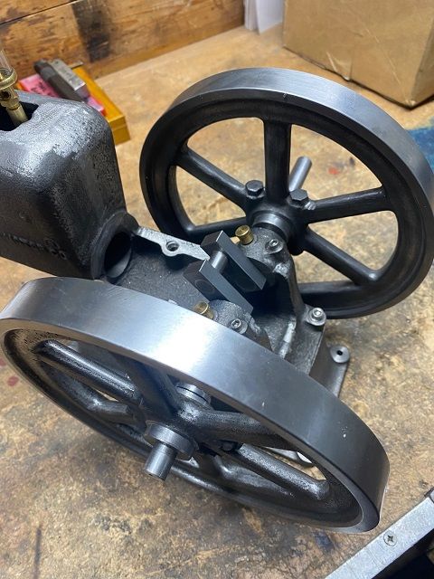

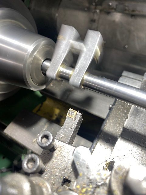

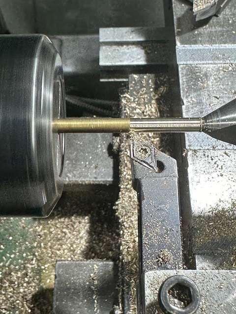

Whilst waiting to get mill DRO sorted jumped across to Colchester and turned the Governor Arm Shift Collar. I had correct size material in stock so just had to grind a 0.130” wide tool to cut the grooves. It actually worked quite well.

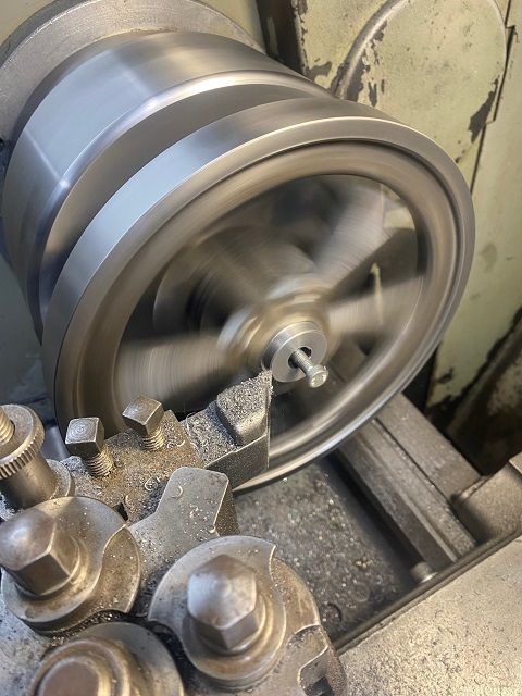

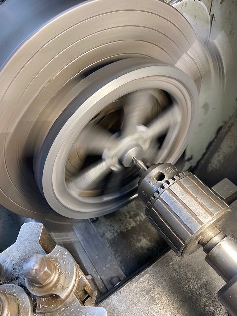

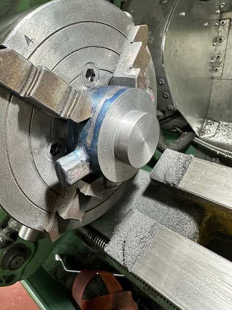

With the castings I had received one partially machines flywheel casting and one unmachined casting, both with many years of rusty brown colour on them. The machines one had the perimeter, sides, and bore completed. I needed to clean this up first to check on dimensions. It came up very nicely much to my surprise. The other casting looked quite rough around the perimeter and one boss was a little offset to say the least, but the spokes were very good with no movement of the two haves of the mould. Craned the 12” four jaw onto the lathe and proceeded to spend at least an hour trying to get the casting level and central.
Used carbide tipped tool to get underneath the skin and took the face down to dimension and then faced the boss. Boss then centred and drilled in steps to 0.4688”.
Could only get a very small boring tool in and very slowly bored out to 0.5”. Could now remove from the 4 jaw chuck and switch back to the 3 jaw. I had made a mandrel from a 0.875” piece of barstock and turned to 0.5” sand threaded the end ½” UNF and also centred the end. I hoped this would be solid enough for turning the perimeter. It ran true and I was able to take the perimeter down to approaching size but there was quite a dip on one edge. Before I went any further, I brought the side to dimension to reduce the area of the dip. Had I continued as I was I think the flywheel would not have tidied up until below size.
I could now compare the two flywheels and decide which to use on which side of the crank. The original one was to be on gear side and so this went onto a expanding mandrel to finish of the bosses to correct diameter and length. The other flywheel then mounted and bosses bought to size.
Both flywheels polished up well and the engine now looks a little more like it should.

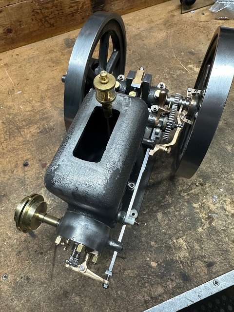

You look to be making good progress Colin, my drawing didn’t mention silver soldering the bush to the sleeve it just buts up against it.
Any way now I have sparks ( see John Purdys Red wing post) I just thought I’d see if we had life. So I spashed a bit of petrol in the plug hole and after a few spins it fired up for a couple of turns. So I rigged a temporary fuel tank up and after a fair bit of adjustment to the mixture screw it fired up and ran ok but it was tricky setting the mixture.
As I was happy with the ignition timing I rechecked the valve timing and it was out so I set it as specified and pinned the cam. I think the cam had moved.
After a bit of trial and error I’ve found the best position for the mixture screw and it starts easily and runs very smoothly. I ran it without any water as I’m waiting for the oiler kit and even after ten minutes the cylinder was just warm .
I just need to sort out the correct nuts and bolts, finish the fuel line, tidy the wires then paint!

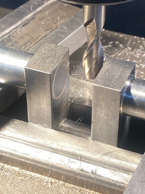

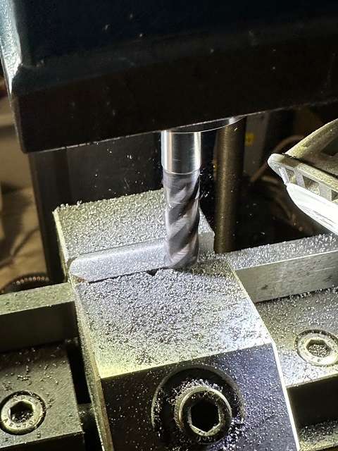

The keyways on the crank are 0.125” wide and 70 thou deep. Used a short 0.125” slot mill and ran it at around 2000rpm. Did three 20 thou deep cuts followed by 10 thou cut. Pleased with how this went.

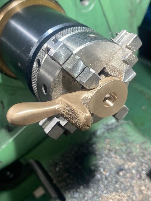

Governor Bracket was next on the list and this was a bit of an awkward thing to hold. After a bit of clean up I managed to get it held centrally in small 4 jaw chuck and then drilled it out to 0.5”. Then mounted it on a slit arbour to machine the rear face and main diameter. Turned it about face to bore the inside face and the bore between the ears for the governor shift collar and then the 15 degree angle on the back of the ears was next. At some point I realised I had a minor issue. The interrupted cut was moving the bracket along the split arbor. I had to stop and make a new slit arbor much shorted, a better fit and with a M6 grub screw in the centre to keep it out of the way of the boring tool.
Decided to drill and ream the holes in the ears for the governor arms prior to milling the slot in the ears. Mounted on a 1-2-3 block and set it up square. I could not pick up on the bore diameter as I had a bolt through it so used the laser centre finder to pick up edges of the base and halved it. The holes drilled and reamed without any issues.
1-2-3 block then turned through 90 degrees to machine slots. The downside of using bolt and washers to hold brackets to 1-2-3 block was the inability to mill across in one go. Did each side at a time and was careful not to run the cutter into the steel washers. The other downside was that I could not drill the two 4-40 UNC clearance holes for the fixing screws. Removed from 1-2-3 block and sat it on parallel between pair of ‘V’ blocks and again used laser centre to pick up outside edges of the ears and get it square. Used 0.5” diameter drill blank to pick the center. Drilled both holes and then found 82 degree countersink to countersink the two holes. Because of the way the casting had been done the countersink covered two different heights of the base and so looks a bit unusual.
The brass casting needed a bit of cleaning up afterwards with riffler files.

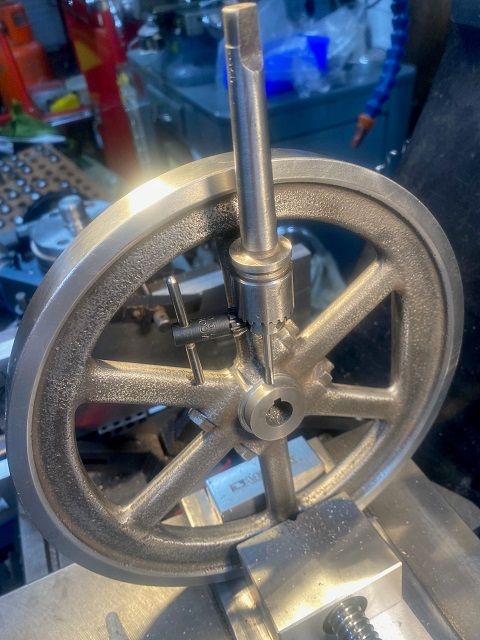

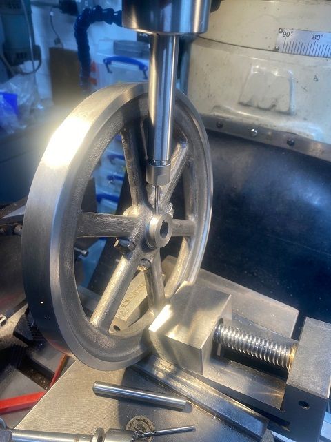

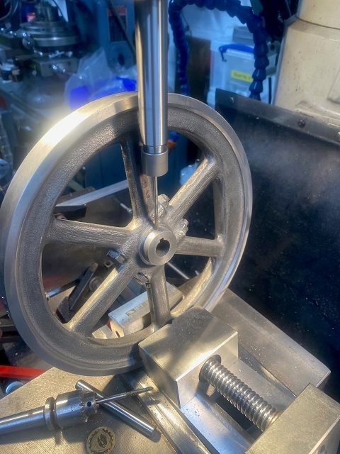

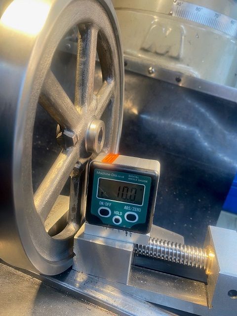

Moved onto the timing side flywheel and mounted this on large arbor and mounted it vertically between pair of ‘V’ blocks. Rotated flywheel to get the two slot positions along the X axis. Picked the centre up using coax centering device on flywheel boss.
Offset each side of the centre and drilled 0.125” hole as a guide for the slots. Then offset either side of centre on the ‘Y’ axis and drilled and tapped the 4-40 UNC mounting holes for the governor bracket. Flywheel then move to bench vice and the two slots cut with hacksaw and then filed to dimension.
Ideally I wanted a pair of grub screws in each flywheel to bear on the key, but there is just not enough room on the governor bracket side of the one flywheel, but on the second flywheel this was possible.
Flywheel was stood vertically in a vice and ensued that the keyway was uppermost and the flywheel spokes were aligned vertically. The smaller vice then put in jaws on main vice and magnetic angle gauge used to set the flywheel at 10 degree angle.
Used 0.5” drill blank and edge finder to find centre and set DRO to zero in both axis. There was no way to get a drill chuck in but I did have an ER11 long parallel arbor. This was used to hold 2.9mm drill. Double checked alignment by sighting drill in front of keyway and when happy moved to location of hole and drilled through casting.
Removed drill and replace the collet and inserted 6-32 UNC taper tap. Put spindle into neutral and turned spindle by hand to tap hole.
Then ran a bottom tap through hole using Jacobs No. 0 check to hold it.
Repeated this exercise for the three possible holes.

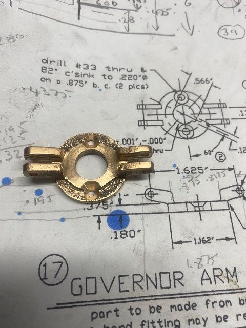

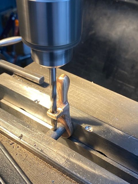

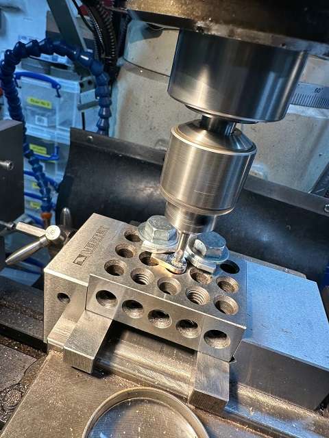

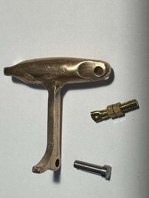

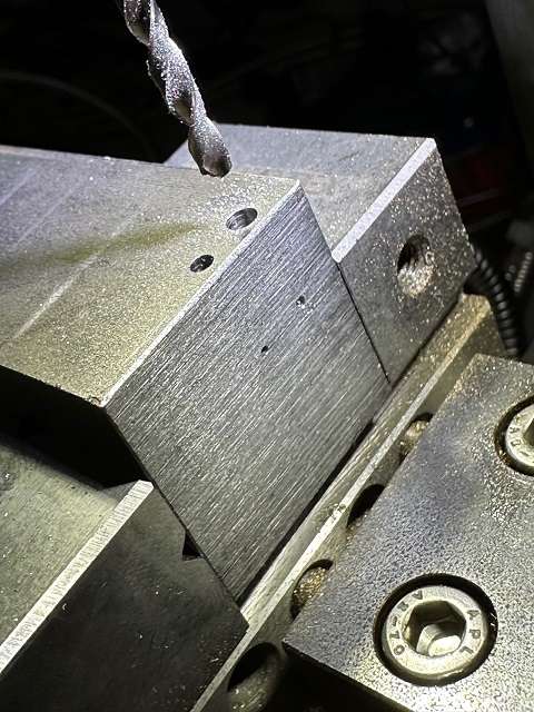

Then moved on to the Governor Arms. These are quite awkward bits to hold, one colleague suggested soft soldering a block onto the weight portion in order to be able to clamp it in vice. The casting was quite a bit thicker and needed to be thinned down quite a bit. In the end I fitted it to my small jig plate. It was placed on a sacrificial aluminum plate and up against two 6mm dia dowels located in the jig plate. It was then clamped down firmly with a small piece of aluminium between the brass body and the clamp. I ensured the arm was parallel to the jig base. This was then mounted in the vice on the Cowell Mil and a long series slot mill used to thin the sides down. There was some flex in the arm and a number of spring passes were taken until arm was parallel at 0.125″. This was then repeated for second arm.
The next task was to mark out for drilling. This was a fun task. It appeared that the casting was accurate enough that when laid on the surface table the arm was parallel to the surface table, so out with the Marking Ink and scribe lines all over to give the hole centre and the correct dimension of the arm in the other orientation, and also the locations for tensioner bolt and springs. Repeated for second arm. Arm then clamped down on 123 block with required hole location over a hole in the 123 block.
The 123 Block was too big for the Cowell Mill so migrated to the Bridgeport clone. Used the laser centre finder to pick up hole centre (forgot about my optical centre). Hole then drilled and reamed 0.125″ (1/8″). Block rotated in vice, whilst still aligned on center position and hole drilled for end of spring (1/16″).
Block rotated again and the location for the spring adjuster found and then drilled/reamed. This again was slightly precarious and needed and adjustable parallel to support the end of the bob weight whilst drilled/reamed and slight counterbore. Repeated again for second arm. No picture for this.
The pivot end of the Governor Arm now needs to be filed to shape. This is basically a case of filing, fitting to Governor Arm Bracket on the flywheel and testing the fit/operation. Eventually ended up with both arms operating the Shift Collar. Great I thought, so fitted to the crank and rotated. the flywheel. The pivot ends foul on the Latch Out bar. Then realised that the pivot ends needed to be radiused down to 0.125″ (1/8″). It would have been easier possibly to make a filing button to help with this. Instead I swung the arm suspended on a 1/8″ diameter bar resting on a pair on 123 blocks, blued up the arm and used height gauge to scribe the radius on both sides of the arm. Repeated for second arm and then spend happy hour or so filing to shape. The picture shows the arm with scribed lines on the right and the fully filed item on the left.

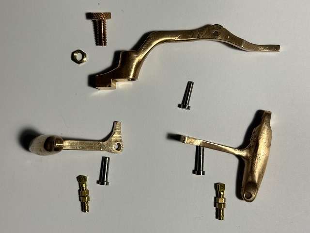

Next picture shows one arm with its mating parts.
Next picture shows both arms and Latch out Bar.

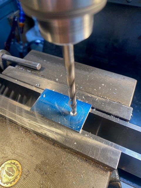

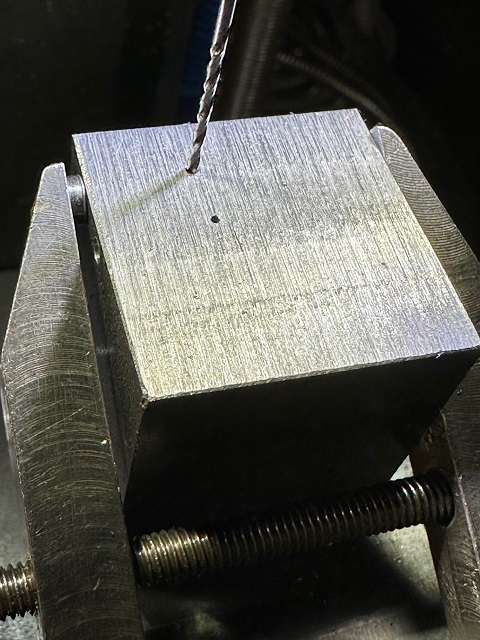

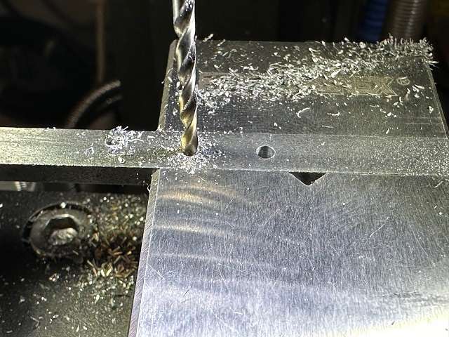

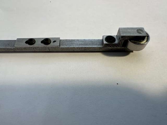

The Push Rod Guide plate is a small casting, this was cleaned up with file and then the two sides milled down to clean them up. Milled face down to 0.150″, Drilled two fixing holes whilst supported reasonably in the vise, then took down to final 0.12″ thickness.

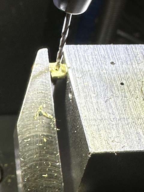

Started with the Push Rod bar, seemed quite hard to drill, one hole 0.125″ (1/8″) for the pivot pin and the second hole for the fixing screw should have been 2.35mm for a 4-40 unc screw. I did not have a 2.35 so opted for a 2.3. Came to tap it and could not get more than 1 turn of the tap and could see the tap twisting.
Stopped and went to the pub. Whilst talking to my mate we both realised it was a length of key-steel we had bought from a business that was closing down (we in fact brought all their stock). Back home i put it in the kiln along with a couple of small castings and cooked it at 800 degrees Cent for a short while. Next day it was certainly easier to tap. Note to self – buy 2.65mm drill.
This was done on the small Cowells mill in the warmth of my office. Followed this by drilling the two 2.1mm holes for the 3-48 unc screws holding the Push Rod Plate.

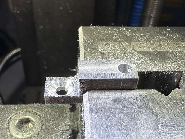

The Push Rod Keeper was cut from a 1.75″ x 1″ piece of .250″ thick plate. Sawed it down a little smaller the into vice on Cowells Mill. I had a 6mm Carbide end mill close by and used this to gradually whittle down to size. Then drilled 2.9mm (should have been no.32 drill but I do not have any) and countersunk for fixing screw. At the same time i drilled the hole for the pivot pin all the way through as I was not looking forward to holding the 0.1″ thick bracket whilst it was being drilled after I had milled down the opposite side.
I had great fun trying to find suitable height material to act as a parallel so as to keep the material well held in vice but still able to mill down to 0.1″ thick. Again very careful use of 6mm carbide end mill.
The Push Rod Keeper was fixed to the Push Rod Bar and clamped in the vise and 0.125″ (1/8″) reamer used to ensure holes were aligned with one another.
Because I was using a ball bearing race rather than a solid cam follower I had to deviate rom the plan for the Pivot pin. This was a simple turning job.
The final bit is the Push Rod Plate and this needed to be 0.048″ thick. Hunted high and low through stock to find suitable material and finally came across a flat grinding wheel cover which was 1.25mm. Hacksawed a piece out and by time I had polished the paint off it came out at the requisite 0.048″.
This was a difficult thing to hold in the vise. In the end used a set of Starret adjustable parallels with a piece of sacrificial brass on top of them. Drilled the two holes at the end of each slot and then used a 3/32″ slot mill to clean out the slot and open to the required 0.110″.
The various parts shown below.
And assembled.

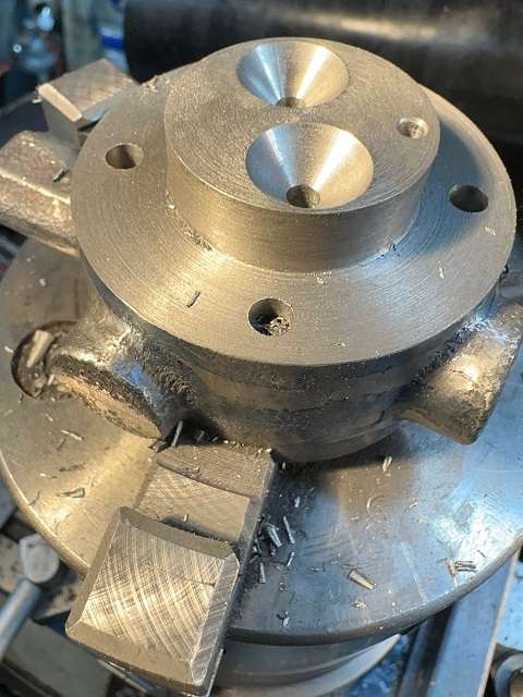

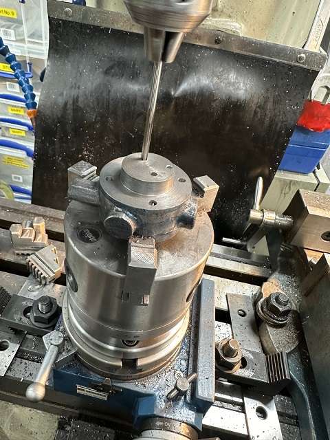

Cylinder Head casting into four jaw chuck and centered up, centre boss turned to diameter and depth.
Head then moved over to Rotary Table on mill, centered up on the boss and then the DRO’s circle feature used to drill the head stud holes, the valve guides and the decompressor hole.
The guides were then reamed to size prior to cutting the valve seats. I had purchased a nice new Osborne cobalt 90 degree countersink cutter to do the valve seats. I used a piece of emery underneath the cutter to prevent any chatter and this worked perfectly.
When I purchased the casting I was given a pair of valves. The first one lapped in okay but the second had a good wobble. I went down to my mate with his Hardinge lathe and we used his expertese to get it straight.
The spent some time lapping the valves in. Various ways had been suggested to do this, but inthe end I opted for old fashioned wooden stick and sucker. Well not actually a sucker but used a hot glue gun to fix the wooden stick to the valve head. It worked reasonably but came unstuck every so often. Next time I do anything like this I will put a small screwdriver slot in top of valve. Based on all experience grinding valves in on cars I preferred to used a back and forward rotary movement and push down on the valve.

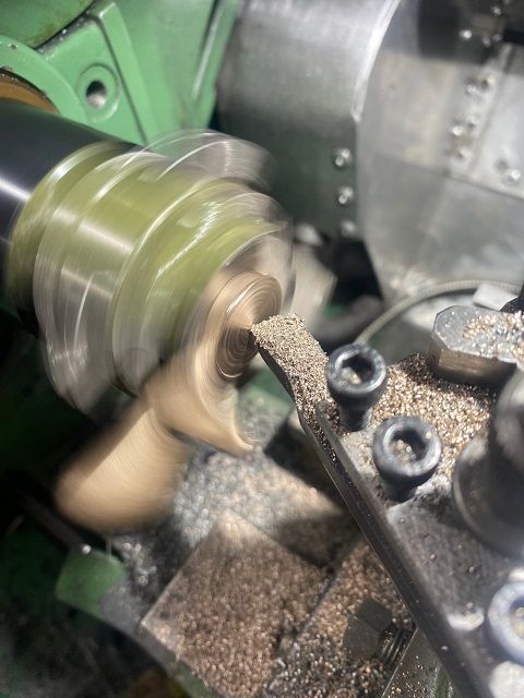

The Fuel Orifice Cap casting was first on the list. This was put in 3 jaw chuck and the end to be threaded turned down to 0.6″ diameter. This then set up in hexagon collet block and moved to mill and the six cast faces machined to give 11/16″ AF size.
Back to the lathe and turned down to 0.5″ diameter. A decorative groove put in the hex and a thread relief groove cut, faced to length and die used to put 1/2″ x 26 BSB thread on the end. This was then checked for fit using the previously threaded main casting.

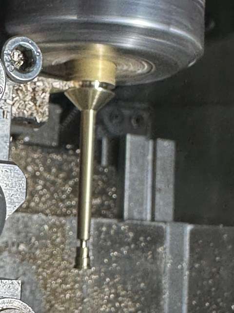

The fuel union was a standard purchased item with 1/16″ x 27 NPT thread. The Needle Valve fitting was a piece of 3/8″ brass hex with 5/16″ x 24 UNF threads each end and a 6-48 threaded hole through the centre. I had to deviate slightly here as I did not have a 6-48 tap or die so opted for 5BA.
The valve was from piece of brass with 0.122″ stem and a 45 degree valve seat and a 0.430 diameter head. Chucked brass up in collet with short stick out and put a centre in the end, then extended out of chuck and supported end with half centre. Turned to the 0.122″diameter
and then cut the valve seat and parted off.
