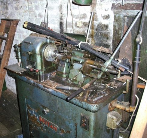

                                At work, sitting in the garage we have an old Britan. We (well it would have ended up being me, inevitably) were going to do it up, with a view to making some small parts on it, but somehow I don't think we're ever going to get around to it. This particular example hasn't been run for a long time, but looks fundamentally sound. At the moment, I get the impression that the boss would be prepared to part with it, as long as we don't lose any money. If anybody's seriously interested in making an offer for it, send me a PM and I'll make enquiries and take a few pictures. It's in SW London, and you'd have to move it yourself. And now, because of holiday closure, it wouldn't be until September at the earliest.

                                  I've just remembered that I have a picture of it in its previous location – gives you some sort of an idea:
                                  Britan repetition lathe

                                    Steve: Interesting picture; I guess the key questions are what collet capacity and how much tooling is available? For anybody thinking of buying, and moving, a Britan, it's quite a small lathe. I measured the footprint of mine at roughly 38" by 24", weight about 1000lbs I'd guess? So, easily moveable with a car and trailer.

                                            I'll have a look in the morning at the collet capacity. It certainly has some collets with it, but I don't think there's much tooling other than what's currently fitted. Yes, it's relatively easy to move on a trailer – that's how it got to where it is now. What's not quite so easy is lowering it through a large hole in the floor, which is what we had to do first – that's a picture of it on the first floor!
