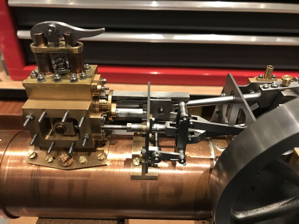

                  #398657
                  Brian Abbott
                    @brianabbott67793
                    Quick update on the Minnie progress.
                    Motion work complete at long last.

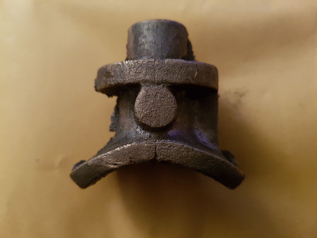

                    #398730
                    Brian Abbott
                      @brianabbott67793
                      Moving on..
                      Want to make a start on the chimney saddle, ordered a casting but not really sure where to start.
                      I’m ok with the machining, I am unsure what to do with the finished cast surface.
                      The casting has the usual flash and burnt on bits, anyone got any work on progress pictures of this part ?
                      Thanks.

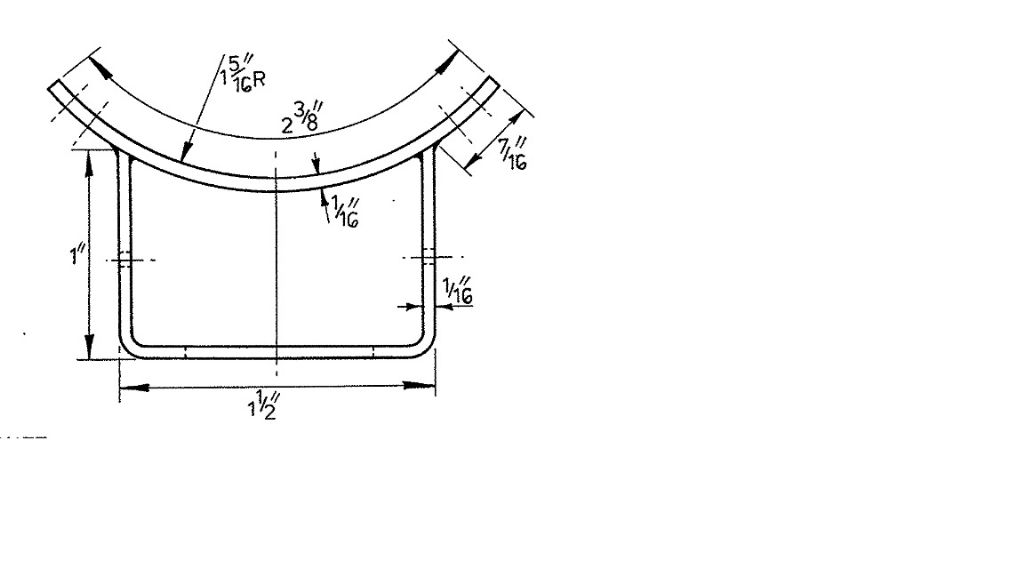

                      #403167
                      Brian Abbott
                        @brianabbott67793
                        Hello guys, after some more advice.
                        Whats the best way to form the curved piece of the perch bracket to match the smoke box ?
                        #403181
                          Clamp by the chimney flange to an angle plate or if you still have the chucking spigot then that can be held in a collet block so the part is on it's side. Then use a boring head to cut the concave surface.
                          #403193
                          Brian Abbott
                            @brianabbott67793
                            Morning Jason, thanks for replying,
                            Its this bit I'm not sure about, should i try and find / borrow a set of rolling bars or should i just form it round a bar ?
                            #403202
                            Paul Kemp
                              @paulkemp46892
                              I have not built a Minnie but looking at the thickness it should be quite easy to pull that round by hand. Technique I have used for similar parts in the past is to set two round pins vertical in the vice, say a couple of bits of half inch round bar for that job, just over 1/16" apart, put the plate between them and gently curve round by pulling it and checking against the smokebox as you go. I have made tyres this way from 1/8" and thicker quite satisfactorily. You might want to clamp it on to a filed plate edge on in the middle though if you silver solder the bracket on though as it's likely to change shape when you heat it!
                              Paul.
                              #403226
                                Sorry Brian, read it too fast this morning.
                                From memory when I did mine I bent it on the end of a longer strip around some bar that was a bit smaller diameter than the smokebox maybe 2.5" dia to allow for spring back.
                                I have sinced used the 3 pin method that Paul describes to bend metal and that works well too, just work along in small increments to get a steady curve

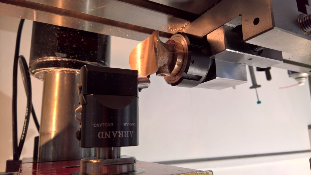

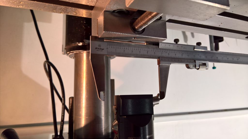

                                Raymond Griffin
                                  @raymondgriffin40985
                                  wp_20171112_16_34_19_pro.jpgwp_20171026_16_38_22_pro.jpgHi Brian,
                                  I attach a couple of photos to show how I did mine recently. The diameter of the cut was established using the method shown. The support was bent around a metal bar. You will need to turn your computer screen around to get the photos upright. Sorry, but no matter how I upload my photos to this site they come out, the wrong way up. Pleased to hear that you have completed the motion work. I am struggling with mine.

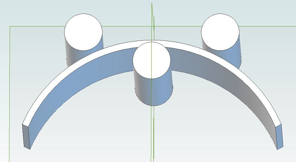

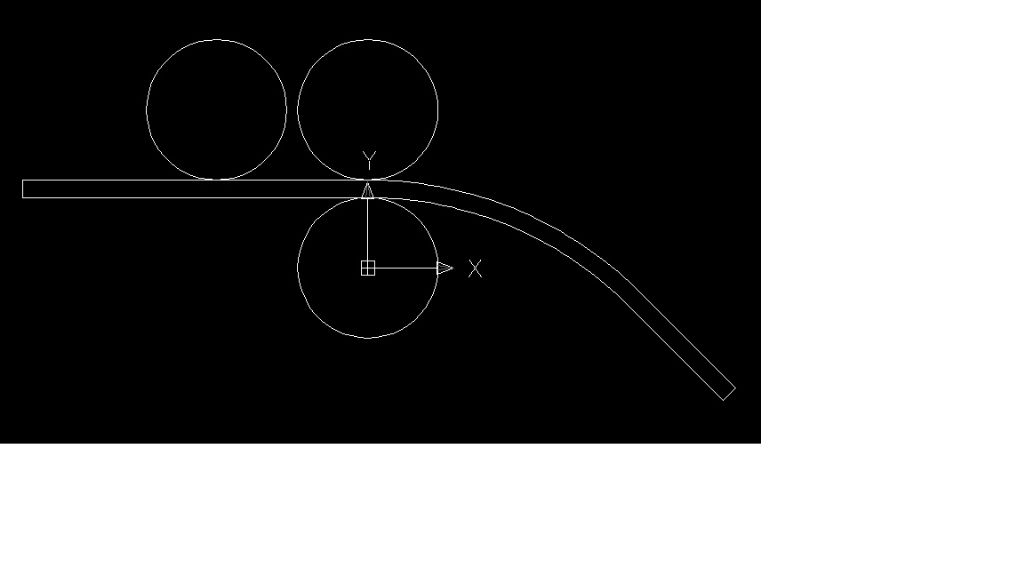

                                    #403254
                                      No three pins like this, in effect you are mimicking a pyramid roller but just squeeze the work and then move along say 1/8" and squeeze again. The photos above used the Vee block edges as the rear two pins and the bit of brass as the third but the edge of the vee block does leave a mark.
                                      This is the sort of thing.

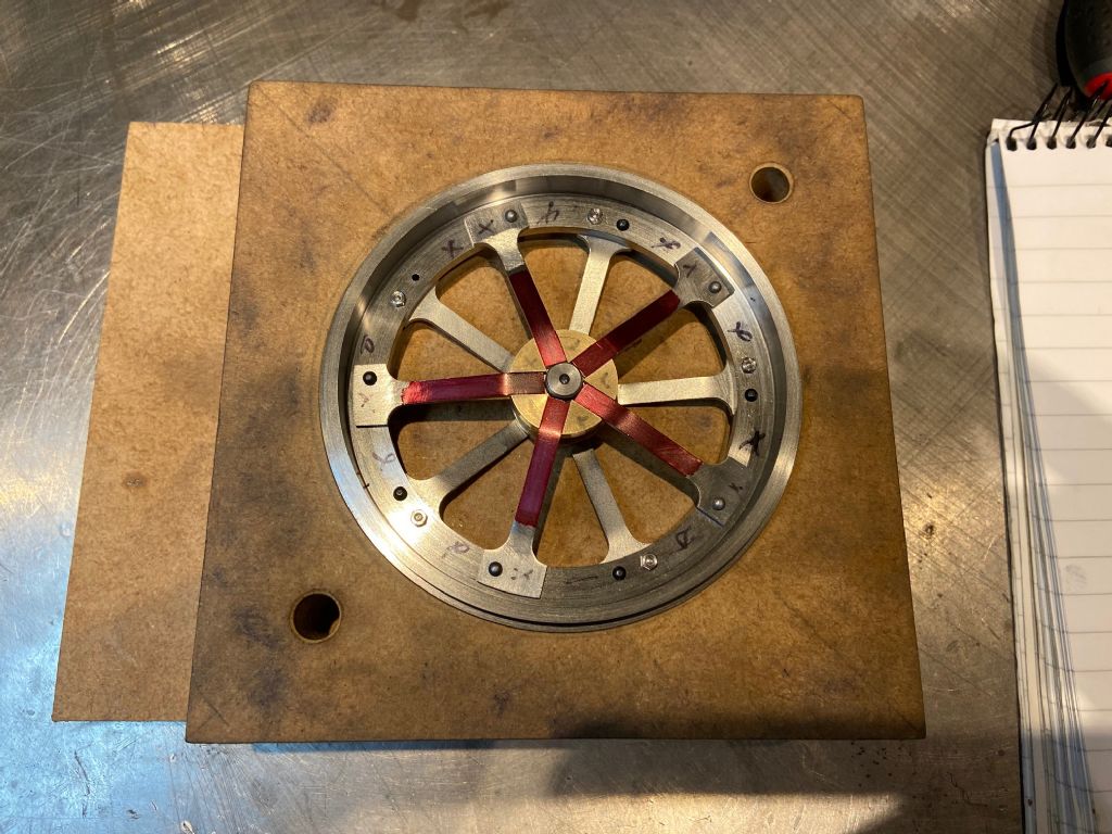

                                      Brian Abbott
                                        @brianabbott67793
                                        Hello all.
                                        Bit stuck and i need a little help.
                                        Just starting making the parts for the front wheels, looking at the drawing the hub looks to be offset to the center of the wheel but i cannot see a size on the drawing, anyone any idea ?
                                        #430052
                                        Richard S2
                                          @richards2
                                          No Offset Brian. Central part of the hub is central to the rim width, so you can make the Wheel build jig where the wheel just needs to be turned over to set the opposite spokes (unlike the rear wheels).
                                          What I think you may've noticed is the licence of the drawing not showing equal widths of the outer covers before the inner one starts to taper down?.
                                          The inner cover provides 3/16" additional spacing each side on the front track width.
                                          Can't offer pics, as I modified those inner covers on mine.
                                          Regards.

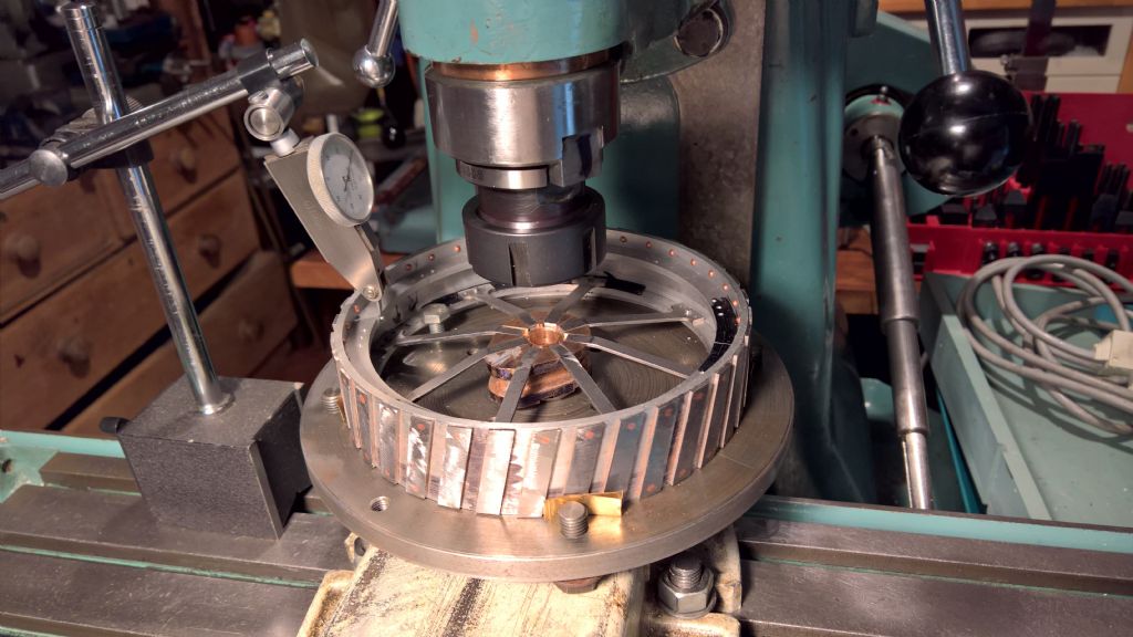

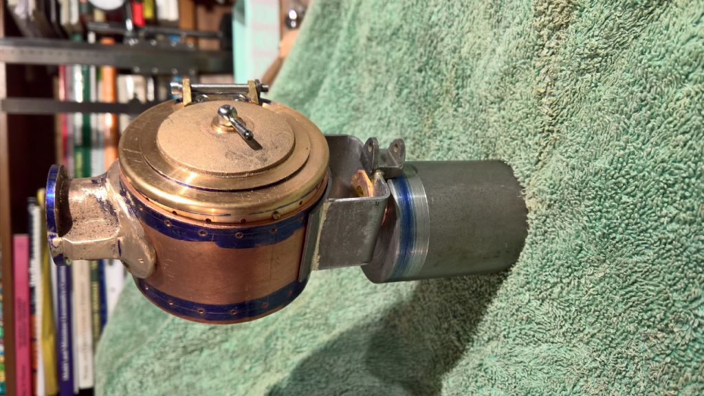

                                                  #438226
                                                  Raymond Griffin
                                                    wp_20170504_14_43_38_pro.jpgHi Brian, I was worried about flux residues causing corrosion when making wheels for my Minnie. I decided to use JB Weld resin. The long setting time allowed me to ensure that everything was correctly placed. It worked well, and I can see no advantage in using solder. I add a photo of my rear wheels during construction. The wheel is mounted on a flat, circular plate that could be rotated around a central spigot.
                                                    Have you managed to set the valve sequences on your Minnie? I am finding it very difficult and tiresome as the eccentrics are not easy to manipulate.
                                                    Cheers Ray
