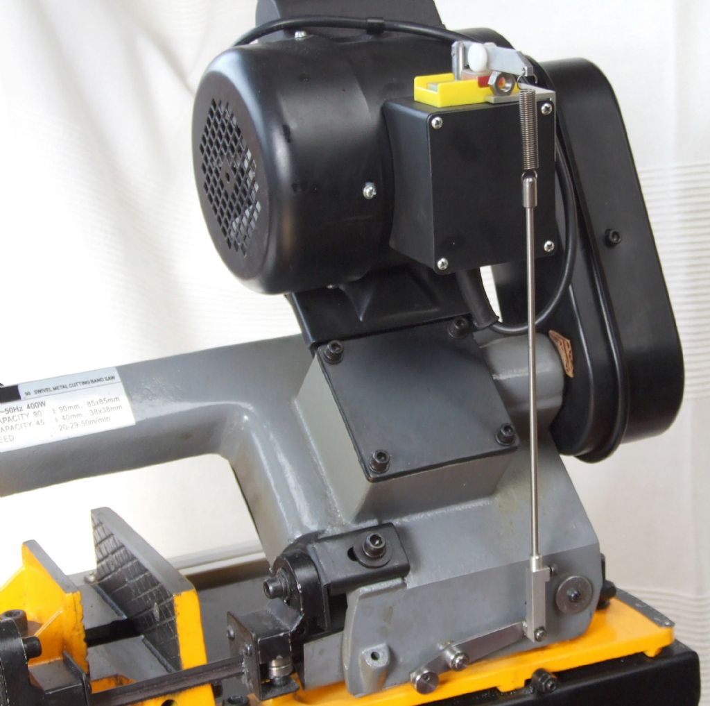

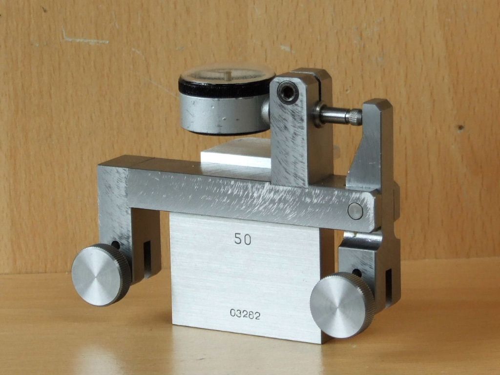

                                              Graham Meek
                                                @grahammeek88282
                                                Here is the bandsaw blade tension device I made. It has been heavily "Meekised" from Jacques design to make use of a smaller dial gauge.
                                                I have also added a photograph of the modification that automatically cuts off the power when the saw is through the metal. This has been described in EiM and Home Shop Machinist over the past few years.
                                                Regards
                                                Gray

                                                    @ega
                                                    Gray:
                                                    I assume that in use the device is clamped to the blade and a side load applied to the latter?
                                                    This is slightly reminiscent of the spoke tensiometers used by some cycle wheel builders; those with an ear pluck the spoke and note the pitch of the sound produced.
