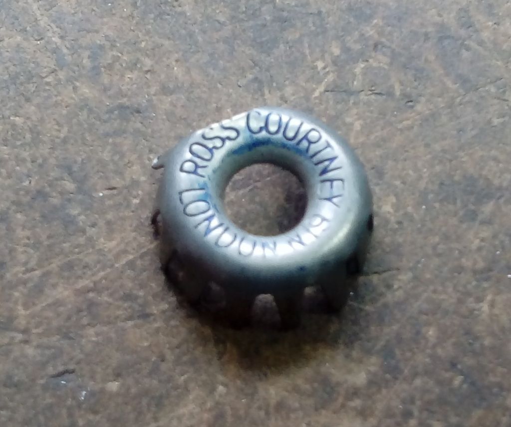

      Hi there, all,
      I have exhausted my stock of a certain type of wire termination and can't locate any replacements because I don't know what they're called! I've done searches both on the web in general and on eBay but without a name all my search strings have been fishing in the dark!
      They're made of brass and have two parts. The main part is a sort of circular trough with lots of fingers. You strip the wire end and form the stripped conductor into a loop that fits into the trough. Then you put the other part, a brass washer, on top of the loop and bend in all the fingers to hold the whole termination together.
      In some situations, e.g. a motor terminal chamber, the common crimped terminations take up too much room but the sort I'm looking for permit a connection free of loose whiskers without the space-consuming crimped shank.
      I seem to remember John Stevenson mentioning these in a past thread but I haven't been able to find it.
      Please can anyone tell me what they're called or, better still, advise a source?

              Ross-Courtney Eye terminations.
              But Ross Courtney is / was a company who make / made many types. ( So it's a bit like 'Tufnol' covers a lot of different items )
              Not seen or used them for ages, used to be common on hot things like the wires from iron elements, thermocouples etc.

                                    Thank you to everyone who has replied to my original post. The Ross Courtney component is the one I had in mind. Thanks to your replies, I see that they are still available but the prices quoted have annihilated my interest!

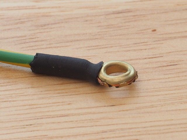

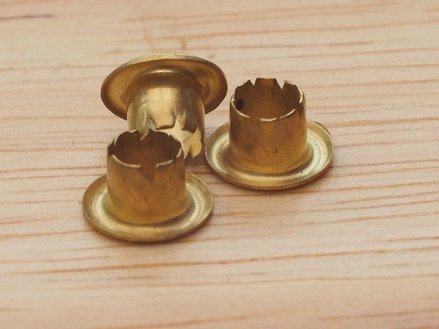

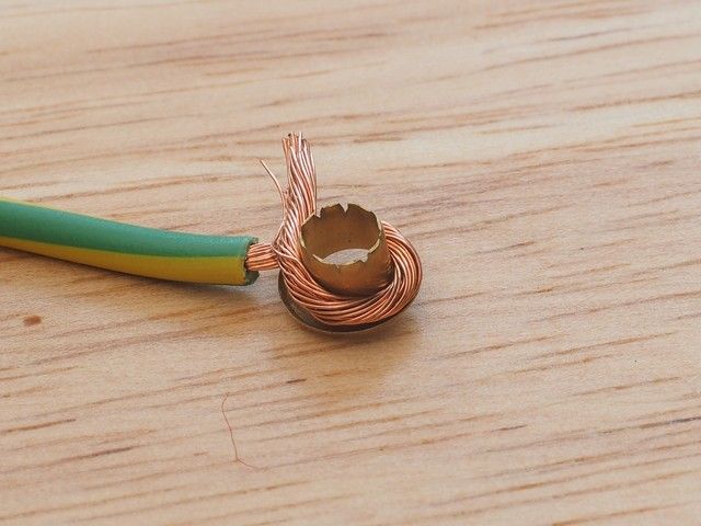

                                      OK Been having a quick play with the sort of brass eyelets that are used in shoes for the laces.
                                      Often available in cheapo kits from Lidl, Aldi, or your local camping shop; normally complete with basic crimping pliers. I think they were £2.99 a set when I bought these for a box of a hundred and the pliers
                                      Wire Prepared ready to go;
                                      Crimped, and trimmed;
                                      Sleeved with a Hellerman rubber boot;
                                      Just a quick try to see the feasibility, but seems OK to me. I guess you could smarten it up further by adding a small brass washer on top of the wire before crimping, but I didn't have one to hand.
