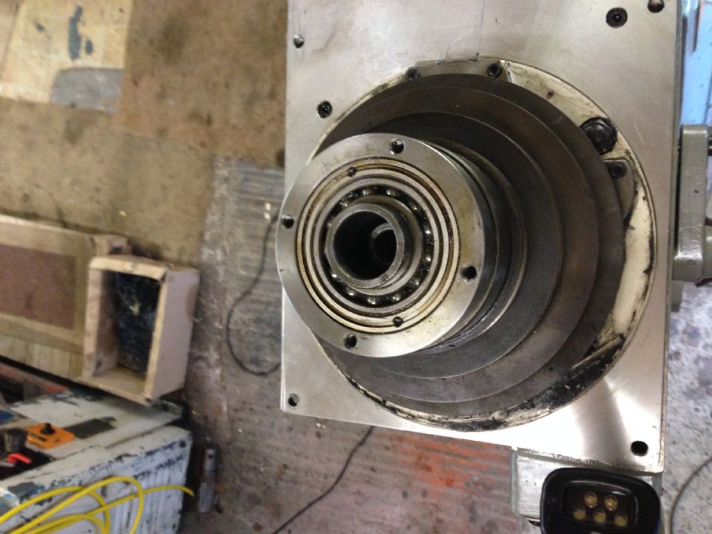

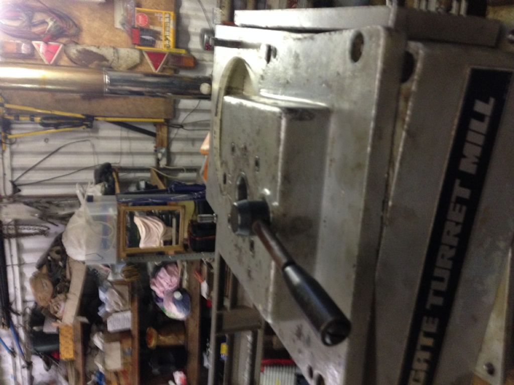

Gate and Elliott were all part of a business group,and products were very similar,the Elliott turret mill had a similar brake which was a brake drum with two internal expanding shoes,similar in construction to a moped brake and about the same size,had to strip mine as one shoe was seized and binding, can't help with the cover as its different to the Elliott
