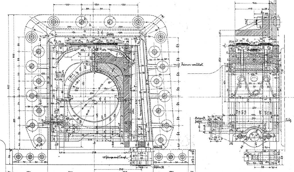

                            I have acquired drawings form the Heba site and started to cad up the locomotive.

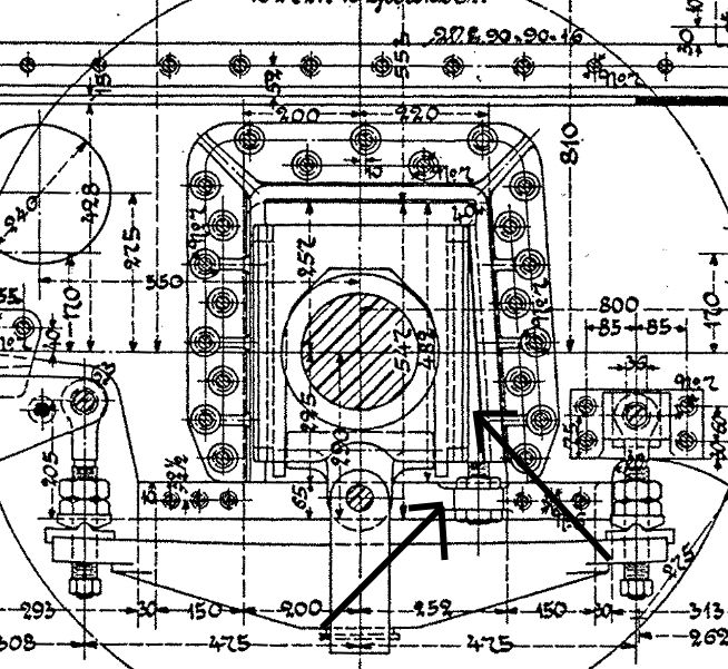

                            I have some questions about the horn block and axle block and would be thankful for some insight into the design. Why the wedge and adjustment screw? Maintanence? take up wear? other?
                            I have attached a picture with arrows pointing to what I am asking about, I hope it is clear enough.
                            #398915
                            murkmannz
                              @murkmannz
                              Also, it is hard to see in the drawing exactly the makeup of the axle block, it comprises of a number of bits. Anyone have more information on the design and purpose?
                              Thanks in advance.

                                The adjustable 'wedge' on the axle-box horn face is to take up wear. I recall that some British built locomotives were fitted with them too.
                                Off-the-top I have no source of detail drawings of DR/DB axle-boxes. Are there any particular issues needing clarification? Panki's forum may be the place to ask, though there are other forums too, of course.

                                  Don Young in the series of articles remembering his apprenticeship at Doncaster Plant was clear about the issues that arose when lowering a set of loco frames onto the axleboxes if the wedges were not firmly fixed.
                                  They rode up and jammed the whole process if it was not carefully carried out.
                                  Just re-read the articles a bit back. Worth a look! ME vols 136/137

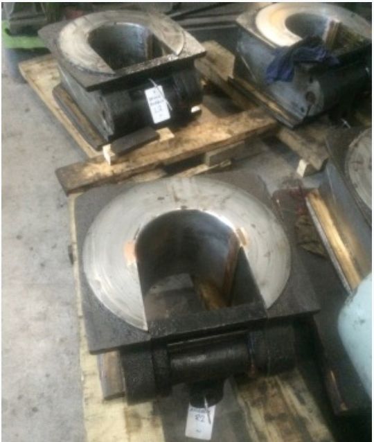

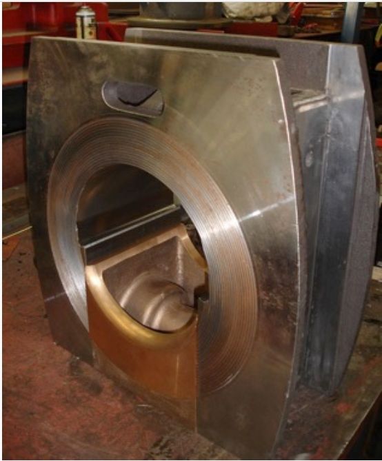

                                    axlebox 2.jpgThanks for the info. Now I have started to search for info on axle boxes I found some informative information and most importantly some pictures (pictures say a 100 words!) . Here was an interesting PDF .
                                    This picture helped me see what I have been reading…
                                    So with this in mind, I will have another look at the drawings.

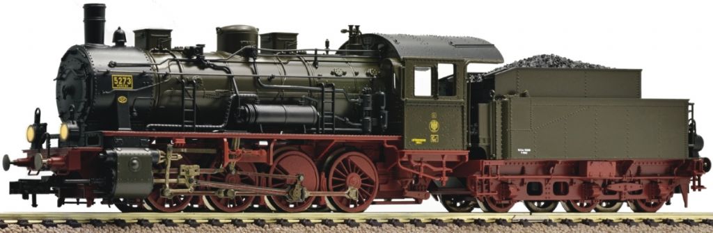

                                      This the loco I want to end up with. I like this one because, 1 the colours and 2 all the auxilaries make it look industrious and interesting. I will be trying to make the model the same.

                                        That looks to be finished in the KPEV colours, don't know if you are aware but there is a lined-out in (off-)red version too. Pic. That pic shows the full extent of the lining as the tender is lined only on sides and not on rear surfaces.  Less good pic here – colours overexposed.

                                          Thanks Phil, yes it is KPEV, I like the one you posted but I guess I am not sure if it is appropriate to paint the number version loco in the lined scheme?
