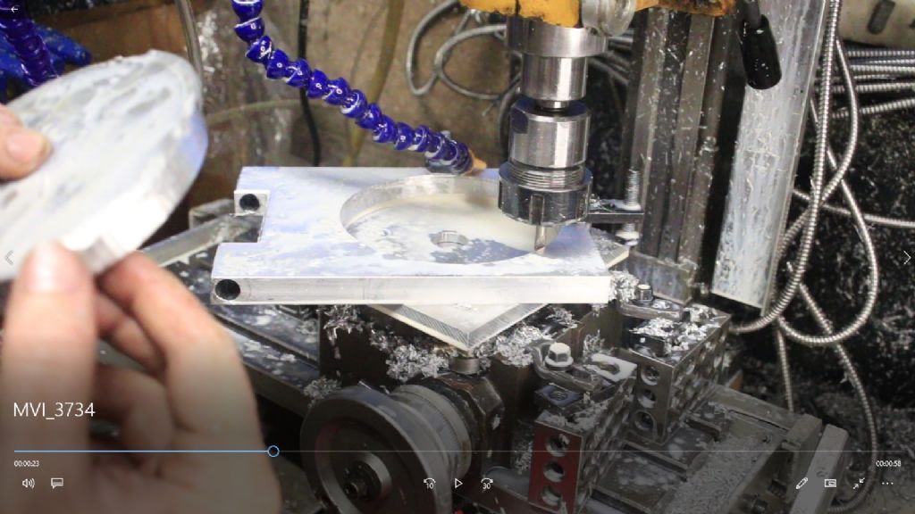

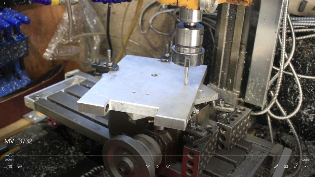

                      old mart
                        @oldmart
                        Funny coincedence that this subject should come up at this exact time. I had a job up on the rotary table and after milling out the recesses at 180 degrees from one another, I decided to increase part of the existing bore using a milling cutter and the RT rather than sticking it on the lathe. The increased part was from 1.6" diameter to 1.7" diameter and about 1/2" deep. I used a 12mm endmill and simply took a small cut into the diameter and rotated the work one full turn. This was repeated about 3 times to arrive at the finished size and the finish in aircraft aluminium was excellent. Aircraft aluminium, I hear you say, well it was part of a Wessex gearbox that I was butchering to make part of an oleo leg support. We support oleo legs at the museum rather than relying on the nitrogen pressure used when flying. This dates back to an accident years ago when somebody blew the bottom off a leg and also because any leaks will result in an exibit leaning over. The supports will be hidden under the leg gaiters. The helicopter in question is the Queens Flight Whirlwind at the Helicopter Museum, currently being worked on. The Queen was not allowed to fly in it as it only has one engine, but I believe that both Prince Phillip and Prince Charles both piloted it.

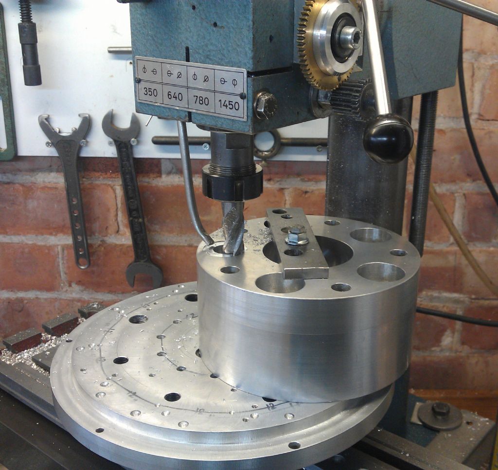

                        Ian P
                          @ianp
                          Whilst I do have a boring head, I found counterboring 20 holes much quicker when done on my 'rotating' table.
                          The holes are 35mm diameter and 40mm deep and the cutter is a 16mm endmill. I put a spigot in the centre of the table to centralise on an already drilled 12mm hole.
                          The rotary table (a VW front wheel hub with an ali disk from the scrapbox) is manually rotated.
                          Cutting the counterbores was drama and stress free. With careful adjustment of the cutter feed rate, some jobs can self rotate. The table itself was surfaced by that method with a fly-cutter about 40mm diameter
                          Ian P
