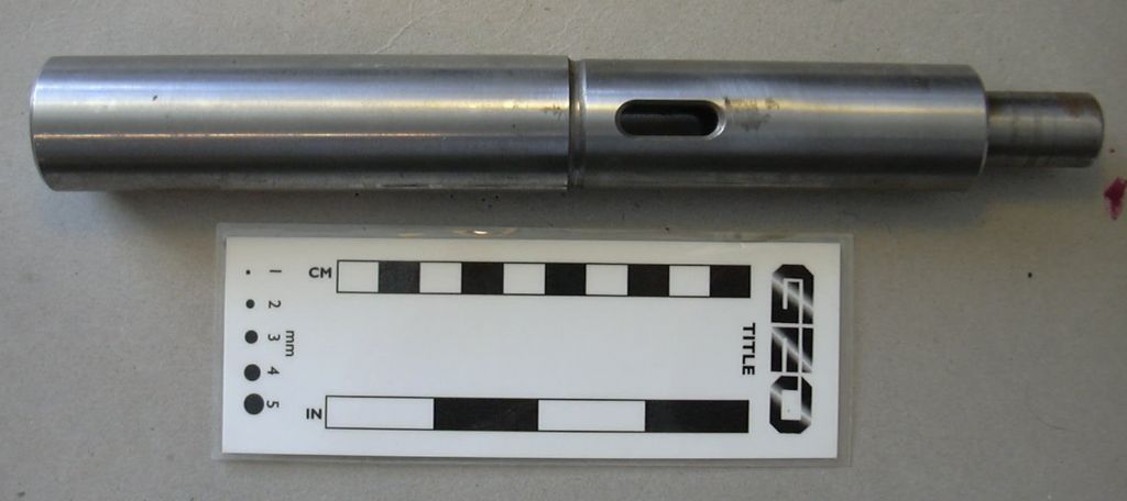

                                            Hi there, Sean,
                                            Here is a photo of a female 2MT blank end arbor:
                                            The dimensions are as follows:
                                            Overall length: 8½ inches,
                                            Maximum diameter: 1¼ inches,
                                            Reduced section diameter: 1.188 inches,
                                            Length of reduced section: 3¾ inches.
                                            As you can see from the photo, there is a slot for an ejector wedge/drift. The 2MT centred plug is rather long compared to the one I bought all those years ago in Buck & Ryan's. The back end of the arbor does have a centre drilling.
                                            I hope this helps.
                                            Best regards,
                                            Swarf, Mostly! (aka, in some quarters, 'Smaug' )

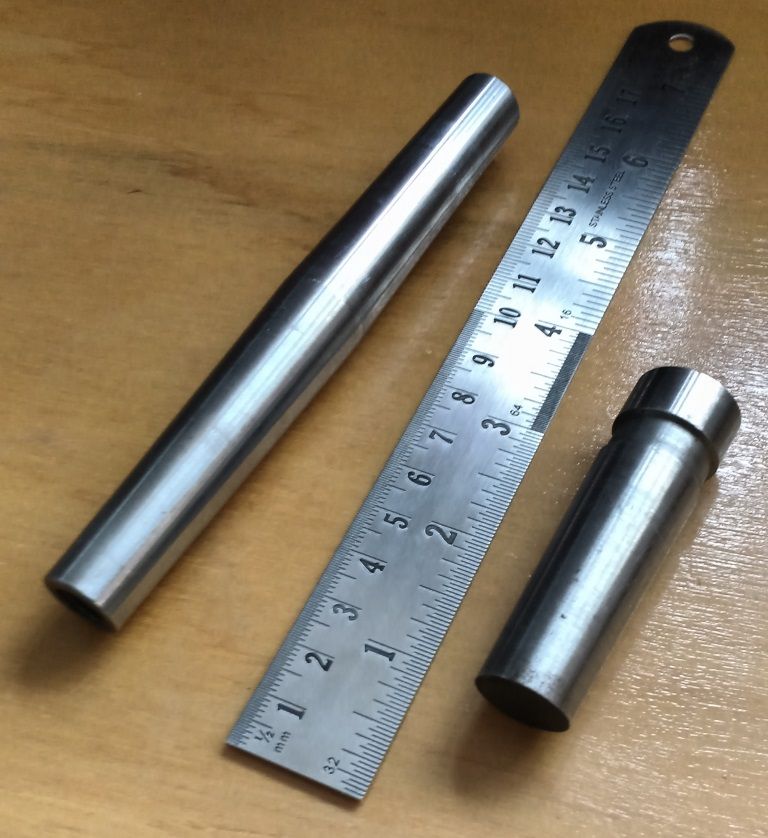

                                              On the right is the taper plug – the centre drilling is at the other end. On the left is a double-ended MT2 arbor I made. One end was turned to a taper and carefully fitted to the h/s socket in my lathe; then the whole thing turned round and fitted back in lathe taper with a drawbar to hold it while the other end was also turned to MT2, with another drawbar socket. I made this to allow making a short spindle, with an MT2 socket made in it, to be mounted to have its o/d turned concentric with the taper. You are welcome to borrow either or both of these, I don't suppose they would otherwise get used.
                                              It strikes me that using the type of arbor shown above could be difficult as it is surely hardened and ground. You can buy MT2 sleeves with parallel outsides, which you can loctite into a parallel bore in your spindle – I think RDG or Arc have these.
                                              If this is a milling spindle, you could be outrageous and not have an MT2 taper at all! Why not make the end to fit an ER25 or 32 collet? Then you only have to make a short taper, which is quite easy, I've made both ER25 and ER16 tapers that work fine. Or bore a parallel hole and loctite an ER25 or 32 straight shank collet chuck into it. There have been plenty of postings here on why Morse tapers are not the best for a milling spindle.
