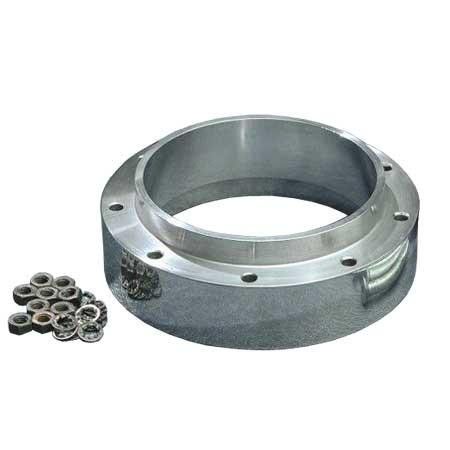

                          I have exactly the same bar in my collection works fine at lower speeds, my WM 280 hardly ever runs in the high range so that means I'm below 950 rpm. Something like 500rpm will be fine as you get towards the 2" dia, bit faster as you start to open up the drilled hole.
                          This is a 2.125" hole in a bit of 5" bar that I mentioned earlier no need for production speeds.

                              Jason, looks like a perfectly good job to me!
                              Is that a four-jaw you're holding it in?
                              #315186
                                Yes, 6" 4- jaw as there would not have been much scroll engagement if I had used my 5" 3-jaw. The same tips will work well on the external surfaces. If you don't have other holders then the facing can be done with that boring bar by cutting from the middle out once a hole has been put in the middle.
                                As others have said a bit of WD40 or paraffin will help a lot as it stops metal sticking to the tip.
                                This is the outsid eof teh same part co-ordinate turned to profiel using a similar CCGT tip
