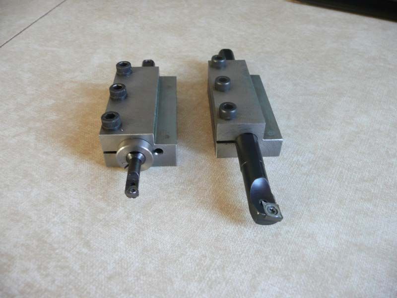

            Further down the Dorian document is a better view of their favoured split collar. A refinement on this was used by GHT as seen on the left in my photo ie a small stress- relieving hole; the other holder is a simpler version without the eccentric bush seen on the left. Proponents of other methods sometimes ask what the standard flats on the bar are for, if not for clamping? The flats do facilitate other methods but in my case the top flat just serves as a reference to the correct radial positioning of the bar in the holder; I have added a cross hole in the smaller bar which takes a tommy/sighting bar for setting the position.
            Edited By ega on 25/01/2016 11:06:21

              At last there are folks on here that understand the concept of "Rigidity ". Im not saying use my method, only showing my preferred method. Folks are free to use whatever method suits them. The system shown in ega's pic is excellent,. I like that. and it would be even more rigid were it held in a solid toolblock. The whole concept of split sleeves is that it maximises the contact area around the bar rather than relying on screws. In some of my sleeves that are not split the bar is held by 4 M8 grub screws but each sleeve is bored to a precise fit for the specific bar. and those sleeves are used on my steel shank bars split sleeves for the Carbide ones. Screws directly on Carbide are only point loading stress risers, nothing more.
              some one earlier said that Sandvik Coromant show bars being held by screws, well, that may be, but it is not that firms preferred method and that shows steel bars not carbide, because going through their vast catalogue Sandvik dont make Carbide bars with flats, all their Carbide bars are cylindrical shank.
              There are some on here that are too quick to criticize systems that they have never used and maybe dont even understand . Well thank christ im not so "offhand " as that.
              Goodnight M, Ps, ever though of applying for a job in a circus ? you appear to have all the qualities needed.

                The other method that I've not seen mentioned here that I occasionally use for small round bars is a slit square like this as I only have a couple of V botton toolholders which tend to be kept set on height for their own bar. Just goes in a spare flat bottom tool holder and the screws bear on the top.
                #222584
                Emgee
                  @emgee
                  I use the square bar method in Jason's picture, clamp the material in the toolpost and drill and ream from the chuck ensures an accurate bore for a round tool, slit after reaming.
                  In a rotary tool turret on a cnc lathe I use the round style, slit but screw clamped on the collet od, not the tool.

                      Emgee, The split collet /sleeve you mention is the same as the one shown in one of me pics [ If I get you correctly ]
                      #222604
                      Emgee
                        @emgee
                        Raymond, picture of my tool turret, boring tool fitted to 1 socket ready for use. I use brass collets made to suit the tool whether a drill, boring bar or reamer. There are 2 M6 grub screws to lock the split collet in place, these can be seen in the pic. I mill a flat where the screws bear on (90 deg to the slit) so any burr does not prevent collet removal.
                        Emgee
