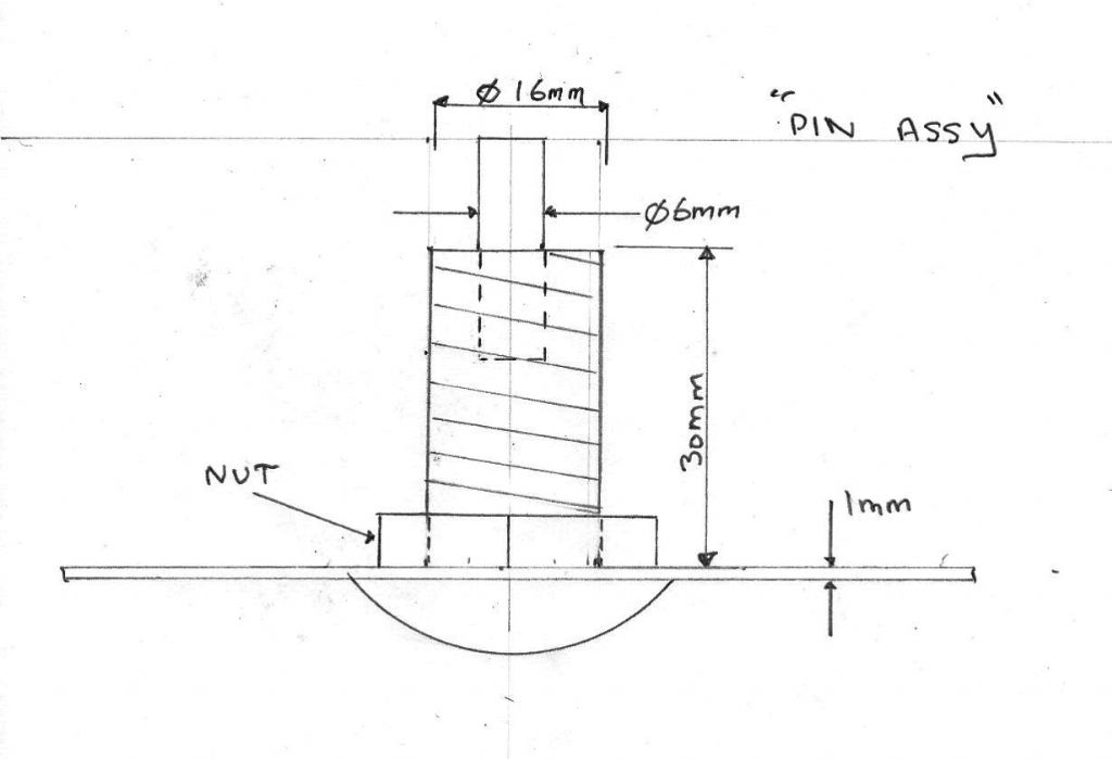

                    Richard Rogalewski
                      @richardrogalewski21509
                      Here is the item I'm wanting to make. I could use a M16 carriage bolt with square removed if I just made 3. But, if I made in production quantities maybe I'd need something else. Not easy to obtain 30mm M16 carriage bolt I imagine.. Would have to cut down a longer bolt/screw I suspect.. I would probably need a spacer between the nut and the 1mm thick sheet.
                      Ideally the screw/bolt head would be very hard – not susceptible to filing.
                      Edited By Richard Rogalewski on 01/01/2020 17:24:35

                        #444196
                        Richard Rogalewski
                          On the issue of production: Let's say a few hundred of these "pin assemblies" were to be made. Would it be perfectly reasonable, in terms of production efficiency (or whatever) to buy in carriage screws and use a lathe to remove the square features? As oppossed to getting someone else to produce the screws without the squares. I imagine buying in carriage bolts and modifying might be what most people would do.
                          #444197
                          Richard Rogalewski

                            #444200
                            Tim Stevens
                              @timstevens64731
                              The problem you may face with a 'dead hard' bolt (pin, etc) is that extreme hardness comes at the expense of toughness. So, a firm tap with a decent hard-faced hammer is likely to knock the head clean off – rather defeating the excercise, I suspect. That is, if you could solve the problem of hardening the head while keeping the threads from being equally fragile. Or distorted.
                              Sometimes there is a good reason for not being able to find a novel part.
                              Sorry – Tim

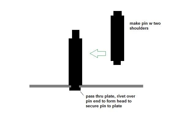

                                Jeff Dayman
                                  @jeffdayman43397
                                  If you are making a lock and want cheap but strong construction, consider the design below. If the pin ends could be identical dia and length or at least the same dia, costs would be kept low due to minimal machining and simple workholding.
                                  #444214
                                    You are likely to need a spacer or counterbored nut anyway as almost impossible to thread right upto the underside of the head. Also having a dead square internal corner between head and shank will be a stress raiser
