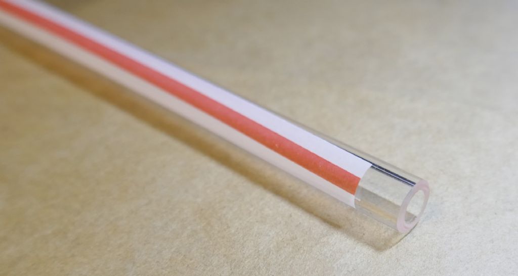

                        The glass which I purchased for my engine has a red line painted on the back which works well but needs a white background behind the glass to see the level in low light.
                        My preference though is for clear glass and a white background with red or black diagonal lines which is what we use on full size engines. The angle of the lines is inverted as light passes thru the water.
                        Paul.

                            Give it a go Nick, nothing to lose. Those that I bought have a red line in the middle and a white line on each side but a single painted line would probably be OK.
                            Also a white reflector as shown in my previous post as they are hard to see in dim light without it.
                            Paul.
