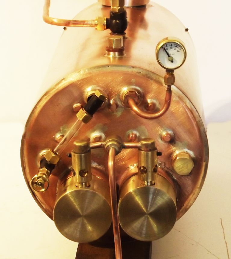

                  It needs to be a tightish push fit. If it isnt then when you apply heat to a boiler of this diameter the shell will expand a lot quicker than the plate and the gap is too big. This wasnt a problem when people used to rivet and solder. On bigger loco boilers I use rivets at a few key points to stop things moving and then remove them when completed. This is one I completed over the weekend but sadly Tim cant come and collect it right now.dscf2639comp.jpg
                  #462430
                  nigel jones 5
                    @nigeljones5
                    Thats a boiler photographed three years ago…uploaded wrong photo but same soldering, we use different burners and pressure gauge syphons now….just in case anyone notices!
