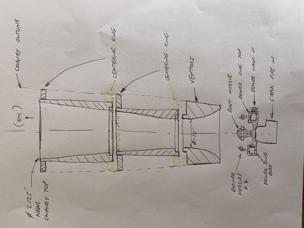

Thank you very much Steve.
Yes, the World Wide Web let the "new old" version of the spread-sheet through and it's now filed among lots of other engineering spread-sheets.
You are right on my wanting a straightforward approach because the more sophisticated design techniques appear to be for locomotives, whose characteristics are much more tightly controlled, may well be quite different from those of traction-engines, and even further away for a steam-wagon like mine.
The typical traction-engine and overtype steam wagon copies the locomotive's very short exhaust pipe and often fairly high exhaust pressure; but differs by having the jet and choke inside a long and usually diverging chimney.
Whereas my wagon is likely to send very low pressure fog through a very long pipe, to a capacious locomotive-pattern smoke-box but traction-engine style tall chimney – though of relatively large-diameter and parallel above the venturi!
I am sure now though that the choke I made is far too large, but can be modified to take an inserted smaller one. The effect of a sudden step up in diameter from its exit to the chimney itself, remains to be seen. It may not actually matter, but if necessary I might be able to make a diverging liner.
One thing I have discovered from my collection of early engineering books is that the grate itself can be significant depending on the fuel. Among their advice (for full-size), are typical bar and gap widths for coal and coke, noticeably different.
Whether this makes much difference in miniature I do not know, but with ordinary house coal shortly to be banned, at any rate in the familiar bags at shops and filling-stations, we may have to consider the grate proportions as well as draughting, for burning processed smokeless-coal.
Or whatever we can find. (Charcoal? – Its calorific value is not much less than coke, but apparently both are lower than that of coal!)

I suspect that you may need to extend the liner further up the chimney from the choke, but it would also be an interesting experiment to firstly try it without and see what happens. That's an experiment I may do with the Allchin one day, when time allows, having made the liner as a stack of interlocking sections, each approximately 4 inches long, which, together with the choke, are held in place by gravity, some centering rings, and the chimney's taper. By removing the chimney from the engine and turning it upside down, out come the liner sections one-by-one followed eventually by the choke. Hence, I can reduce the length of the liner in increments of about 4 inches at a time – it would be interesting to see what effect that has on the smokebox vacuum and draught when the engine’s working hard.
As a further thought, one other feature you may want to consider is regarding the blower. My Allchin's original blower was little more than a single 3/32" diameter nozzle centered within the blast pipe and therefore jetting centrally up the chimney. This made a lot of noise but produced very little draught and would not draw sufficient air through the fire to keep our local coal burning.
During the redraughting exercise I made up a four-jet blower using removable jets, each having a much smaller hole than before, probably around 1mm if memory serves, and mounted in a circle surrounding and centered on the blast nozzle. I based the jet dimensions and the mounting PCD on the principals advocated by Laurie Lawrence in the ME magazine, probably in the early1980's. The results, coupled with the overall redraughting exercise, were dramatic – the engine now has an almost-silent blower that draws the fire superbly.
I was so pleased with the Allchin’s blower that I recreated the same arrangement on my 3” scale Hunslet loco which has very similar draughting dimensions to the Allchin. Should you be interested, there’s a video on YouTube of the Hunslet’s first steaming and you can gauge the performance of the blower, and its effectiveness on our hard-to-burn coal, from around the 12’:20’’ mark onwards.

Steve –
I've had a run through the spread-sheet you sent.
Rather to my surprise due to the very different conditions, it gave diameters fairly close to my initial sums based on the cylinder bore, as in the literature I found on model-locomotives.
The results were also encouraging in chimney height, giving a minimum of about 15" – the actual one is about 21" high. I may have to make a profiled liner though, for the numbers to do their thing.
So thank you very much.

My thoughts for the blower on my wagon are as yours for your Allchin – a proper one with 4 small jets, probably adapted from Norm Norton's design for his 'Britannia'. He angled the jets to converge on the centre of the choke.
The wagon is a Hindley, which I chose because it was built in Dorset, I "found " it in a history-magazine, it is unusual and if I had succeeded years ago would have been the first replica. I was going to build a Foden 'C'-type but everyone has one of those. I don't blame them.
It is Hindley's "Light Delivery Van", 1 to 3 Tons, so though the model is one-third full size it is only about 5ft long by slightly under 2 ft wide; approximated to whichever advertising photograph I measured – none was exactly like another – and narrowed slightly to fit through the front door of my first house.
The firm also built a "Standard", 5-7T, an under-type with front-mounted, vertical boiler; and the "Colonial" – same thing with wider wheels and bigger water-tank for export to the Empire. They are not so pretty though!
The LDV has a patent boiler I don't think was as unique as Hindley and the Patent Office thought. It feeds wet steam through an ordinary globe-valve as regulator in a fully-exposed pipe, to an enclosed, inverted-vertical compound engine behind the boiler, and between the seats.
So it's neither under-type nor over-type but, what, … an in-between-type?
Two-speed transmission, chain-drive to the back axle differential. With no drawings, I used a general text-book on traction-engines to guide designing the axle. For the differential, I fitted a BMC front-wheel-drive car unit with a through-shaft, and replaced the crown-wheel with a motorcycle sprocket. I found years later the diff. should be on the back of one wheel, not part-way along the axle… but I won't tell anyone if you don't.

Stephen –
Thank you for those observations on super-heaters. The Hindley boiler has a cylindrical firebox that extends quite a way above the barrel, and with the water also above it. This, the point of its patent, was to allow working on steep hills without seriously affecting the water-level. So it gives a comparatively high steam-space that may be fairly resistant to priming.
If put a super-heater between the regulator (a simple globe-valve on the boiler top) and engine, the steam would descend about 6 inches, and negotiate a horizontal pipe maybe 10 inches long to reach the wet header. Coming back would entail a parallel route as the HP steam-chest is up near the boiler top.
I envisaged running the pipes under deep cladding, partly to hide them as they are not to prototype, but also to keep the steam warm; but we now have a considerable length of plumbing including the heater elements. What might that do?
It might store enough steam to give the regulator a rather slow response, especially to closing.
When the engine cools down, the super-heater and its pipes may trap an appreciable amount of water. Some of that water will boil on raising steam, and find its way to the engine. Naturally the drain-cocks will be open, and I intend fitting drains to the valve-chests as well as cylinders; but will this help warm the engine through or just add more water to be cleared?
Might it be sensible to add a drain-cock to the super-heater's return, where it starts its climb to the engine; possibly automatic (sprung to open when the steam pressure falls). I already thought of a discreet, manually-operated drain in the exhaust's the blast-pipe elbow, because that pipe also forms an extended U-bend.
Or am I over-thinking, and the hysteresis effects, and amounts of condensate trapped in both systems, will actually be negligible?
Reading your arguments carefully, I think the regulator being on the wet end would be the better arrangement, and the priming risk might be reduced a bit by fitting a "pepper-pot" or disc shield below the take-off point. The physical arrangement so far is just a large threaded bush, my idea being to fit into that a screwed flange with studs and nuts for the elbow into which the regulator is screwed. Hindleys seemed to have built their engines around stock pipe-fittings, and these parts are prominent.

Hi Nigel,
You've got a really interesting project there! If it were me, and given your willingness for adaptations(!), I think I'd approach this as follows:
1. Keep the regulator at the boiler end, but take precautions to prevent water ingress. The safest bet is to have the steam takeoff as high above the water level as you possibly can. Estimate the effect of hills, camber, and water-sloshing on the headspace between the water level and the steam takeoff point. Perhaps add a steam dome if there appears to be a risk of water carry-over and if that's possible in your design.
2. Add at least one low-point drain to the superheater circuit to allow condensed water to be removed after a run. This could be a simple screwed plug, or a manual valve, or an automatic snifting valve held shut under steam pressure but open to atmosphere otherwise. If using a snifting valve, make sure it's accessible for removal and maintenance.
3. Thoroughly lag the steam pipes wherever they're outside of the boiler to prevent condensation before the superheater and loss of all that superheat after. Even if the pipes are under the boiler cleading, if the superheater did its job then the surrounding temperature will still be much less than the temperature of the steam within.
4. If possible, configure the setup to allow the superheater to be bypassed in the future. Assuming there is a shorter and more direct route from the regulator to the cylinders, it would be interesting to determine if the superheater provides any real benefit given the amount of external piping and complexity it involves. If the benefit is marginal, then you can choose to eliminate the superheater circuit and save some maintenance hassle in the future!
I hope the above is somewhat helpful Nigel, but won't be in any way offended should you disagree with or ignore some or all of it! I would certainly like to hear how things go however, so please keep us posted.

Thank you for the formulae – would be interesting to examine the numbers though thinking about it, I suspect the amount of condensate would be negligible compared to what happens in the cold cylinders anyway on first opening the regulator.
Steve –
Thank you for those ideas. It should be quite easy to experiment as you say, because the prototype steam feed to the engine was a short pipe with flanged joints, up on top of the boiler and meeting the engine only just behind the driver's left shoulder. The way my project's grown has given a wide annular channel between the boiler-barrel and smoke-box wall. I have fitted that with three interpenetrations – one for the blower, and two for the super-heater, blanked-off simply with screws.
The steam take-off is right at the top of the boiler, which itself was designed to keep the water-level fairly stable when driving up and down hills. (Such as the one rising from their factory, in a steep-sided valley!) I think mid-glass on my boiler is about 4 inches below the boiler-top.
A manufacturer's photo of a sample wagon awaiting its platform, shows the take-off was a swept bend rising a few inches above the flange – about an inch on the model – before turning horizontal to meet the regulator. From that valve, a short level pipe in the air above the cylinders reached a displacement-lubricator and lever-operated device I interpret as a starting-valve, on the HP slide-valve chest.
The route is so direct that with discreet lagging, it may indeed not make much difference to fit a superheater. The 4 flues are rather small so the elements probably won't be more than 6mm bore.
A super-heater drain need be no more than a screwed plug, though a little plug- or drilled-screw valve won't fall into the grass, and can be used when the engine is resting hot. (It's not only workshops that have those kleptomaniacal elves.)

I have now started making the new choke, based on your spread-sheet. I'd broken off from that for a while to revise the boiler's mounting brackets on the chassis.
I'm making the choke in two parts, and have machined the longer, exit end, but it is only 2 inches tall and ends abruptly at about 1.5" dia, opening inside the 2.75" dia chimney. I think the theoretical continuation by that 1:6 rule is at least 9" (the outer chimney, to scale, is about 20" tall) .
I'll go with it for now and see what happens on test. If I need make an extension to the cone I'll probably have to roll it, if I can.
I've to make the converging part yet, but because the choke is in two parts I'll probably screw together via a flange on the main section, have paused to make an adjustable alignment-tool whose central stem also has a spigot turned to fit the blast-nozzle's calculated diameter.

Hi Nigel,
Sorry to hear about your fall, and hope that you're soon back on your feet in the workshop.
If it helps, here's a sketch of how I made the sectional liner:
It seems to me that, if your choke section is short and opens immediately into a much larger diameter chimney, you run the risk that, when the engine is working harder and the exhaust jet sharpens (ie, the jet's cone angle decreases), the exhaust jet may not fill the chimney. In that case the choke probably won't provide much benefit.
While it would be an interesting experiment, if I were you I'd plan things so that you can readily extend the liner at a later date.
Best regards
Steve
Thank you Steve.
I've applied, at the surgery's advice, for physiotherapy. I planned to complete the alignment-tool today but after a very fraught and painful expedition to the shops only a couple of hundred yards away this morning, I did not go into the workshop at all today. I was booked to go on a local geological field-trip on Sunday, but that's out of the question now.
Yes, I do have something like your drawing in mind, and I have made the choke itself so an extension can be bolted to it.
The limit on a taper length I can turn, short of making some form of taper-running attachment, is the 3" compound-slide travel on the Harrison lathe. However, using sections as you have also has the advantage of material economy by stepping up the stock diameters.
I found the best way to make the venturi is in two parts joined on the choke line, and to bore the billet through to choke diameter, then taper-bore diverging towards the chuck. That means I can see when the tool is approaching the choke itself, leaving a very small land inside it. The other end looked after itself, with due care not to run the boring-tool into the chuck of course as the diameter hidden from me increased .
I cut two wide grooves into the outside of the venturi, with a small land in the middle for its location in the chimney saddle. This gives a bolting-flange each end, and cuts the weight down. The smoke-box, a piece of 8" seamless-steel pipe, is heavy enough as it is.
One detail I am adding is making the outer chimney detachable to aid transporting and storing the vehicle; by flanges probably in prototypical way, at least to general traction-engine practice. I would have to make any liner similarly removable.
It's occurred to me to make a long blast-nozzle threaded to screw into the pipe so its height can be adjusted. Alternatively, a simple telescopic tube locked by grub-screws.
