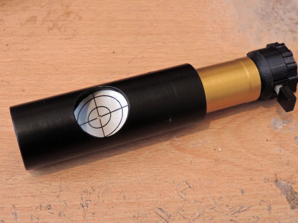

                                            #602691
                                              I'd agree with Tim, except the finish with inkjet inks should be waterproof, assuming you seal the anodising by boiling or with proprietary sealer.
                                              I anodised this laser collimator with gold and black dies from Gateros Plating.

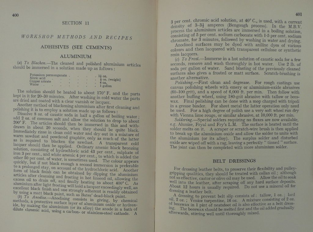

                                              Georgineer
                                                @georgineer
                                                It's probably too late for Rik, but I've just come across this useful page in Engineering Workshop Data by Arthur W. Judge (Caxton 1950). I'll add it in case it's of use to anybody :
