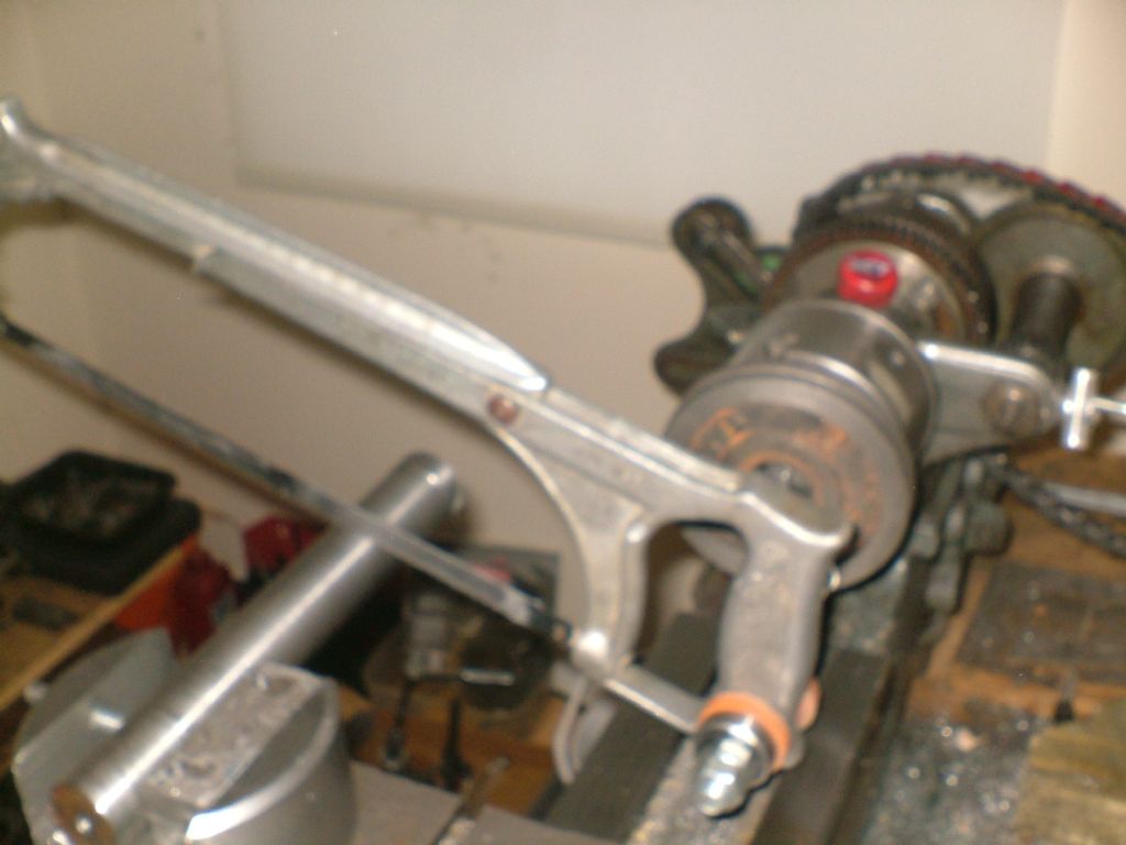

                I made a simple chopper upper out of a standard hacksaw which can be used with my backgear.
                The Piccies are in my album.
                Handy for chopping up big long bits, I keep my hand on the top of the hacksaw to stabilise it.
                The 3jaw opens out to tighten on the hole in the “flywheel”
                The bar has a couple of bearings and orange polyprop shims to adjust for a straighter cut.
                Heath robinson stuff but it’s chopped a load of 45mm rebar into manageable lengths with a single hacksaw blade.

                    OMG is that safe?
                    #80429
                    Jeff Dayman
                      @jeffdayman43397
                      Probably one of the most UNSAFE lashups I’ve ever seen on a power tool. So much could go horribly wrong here I can’t begin to comment.
                      For your safety and the safety of your lathe bed please do not set up a hacksaw and lathe this way!
                      Ady must have been well on the grog when he came up with that one!

                        Ady1
                          @ady1
                          Thank you Mr Stub.
                          Tsk tsk tsk.
                          I suppose Frank Whittle had the same problems, genius and simplicity ridiculed by unbelievers…

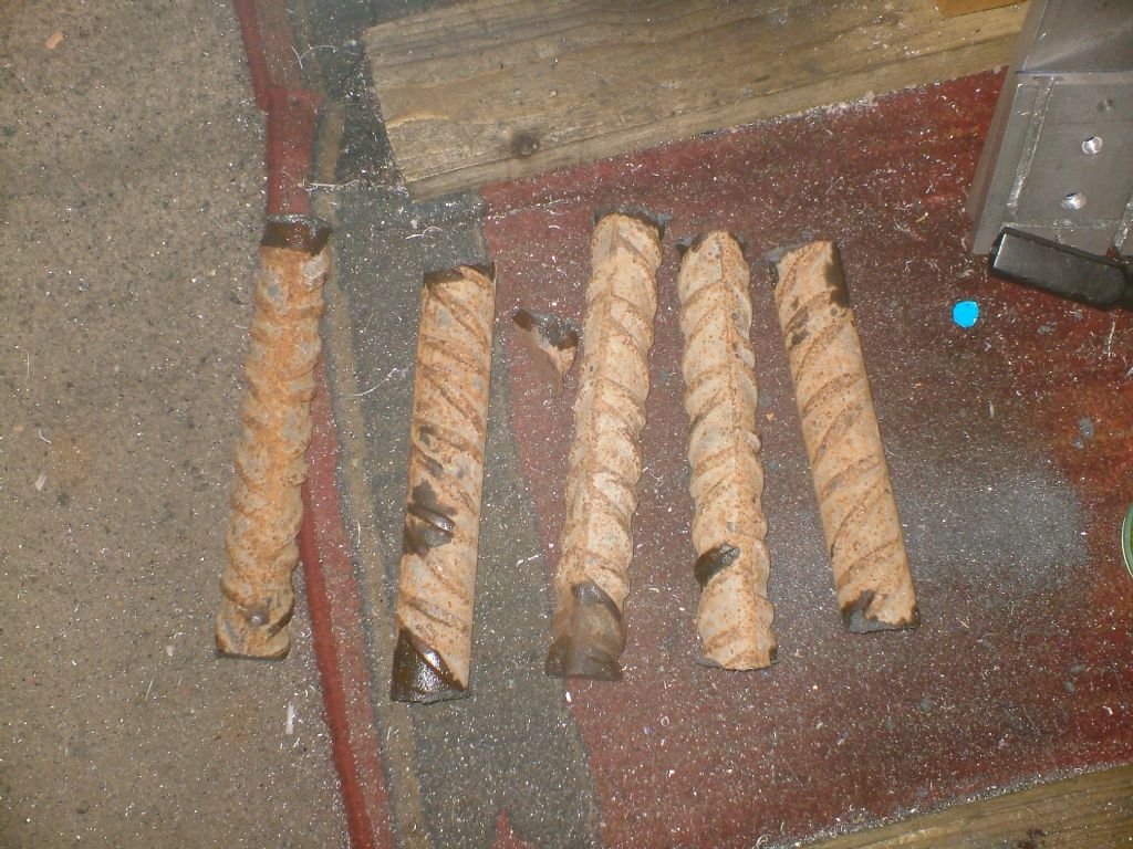

                          Here’s five feet of 45mm rebar (which is tough stuff) and a knobbly bit which I cut off tonight.
                          The blade had no broken teeth at the end of its work, the back gear works at about 50 beats a minute so the downside is it’s no faster than a human, it just never tires out.
                          This job took about 3 hours.
                          The sneaky bit is the blade…it’s the wrong way round…the handle end was the only bit with enough metal to set up a fast simple mechanism.
                          So the blade is actually being PULLED through the workpiece, and the far end is now the handle, which you use just like a normal hacksaw, except now the machine is doing all the sweaty work.
                          You simply push down on the cutting stroke as the machine works, you soon get into the rhythm.
                          At the end of the cut you stop the machine as the cut opens.
                          simples.
