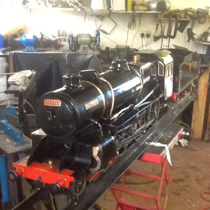

          Tried to steam today but top dome bush leaked steam so got to make a Gasket for it tomorrow.
          Be nice to finally get steam up been really exited to get it up and running but due to ill health not been able to touch it for a few weeks.

              Found the new boiler is leaking below the top dome fitted got to take back to boiler maker
              Ron
              #224291
              KWIL
                @kwil
                Thought it was CE marked and properly tested,
                Was it actually tested because the 2x hydraulic test should have found that! Did you witness the test?
                #224299
                Ron Hancock
                  @ronhancock63652
                  It is ce marked did not see the test just came with all the paperwork.
                  It could be some thing I have done I am going to ask if he can fit a new Top bush and re pressure test it.
                  I don't know how he can pressure test it without top dome fitted as hole is around 21/2 wide.
                  But I am a novice so anything possible
                  Ron

                    All openings, top dome, gauge, wash down etc have to be properly capped/covered to ensure there is a completely sealed boiler. Then hydraulic pressure is applied.
                    Chuck it back as "not fit for purpose" and get GB to finish the job, its not your fault it leaks, he should have found it before delivery.

                      it is not up to GB to make a dome inner cover. they have done the hydraulic test with the dome blanked off.
                      it is up to Ron to make the inner dome plus all the fitted stainless bolts to suit, plus gasket if required.
                      i suspect the problem is distortion after silver soldering the dome bush plus use of ordinary bolts/screws. in my experience it requires a lot of fettling with engineer's blue to get a good fit with the inner dome. fitted specially made up stainless bolts make a great deal of difference – you need a plain unthreaded shank through the inner dome flange to avoid problems. i hate making up these special bolts out of stainless but is something ive done many many times.
                      dont expect ordinary bolts threaded up to the head to be anything like as so good!

                        Ron says in first posting above, that "it leaks below the the top dome", ie where the bush is silver soldered to the barrel.
                        If it was down to Ron why would he say it has to go back?

                          i had commented to Ron that i would be very very surprised if the dome bush to barrel joint was the problem. if it was, then i totally agree with you.
                          having received further info from Ron it would indeed appear that you are right which is extremely annoying plus unusual in a professionally made boiler already hydraulically tested.
                          my initial reaction was it was more likely to be a problem with the inner dome to dome bush flange.

                            Well after filling boiler with soapy water found bubbles coming from by the weld.
                            I think using the 2BA has caused the problem the top of the bush is not very deep or wide.
                            I have asked Goarge to make the top deeper and wider give me more meat to tap into.
                            I am then going to use stainless studs with nuts if I can get the stainless will make the inner dome from stainless.
                            Hope I am more successful next time all a big learning curve

                                      Only 6 screws?? The inner dome on my Simplex uses 12 screws. If it is a similar diameter as the Simplex, no wonder it leaked. Probably one more screw between each of the existing screws might of worked. The screws also do not look exactly evenly spaced. Also, the surface that the screw holes are drilled through looks like there are still machine marks. If this is a gasket surface, it must be machined quite smooth.

                                        You are missing the point, it leaks at the boiler barrel to bush silver solder joint, not the dome joint. Certainly 12 screws, 2BA is far too large in such a narrow ring, layout, even if you do not have a dividing head is simple, using a pair of dividers set to screw PCD/2 and school geometry. Aesthetics could certainly be improved by better surfaces, but Ron admits to being a novice.
