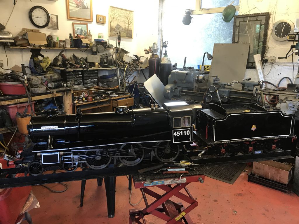

      eell after a very long time struggling to sort my Black 5 out I gave up I took it to BP Steam Ben in Southport.he now has my axle pump injector both working. He also sorted my chimney as I had dimensions wrong.image.jpeg

                It ran so nice at Southport axle pump and Injector borrowed from Julian Atkins worked.
                Ran for an hour and a half so good,
                I had bought another injector from ebay a 24 ounce Ben Pavior fitted for me from BP Steam would not pick up.
                Fitted the borrowed one from Julian picked up clean so happy.
                But why oh why do so many injectors fail i thought it might be me so got BP Steam at southport to fit and try.
                Just sending it back hoping they will send a working one for me.

                      Yes it was a great run at last very surprised the brand new Injector from EBay did not work came from Barmouth. I got Ben to fit it for me as I thought I might be doing something wrong when fitting.Ben fitted for me to make sure pipe work or in case of Air leak. That's the 5 one to fail on me I had two more before the three I sent you. Hard to beleive so many sold that will not work. It was the first time I was able to Run it Properly and it was exiting. After Ben changed the Blast nozzle for a smaller one and removed the taper insert in the chimney it ran like clockwork. I was amazed at how powerful it pulled after also how little coal it used to before. So nice to have one I can now enjoy using. Ron

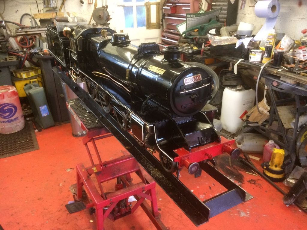

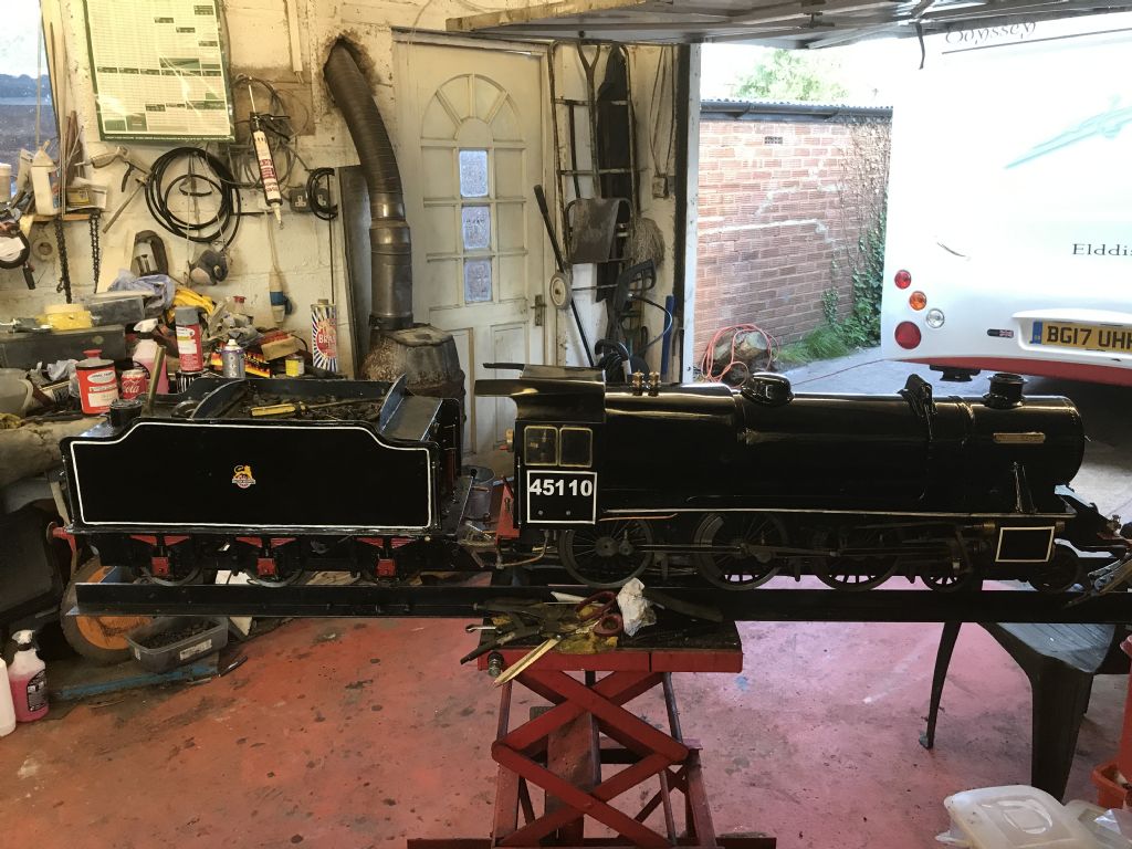

                          Paintinting Finished at last got to change cab numbers to Big so more ordered. Can't wait to Run it at Nantwich on 16

                                Ben Pavier of BP Steam finally sorted the last few problems for me.
                                I had a Taper liner I was told to fit in Chimney he removed that.
                                He then lowers and fitted a smaller blast pipe nozzle.
                                He raised the grate as it was to low and fitted to me pop Safty Valves hi now only drops 5 psi from 90 .
                                It now holds steam well fire lasts ages steams really well so please last time I Ran it for hour and a Half.

                                      Yes I have seen so many times injectors won't pick up but at least I now have my Axle pump working thanks to Ben
                                      I don't mind feteling it to keep her running nice now I have it steaming well.
                                      I found it so frustrating getting water into the boiler my uncle made the rolling chassis some 55 to 60 years ago but he never put o rings in the pump.
                                      Ben machines and fitted new o rings it now pumps lovely.
                                      Now I need to get used to driving and firing it a little more practise now it's all working.
                                      Got to try the two new Injector pumps steam fittings sent me hoping they will pick up ok.
                                      Just waiting for the paint to really harden of before putting a fire.back in it.
