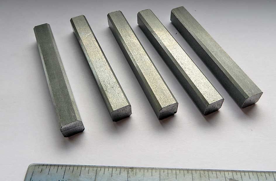

        Hi all,
        Just thought I would post this as a bit of fun.
        There will be a small prize of some small items of workshop tooling to the first person to correctly guess EXACTLY what I am making. The answer must be very specific.
        I have started with some 3" lengths of 3/8" square mild steel and milled the corners off with a 45 degree dovetail cutter as below:
        I am making approximately 50 of these items and there will be the same amount in 5/16" square material. Obviously I am doing all the items in batches to keep the machine setups to a minimum.
        If no one gets it with this photo I will post the next operation when I do it.
        THIS will NOT be ready for Xmas!! laugh
        I hope everyone has a great Xmas despite what is going on and would like to thank all the people on here who have been so helpful to me over the year.
        Regards, Martin
        #515116
        Ady1
          @ady1
          How many guesses are we allowed with each photo?
          Edited By Ady1 on 23/12/2020 14:16:16

            #515126
            John Baron
              @johnbaron31275
              Hi Martin,
              OK I'll have a punt, links to fit door handles on each side of a door, the shaft goes through the door into the handle !
              #515136
              Alex Brown
                @alexbrown78795
                Hi Martin!
                It's the fact you're making 50 of them that's throwing me off! Although I guess that might not be all for your own use…
                My guess so far is blanks for pens, although I'm not sure why you'd start with square and not round
                Fun competition!
                #515141
                not done it yet
                  @notdoneityet
                  Sleepers for a rail track?
                  #515143
                  ega
                    @ega
                    Are you making a heavy duty zither?
                    #515146
                    Martin King 2
                      @martinking2
                      Nice tries, but no cigar!
                      Martin
                      #515152
                      David Noble
                        @davidnoble71990
                        Engineers Jenga?
                        David
                        #515158
                        Martin King 2
                          @martinking2
                          Nice one but no!
                          Martin
                          #515160
                            Door handle spindles for a large public lavatory.
                            The ⅜" spindles are for the Gent's Bogs and, like tissues, have to be man-sized. (ie clumsy oaf proof.)
                            Dainty ⁵⁄₁₆" spindles are more than sufficient for the Ladies Powder Room, where refined womenfolk repair to complete their toilette whilst hubby accidentally soaks his shoes next door.
                            Gent's toilet door spindles operate in a hostile environment and to be awarded Europe's much coveted CE Mark must be rust-proofed against flying liquids; stainless is best. Lady spindles may be painted Floral Linen Pink, but it's decorative only.

                                            #515235
                                            Martin King 2
                                              @martinking2
                                              If of any interest I will post the remaining machining stages of these cutters as I go along.
                                              Got to make a split collet today to hold the stock in the 3 jaw for the end operations.
                                              Martin

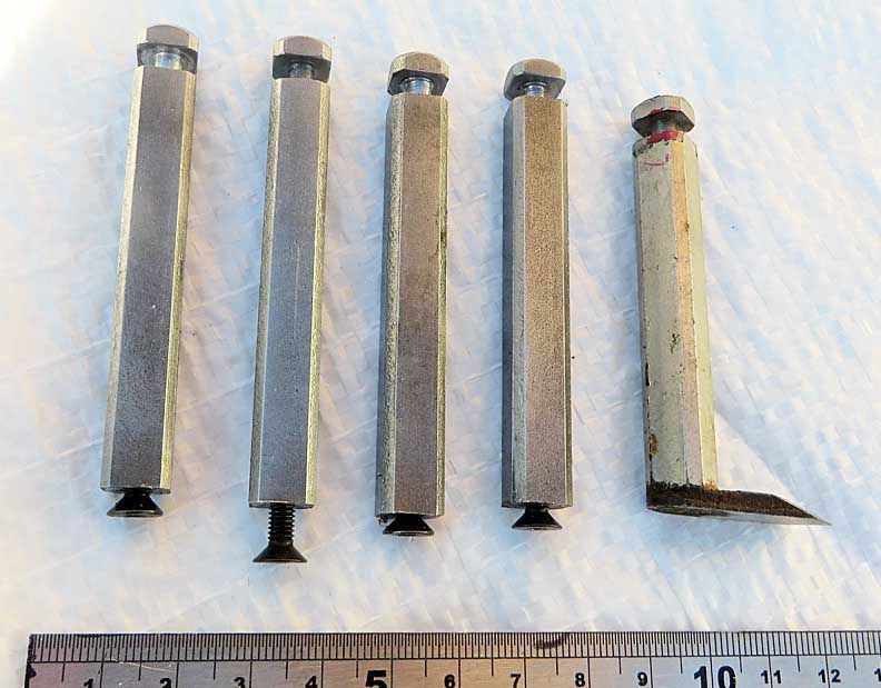

                                                  #515647
                                                  Martin King 2
                                                    @martinking2
                                                    Hi All,
                                                    Here are the next operations completed. Original shown for comparison.
                                                    Rounded over the upper end of the shank; cut the groove for the adjusting screw and tapped the bottom M4 for those cutters that have the removeable double bevelled cutter. Other will just have a silver soldered or tig'd cutter to the ends
                                                    The split collet was a great success and worked well.
                                                    This job is very repetitive and gets a bit boring so I do a few at a time then something else.
                                                    I am not sure how to best get the 2 1/2 degree bevel at the bottom, will probably put the part in a vee block and make an angled fence on the disc sander. Just hop the screw will still line up OK disgust
                                                    Cheers, Martin
