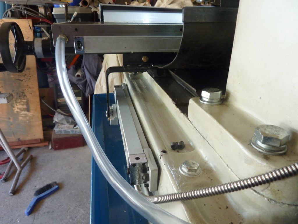

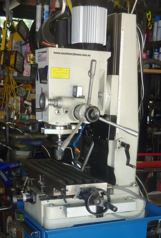

              I have an RF-45 (clone) milling machine and wanted to keep the front of the table clean and be able to use the table stops. The mill when purchase was coverred in a sticky protective grease which meant the dis-assembly of the table slides. This was not a problem and allows you to inspect all of all parts.
              While the table was removed, I drilled and tapped holes for mounting the DRO scales. A special bracket was made for the Y-axis scale. The supplied scale covers were modified slightly. This installation still allowed for the full travel of the Y-slide.
              Paul.

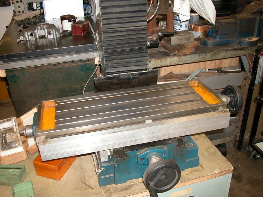

                      When I fitted a DRO system to my Chester Lux style mill many years ago I reworked the stop system to make it shallower using an ordinary hex head bolt instead of the cap head provided. I left a space between the edge of the table for access to the adjustable stops and hex-head set screw for the which replaced the standard Bristol style handle on the lock. Changed the hand wheel for a folding type with a longer boss to win little more space. From memory the hand wheel only needed to be moved out about half an inch, maybe touch less, to find space for everything.
                      Space for spanner can be seen in the picture. Only just enough vertical space for the glass scale above the slipways and hand wheel boss. These days I'd go magnetic every time on a small machine.
                      table.jpg.
                      Unlike Bandersnatch I used the X stops a lot on that machine. My normal practice was to mill with X axis whenever possible, setting the stops when verifying clearances and travel. This may have been because I frequently found table travel limiting. I now have a 49" table Bridgeport and almost never use the stops.

                        Paul Lousick
                          @paullousick59116
                          Hi Clive,
                          My mill looks like a later version of yours and sold in Australia as a HM-45 (RF-45 clone). Glass scales will fit at the rear of the table with a few mm to spare between the cover and the mill column.
                          Paul.
