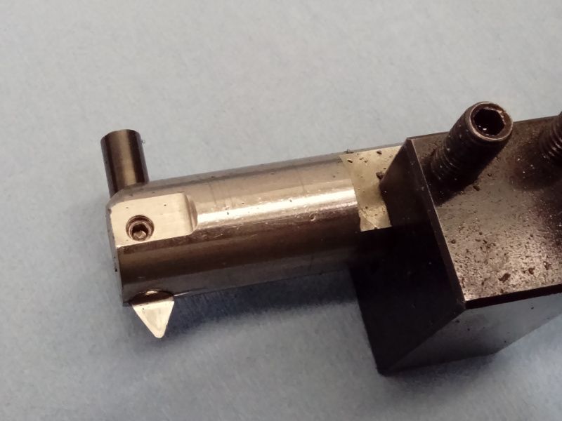

                                I rough out all my HSS tools with a thin grinder disc. It puts much less heat in than the bench grinder. I even made this tool last week by cutting a 8mm drill bit and roughing the shape with my mini grinder before finishing the tool on my grinder to cut a 4TPI Whitworth thread.
                                Edited By Pete Rimmer on 16/07/2019 18:16:52

                                    Tidy job there, Pete. Did you make the bit-holder too?
                                    #419378
                                    Pete Rimmer
                                      @peterimmer30576
                                      Posted by Jim Curry on 16/07/2019 23:30:34:
                                      Thanks Jim. Yes it's just a bit of inch bar about 8" long, with some flats milled in it and cross-drilled for the tool bits. In hindsight 8mm was a poor choice as it limits the range of HSS tooling I can use (hence the rather nice drill being butchered), but I had a broken 8mm carbide end mill to use in it originally. Broken carbide end mills make for great lathe tools, if it does take a good while to grind them to shape on a diamond wheel.
