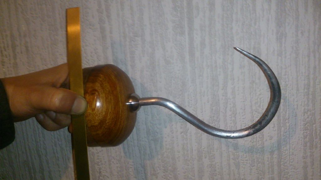

      Hi. Nowt to do with model engineering I'm afraid, but Panto season is approaching (oh yes it is!) and I've been asked to make a hook for Cap'n Hook. Pic of work so far below (I hope). I want to make a leather cuff trapped beneath a band of brass which will all be secured by upholstery tacks.I've got a length of what was advertised as 'boiler band 22g' (but is actually about 0.9mm thick, so nearer 20g I think). Any advice on how to bend it smoothly without a rolling machine? The diameter of the wooden bit is about 100mm.
      Thanks, Robin

          Bend it round that lump of wood?
          Seriously, I'd just clamp one end to a suitable former (something longer and not tapered, like a bit of drainpipe) and bend it by hand. Exact radius isn't critical, once you have a circle, it will be easy to close or open it up.
          You could anneal it first, but that might actually make it more prone to getting an ugly kink in it, and you'll have to do a lot of cleaning and polishing.

                  Neil, I'll try what you suggest – was worried about getting kinks and whether better to anneal or not. I've got four foot of the band, so enough for two or three more goes if it doesn't work. first time.
                  pgk pgk – thanks, but as Michael says it is functional as well as decorative.Shall store the idea away though! I did think of plastic, but as the brief from the stage manager was to produce something more authentic so I modelled it on a real C18 prosthetic hook. He has complained that it's a bit too lethal though! I shall grind the point off angry.

                        Given that you have plenty of material … Wrap it round a smaller diameter [say 80mm] in a tight helix … then spring it open over the 100m+Fabric and trim to length. [obviously a slight twist is needed to bring it back to a circle]

                            In which case since you have trial spare I'd turn another timber rod, pre-drill the tack holes on a length and form the bend by tacking it around as you go.. perhaps for a better hold using screws unless you are prepared to use the upholstery tacks close together as in their furniture use. Once done remove, ease any springiness out of it and mount.
                            Have you considered the thickness of the leather? If your band is to cover the front edge then the wood could have been rabetted

                                Can I take issue with drilling tack holes and then bending. If you take that course you will find that the brass may bend across the tack holes, you will end up with a series of flats with a bend across the hole. Why? its the old story of the line of least resistance, because the brass is effectivley narrower at the point of the hole that is where it will bend.
                                #170615
                                  As Dusty says, I'd bend, then drill. Two strips of wood set about 2" apart on another bit of wood will make a 'v-block' to hold the prosthesis for drilling.

                                    If fixing as you go then I'd have thought that the head of the last fixing supports it's hole and you would need a flat drift and light hammer for the next segment before fixing so predrilled holes shouldn't be an issue. Most difficult would be the theoretical need to tension the free end as you go round…..

                                      Thanks for futher advice since last thanks. I have read all, and shall inwardly digest. It is no doubt trivial, but I have had bad experiences trying to cold-work brass – I've always end up with kinks because of the work hardening thing. I'll give it a go tomorrow, bending undersize, springing it out and then drilling will be my first approach I think.
                                      I haven't made a formal risk assessment on this job because between doing that and preparing the Gantt chart for project management I would hardly find time to actually do the work. I think I'll get away with it though!

                                          I'm not sure about this thicker material but thinner material loves to take on a bend when you are trying to flatten it eg by placing on a slightly resilliant surface like leather or layers of newspaper and rubbing or rolling along it with a larger diameter smooth rod.
                                          It might work to push it round a mandrel with a round bar provided the bar is pressed very tight against the material and marndrel trapping it so that it is a continuous bend rather than a succession of straights and kinks. I think a bar would be better than a roller to keep friction/tension on the band.

                                              Well, after all that I ended up doing it without the brass band. Thanks for all your suggestions though, which will be squirrelled away for future band-bending experiments. Despite Dusty's warning about creating weak points by pre-drilling the brass, I thought I might get away with it as the upholstery tacks need only 1.5mm clearance holes and the brass is 15mm wide by nigh 1mm thick. Plan was to glue the leather to the wood, start by tacking the brass down at hole 1 and work round. Alas, the crappy Screwfix tacks I'd bought were completely incapable of penetrating the wood (it was an offcut of hardwood which I had lying around, probably Bubinga) – they either bent or the shaft came through the head. So I would need to somehow bend the brass then drill pilot holes through. Avast I said to myself, avast! Enough is enough. And it hd to be finished by tonight. So I just drilled pilots through leather and wood and tacked. Unfortunately, though I'd calculated that pitching the tacks at 24 degrees would be about right aesthetically I haven't yet recommissioned my mill/dividing head, so had to resort to more primitive means. There could well be a one degree or more error in their positions! I'm just praying that no one in the audience notices and demands their money back, prompting a mass exodus. Anyhow, this is the result:
