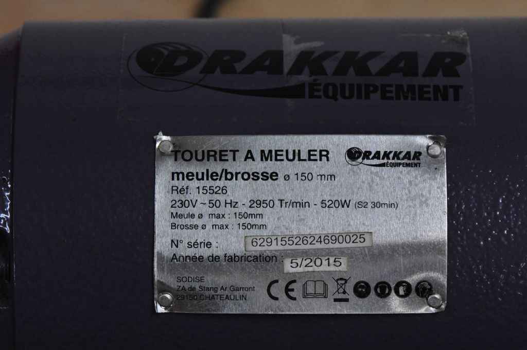

      Hello Everyone,
      I recently purchased a bench grinder.
      The type that has a grinding wheel on the right hand side and a wire brush on the left.
      On each safety cover is a sticker saying not to install a grinding wheel on the wire brush end.
      Can anyone enlighten me as to why
      All the best,
      Daniel

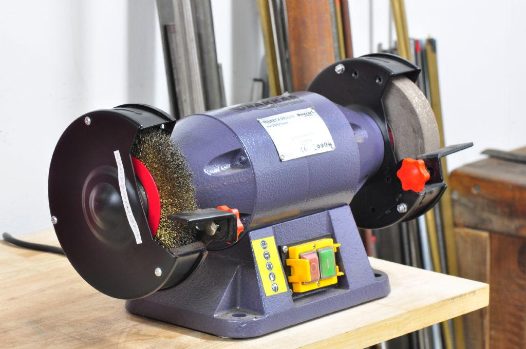

          Hi Daniel,
          It would help if you posted additional info and maybe a photo.
          Physical size, wheel size, motor output and the type of mounting on the brush side etc, would help contributors on the forum to advise you.

          Rik Shaw
            @rikshaw
            A stab in the dark. On my grinders the RH wheel is secured by a RH thread and the left hand by a LH thread. I am guessing that your grinder is RH thread at both ends in which case a wheel fitted on the LH side, it being heavier than a brush, is likely to work loose – ouch! ………Rik

                Hello folks,
                Here are some photos of the article in question . . .

                  #269943
                  Sandgrounder
                    @sandgrounder
                    Could the wire brush side be threaded M14 to take screw on brushes? If so this wouldn't be suitable to mount a grinding wheel.

                        #270285
                        John Shepherd
                          @johnshepherd38883
                          Daniel
                          Have you actually checked the threads to see if they are R or L handed?
                          Another reason for the instructions stating that a grinding wheel should not be fitted is perhaps the lack of large dished washers. The brush mounting may not need these because of its metal hub but the grinding wheel needs them to spread the load.
