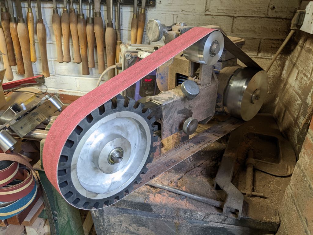

      I built a 50x1500mm belt grinder back in the summer of 2021. Recently I decided it would be nice to have a few more attachments, such as a contact wheel and a small wheel attachment.
      I wasn't in a rush, so ordered a contact wheel from AliExpress, and I found a very cheap small wheel attachment on some dodgy website (Weirdly it has now been put up from £32 to £85, so I may have got it for the wrong price).
      Both arrived and I began fitting them. The contact wheel was very simple to fit and I'm very happy with it.(Very mucky, it has been cleaned since)pxl_20230218_094010424.jpg

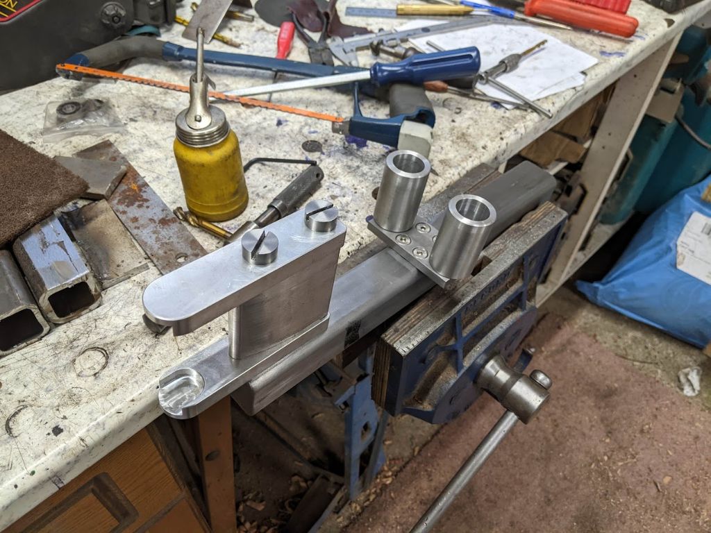

      For the small wheels attachment I decided that I wanted to put some idler wheels around the small wheels so it pinches the belt down so I can fully utilise the small diameter of the wheels.
      I have made some idler wheels from some aluminium tubing and I have press fit some bearings in.
      My though is, these wheels are going to be running on the outside of the sanding belt, which will likely cause wear over time. As a preventative maintenance kind of thing, it would be nice to coat them with some kind of rubber that will not wear away as quickly. Possibly some kind of tubing that I could stretch over the wheels and replace over time when necessary. I had thought about using a bicycle inner tube but there must be something more suitable out there?

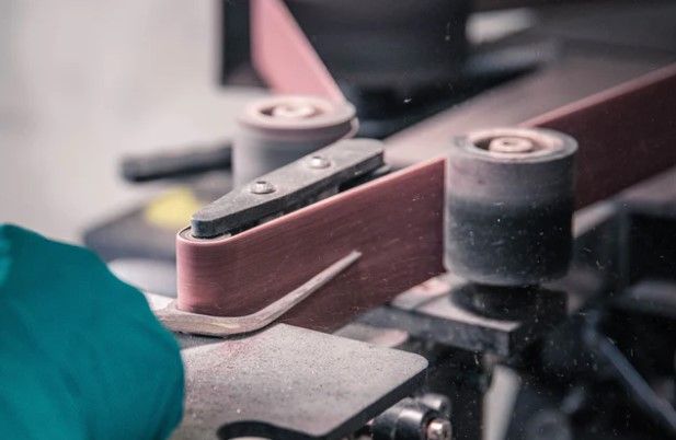

          Won't the 'grit-side' reduce anything you put in contact with it into airborne particles.. ?

            It shouldn't. The wheels will be spinning alongside the belt as I have pressed the bearings in, so there will be less abrasion but still some. Hence why i'd like to cover them in some rubber.
            These products are usually sold with rubber wheels but are significantly more expensive. I looked into castable rubber but decided it was too messy, and I was unlikely to get it to be concentric.

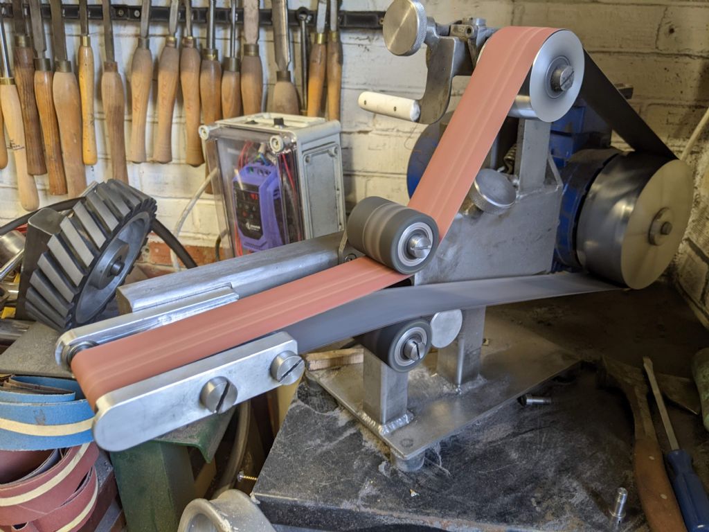

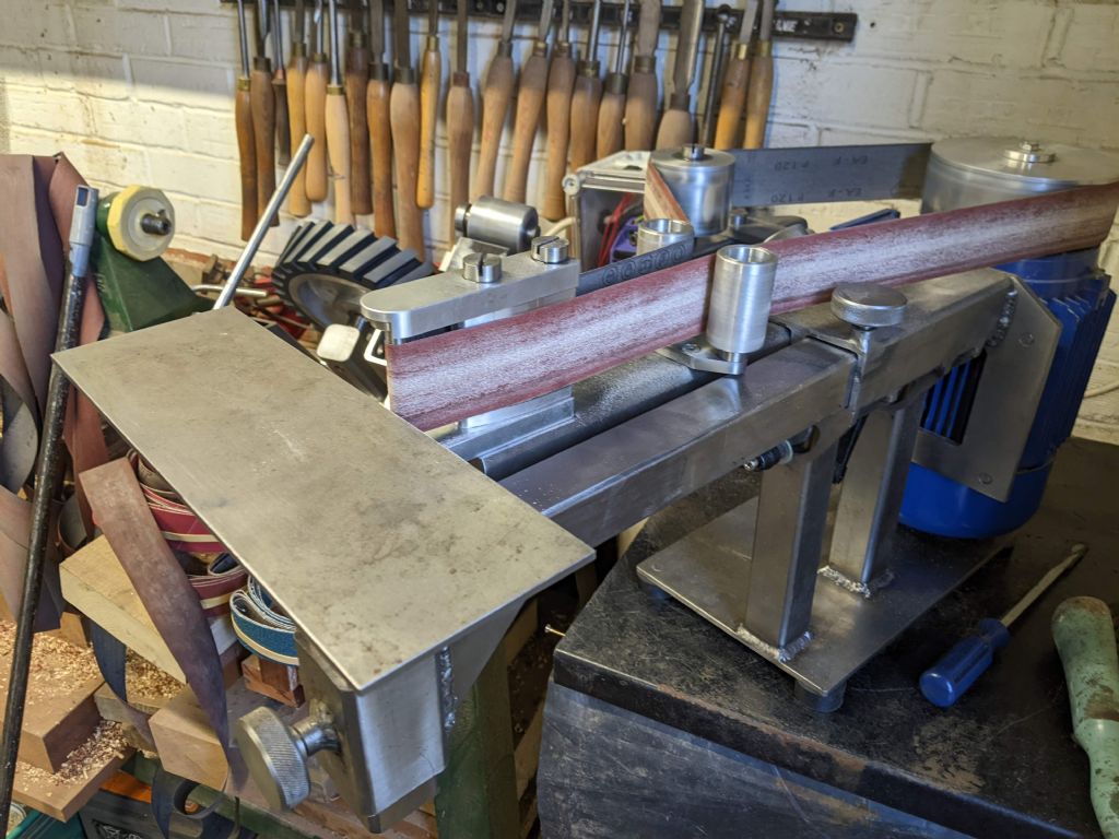

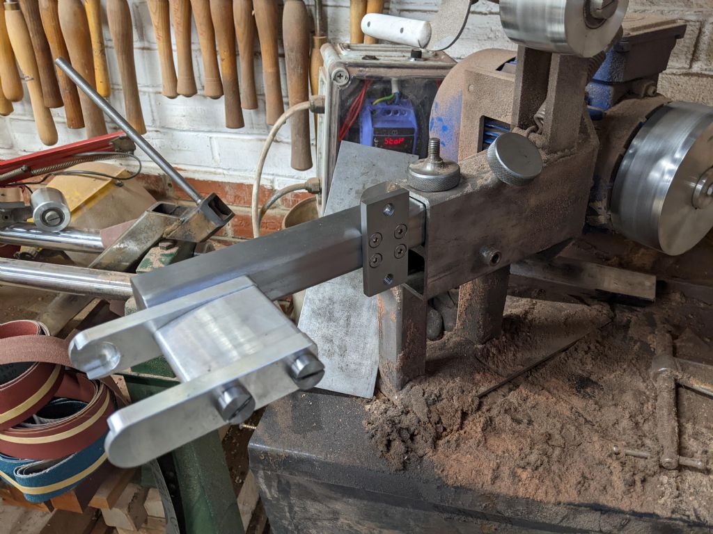

                          Another weekend spent fitting the new tooling. (and a few other minor upgrades)
                          Last thing left to do is to make a tool rest for it, but that will have to wait until next weekend.
                          I did run the sander at its minimum speed to see how it went, and it ran okay, but I still think i'd like to cover the wheels.
                          I measured them and they are 38mm diameter. I found some radiator tube that's 35mm ID, will this be easy enough to stretch over the wheels? I know radiator tubing is tough stuff, but after soaking in warm water, will it be supple enough?
