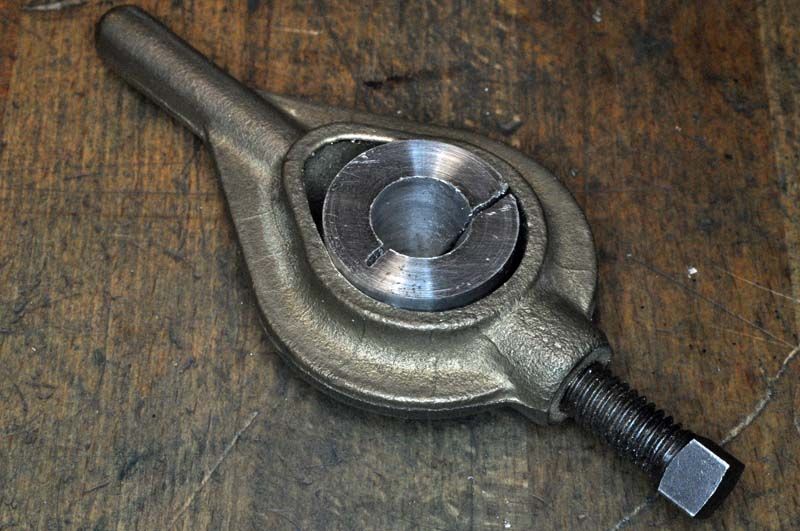

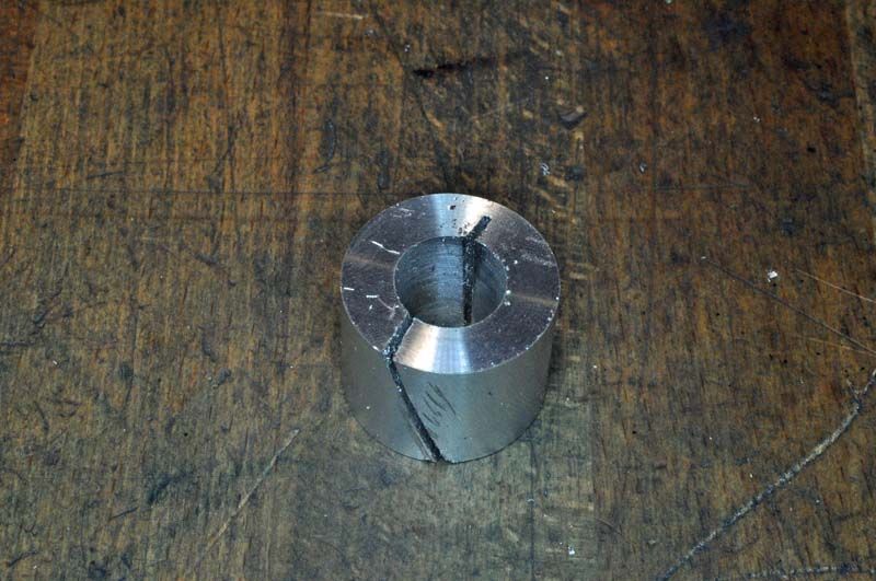

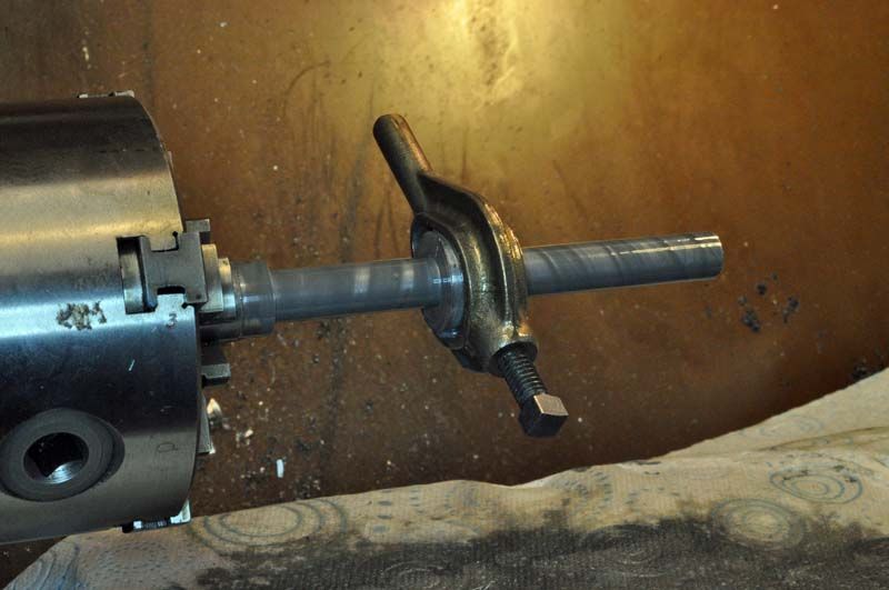

                I used a lump of ally drilled to the nominal journal diameter and then split:
                The lathe carrier screw can compress the lap as necessary as you proceed (a technique devised by Duplex many years ago). s5.jpg
                I used 400 and then 600 SiC grit, sourced from the internet, mixed with a little light oil.
