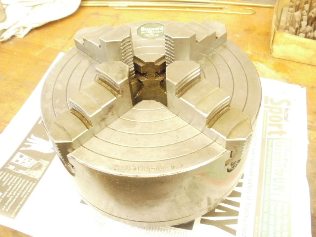

      I have a 10" 4 jaw independant chuck with L00 mount for a Colchester student lathe ( circa 1968). It's not rusted solid just very tight, I have it in a bucket of diesal to free it off.
      There is surface rust to it, what are your thoughts on bead blasting it to clean it up (shiny ?)
      Regards Ian

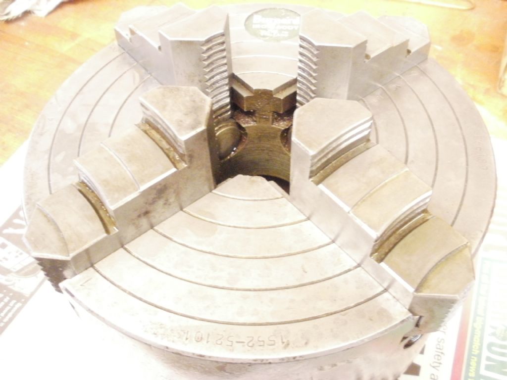

                              #86453
                              ianj
                                @ians
                                Hi All.
                                See photos for end result. It was easier than I thought it would be. I used scotchbrite pads & oil for most of it, for the more badley rusted sections ( it had been stored on its side on a damp floor) I used the pads soaked in brick cleaner & then pads & oil. I think the end result is well worth a couple of afternoons work .
                                PS. Its actually a 8" four jaw chuck.

                                      Ian you have done a great looking job of cleaning the chuck.
                                      However you say you have used "Brick Cleaner". What have you used precisel? As I recall the majority of proprietary brick cleaners contain 10% to 30% Hydrochloric Acid! This is not only dangerous stuff but is highly corrosive. How have you neutralised the acid after cleaning? You need to check that you do not develop a case of "high speed rusting". HTH.
                                      #86720
                                      ianj
                                        @ians
                                        HTH.
                                        Yes your dead right, it starts rusting more or less as soon as you rince it under running water. I gave it a good soaking in a solution of baking soda & then washed it using a strong detergent containing bleach.And then a good oiling.
                                        I should have mentioned that I used rubber gloves & eyeshields & did the intial cleaning out side because of the fumes
