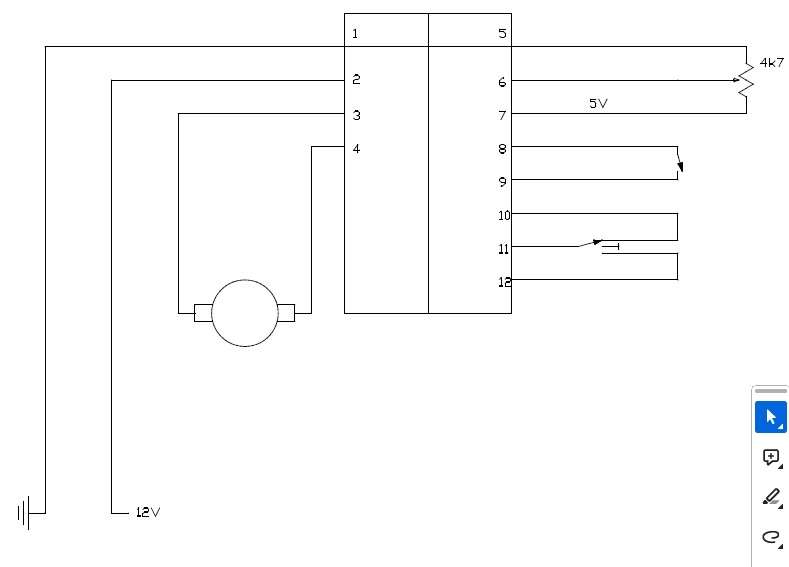

      I started a thread on this some time ago, but I can’t find it, so had to start a new one. I’m hoping the combined wisdom of you lot will help me releasing the expensive magic smoke.
      To recap, I’m using 2 ebay motor controllers to power 2 motors on my latest creation. Why? They were cheap. The way you would wire one up is shown below
      schematic1
      When I put my multimeter across the pot it reads ~1k at first, but this rapidly climbs to 4K7 and then stays there. I assume this is due to a cap somewhere. Obviously I want to control it using one potentiometer, the forward/off/reverse (pins 10,11, 12) is going to be by 2 pole 3 way rotary switch, so can be kept apart. The switch shown between pins 8&9 is built into the pot, as the motor can be firmly off by putting the the forward/off/reverse to off, so I’m proposing to permanently connect pins 8&9. Pin 5 seems to be connected internally to pin 1. Pin 7 has 5v on it. What I’m not sure about is:
      should I connect pins 5 together on the 2 controllers?
      Should I connect pins 7 likewise. I’m concerned that if the 5v regulators in the 2 controllers are not exactly matched they could fight each other

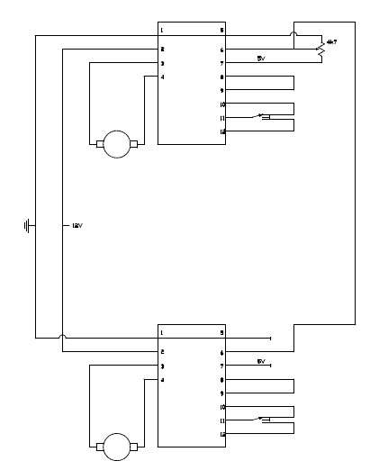

      I’m proposing N/O push button between the +5 and the pot to act as a deadman. Let go and it cuts the power.

      Robert Atkinson 2
        @robertatkinson2
        Your diagram is correct. They may be a slight mismatch between the outputs but the motors won’t be identical either.
        Another option is two potentiometers one for each controller. This can be either a dual gang pot e.g. https://uk.farnell.com/citec-te-connectivity/27esa472mmf50nf/res-4k7-0-4w-1-turn-panel/dp/3399766
        Make sure you get a LINEAR pot. Most dual pots are Logarithmic also called “audio taper”.
        Or it could be two single pots mechanically ganged together. This can be arranged to allow balancing between the two motor systems. You could allow the body of one pot to be rotaed over a small range if using gears or timing belts to connect them or variable length levers if using a lever system.
        Robert.

                      Well that didn’t work too well. I used automotive 20A fuses which immediately blew when I connected it up, presumably on inrush current. I then replaced the battery with a transformer rectifier driven from a variac so I could ramp up the volts. The motor at the top in my diagram worked fine, but the one at the bottom just runs full speed. I’m now pondering either getting a twin gang pot, or biting the bullet and buying a 4QD. I must admit the second option is tempting, just wire and go

                        John Doe 2
                          @johndoe2
                          I don’t know anything about the controllers in question, but you have tapped the slider voltage from the top controller potentiometer to drive the second controller, and you have removed the second controller’s pot completely. The second controller might, however, need to “see” a complete potentiometer connected, without which it might get confused and could be why it is commanding full revs.
                          You might try putting a 4k7 resistor between pins 5 and 7 in place of the potentiometer track.
                          If that fails, you will have to use a dual-gang potentiometer – one gang per controller – as I think Robert suggested.
                              As the circuit looks good to me, I suggest something is wrong with the wiring.   A photo would help.
                              That the second unit runs it’s motor flat out suggests either that it’s being fed 5V from the pot (pin 7) when it should be connected to the wiper (pin 6), OR, that its controller is faulty.
                              One unlikely possibility is that pin 5 is not ground.  Try connecting both pin 5s together.
                              For debugging, I’d disconnect the parallel wiring and start by testing the two controllers independently.    Prove both controllers and motors work as singletons.
                              Then disconnect the pot from controller two, as per diagram, and see if the pot wiper (6), will control both motors.
                              Why is nothing ever easy?  Should be straightforward!
